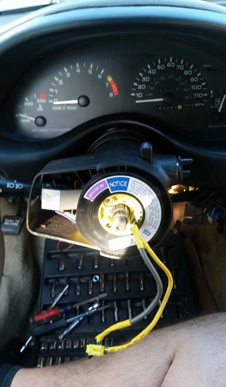

tonytoca_87 Posted June 18, 2016 Author Report Posted June 18, 2016 After I removed the airbag and steering wheel Quote
Imp558 Posted June 18, 2016 Report Posted June 18, 2016 (edited) That thing pulls off and you need the lock ring compressor for what's beneath, and a couple tiny screwdrivers or picks to pull the snapring after you push the ring down. set a few Rags on the dashboard and lay the pieces in order across the dash with the outside facing up and you'll be fine during reassembly EDIT: That airbag wire roller thing will kind of hang there by the wire so be careful. Edited June 18, 2016 by Imp558 tonytoca_87 1 Quote
GabsOlds Posted June 18, 2016 Report Posted June 18, 2016 After I removed the airbag and steering wheel Use some duct tape to keep the inner part of the clock spring from unwinding, then pull it out. tonytoca_87, Imp558 and rich_e777 3 Quote
tonytoca_87 Posted June 18, 2016 Author Report Posted June 18, 2016 That thing pulls off and you need the lock ring compressor for what's beneath, and a couple tiny screwdrivers or picks to pull the snapring after you push the ring down. set a few Rags on the dashboard and lay the pieces in order across the dash with the outside facing up and you'll be fine during reassembly EDIT: That airbag wire roller thing will kind of hang there by the wire so be careful. Thanks bud. I was starring at the Damn thing confused lol. I don't think I'm going to attempt this job just to the simple fact that I don't have the proper tools. I already have the puller but don't have the lock ring compressor. Quote

Imp558 Posted June 19, 2016 Report Posted June 19, 2016 That's not a snap ring, it's like a hog ring. 2 tiny screwdrivers or similar. tonytoca_87 1 Quote
