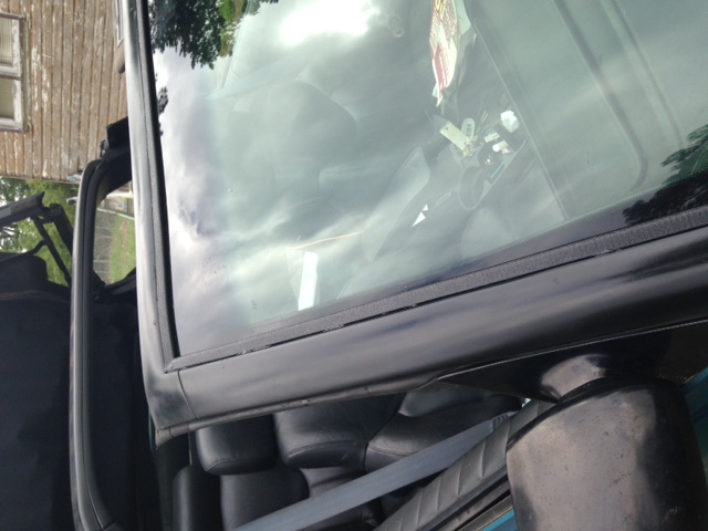

Afubar Posted August 12, 2015 Report Posted August 12, 2015 Well, since I couldn't find any windshield lace for the 93 vert, went on line and searched for a way to refurbish it. Found where someone suggested soaking in transmission stop leak (I used AT-205 Re-Seal from atp automotive) to restore worn or dried out rubber seals and figured what the heck. Got nothing to lose. Here's a shot of before (I also repainted the pillars while I was at it: Let the trim soak about 4 days, then once pillars where painted and dry, reinstalled trim. So maybe there is still hope for that dried out windshield lace. Will let you know how long the treatment last. Anything is better than before. I did have to trim the lace when I put it back on as it did stretch a bit. Kaye oldsl67 and cdn_olds_94 2 Quote

Afubar Posted April 1, 2016 Author Report Posted April 1, 2016 Sorry guys, I've been out the country for the last 2 weeks. The lace is holding up well though in retrospect I wouldn't have let the lace soak for 4 days as it did stretch a bit and once it was put back on it did shrink back a bit. Still looks better than it did and the paint job has held up well. Right now the car is covered in pollen and the weather is getting ready to storm so when I get the car washed I'll post an update in the next few days. MemphisMan and Heartbeat1991 2 Quote

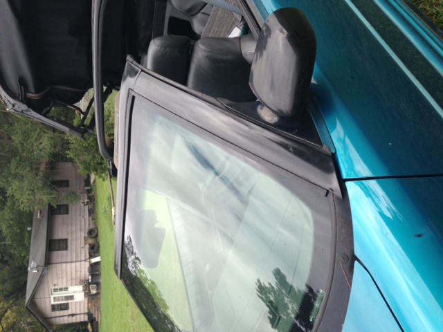

Afubar Posted September 24, 2016 Author Report Posted September 24, 2016 Well, I have an update on the windshield lace, it dried out again. I finally removed it and yesterday replaced it with some stuff I found on Amazon. Trim-Lok Edge Trim PVC/Aluminum with Textured Black Finish, Single Gripping Finger, 9/16 inch, Height 1/8 inch, Length 25 feet by Trim-lok Used black weather stripping adhesive by 3M to apply. Now to play waiting game to see how it holds up. Sorry that the iphone photos are sideways. Imp558 and rich_e777 2 Quote
GabsOlds Posted September 24, 2016 Report Posted September 24, 2016 Thanks for the update. It seems 22 year old rubber cannot be renewed. The new stuff you have on there looks good! Congratulations. Quote
