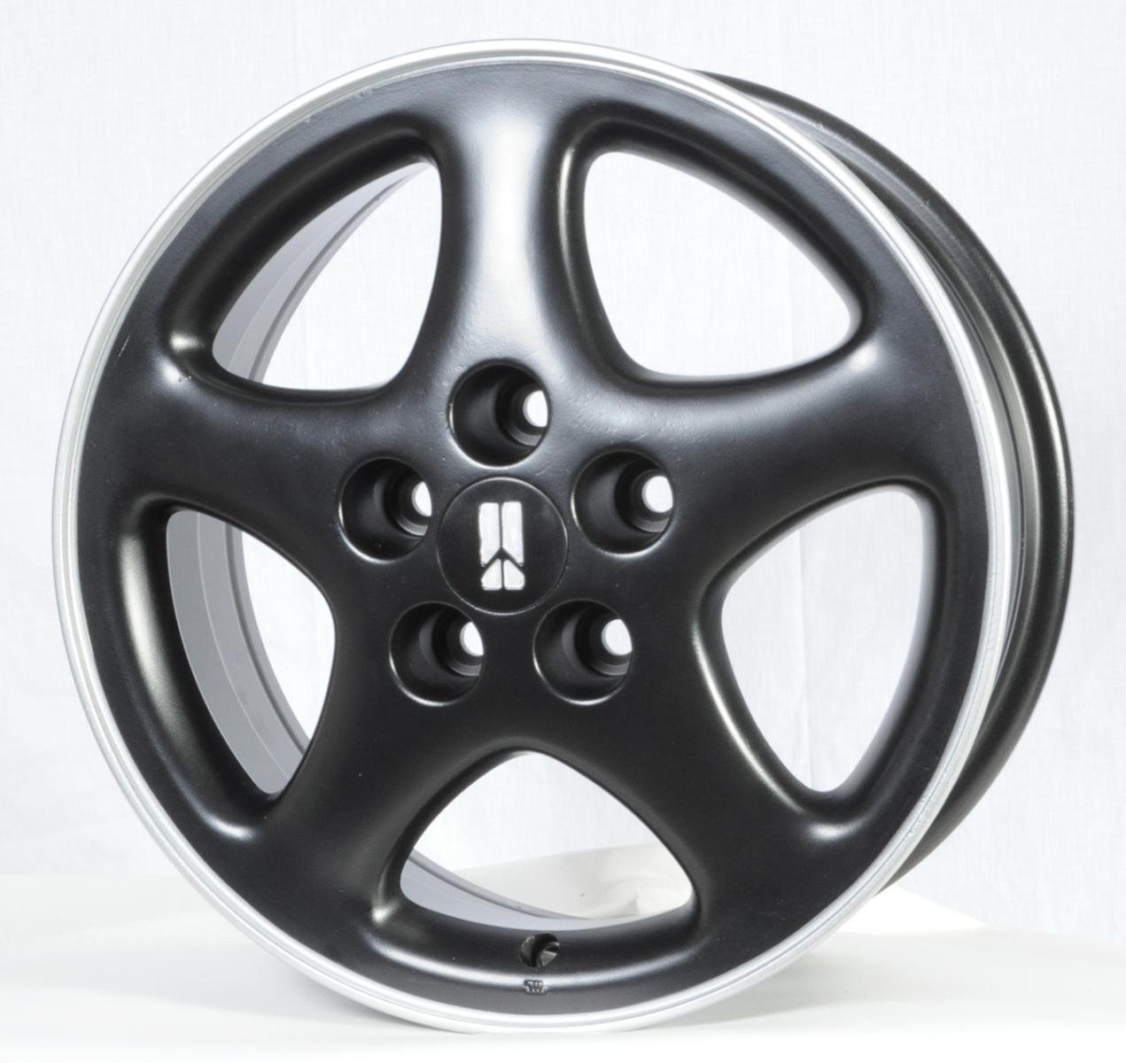

Hello, I know my stock tire size for these 5 Spoke Olds Wheels is 225/60R/16 but has anybody put anything wider on these wheels without them rubbing? I need as much rubber on the ground as I can get because of the L67 Motor. Had these wheels powder coated to go on the Black 95 Vert.
they're 6.5" wide, I've seen other 1st gens with stock 6.5" wheels get by with 245s on them, but I don't know if there was any scrub with the wheel at either lock.
