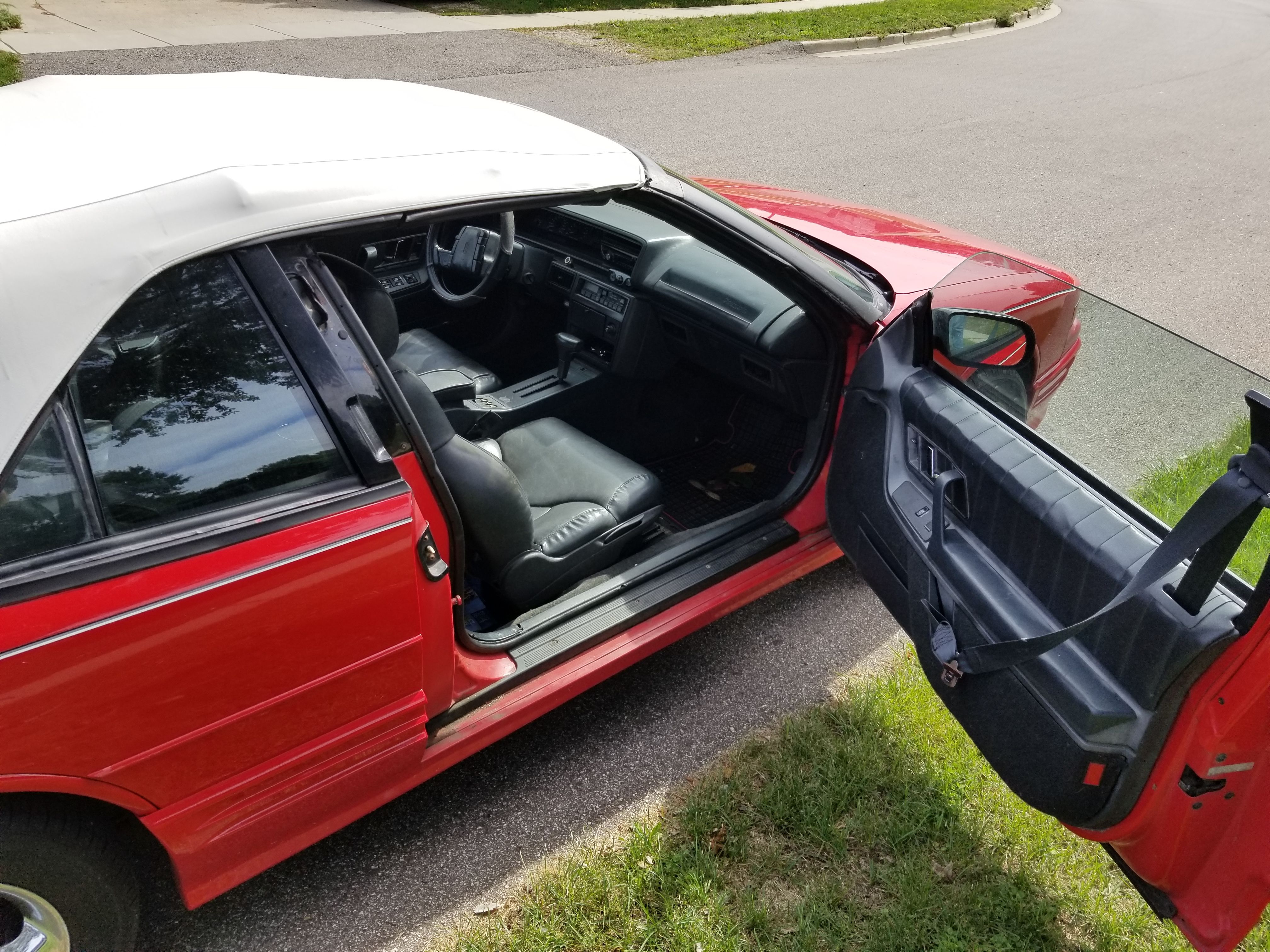

I had a top put on my 93 and it is definitely too small it doesn't even cover the top framing let alone go over the windows. But my installer said he was told they only make one size so he was misled and I have a top that doesn't fit right. I'll need to modify it to cover the frame and windows , maybe duct tape?

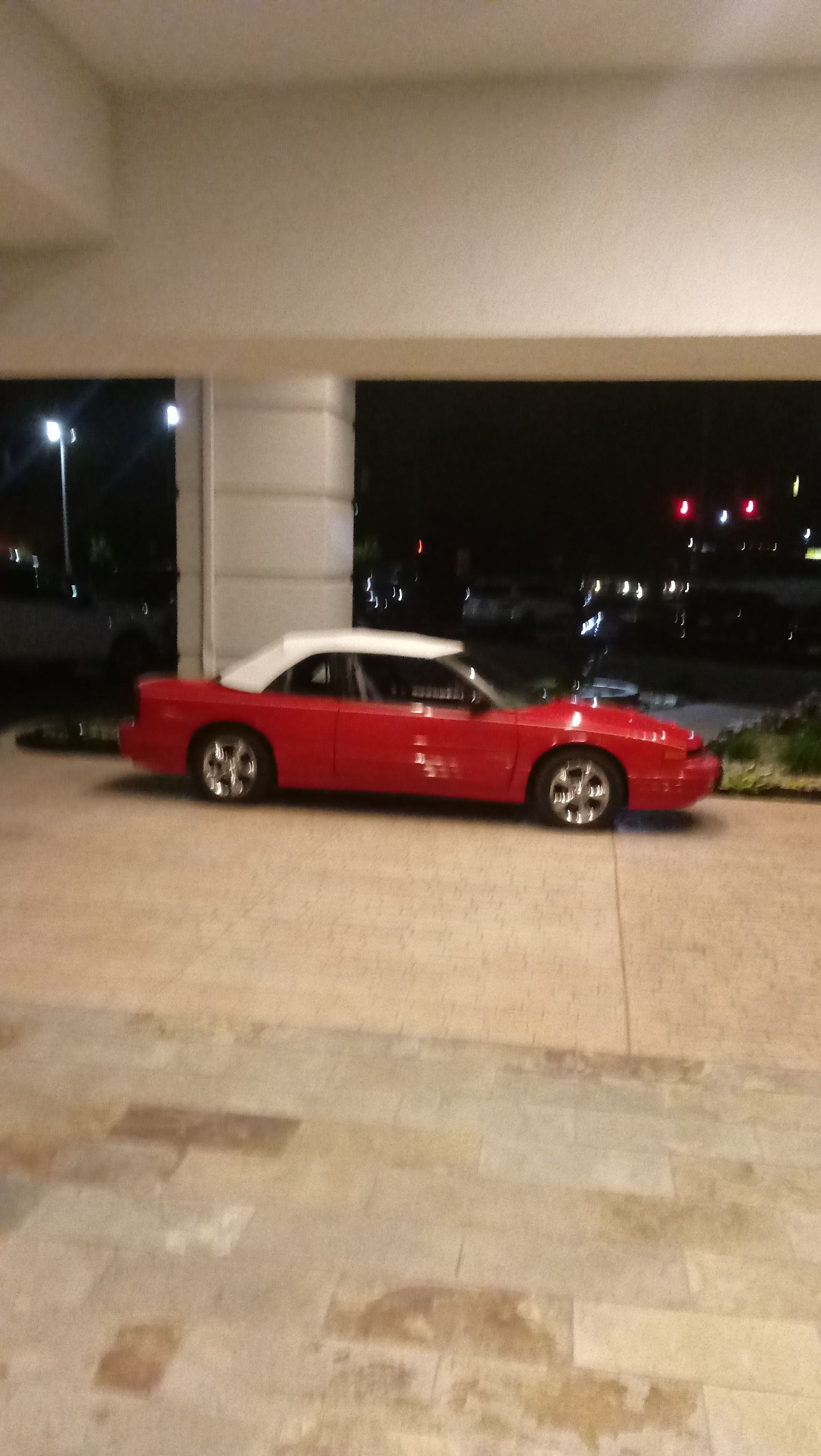

Your top looks like mine did on my 95 after I replaced it.  I think it's ok, are you leaving it out in the rain for a long time?  In the winter months when I wasn't lowering the top, I tried covering the gap between the two rubber pieces with black duct tape.   It helped somewhat to keep out the rain, but then in the summer when I took off the tape then it left a white residue from the adhesive, so I don't recommend it.
I think your car looks great!    And when the top is down, it doesn't matter anyway!
