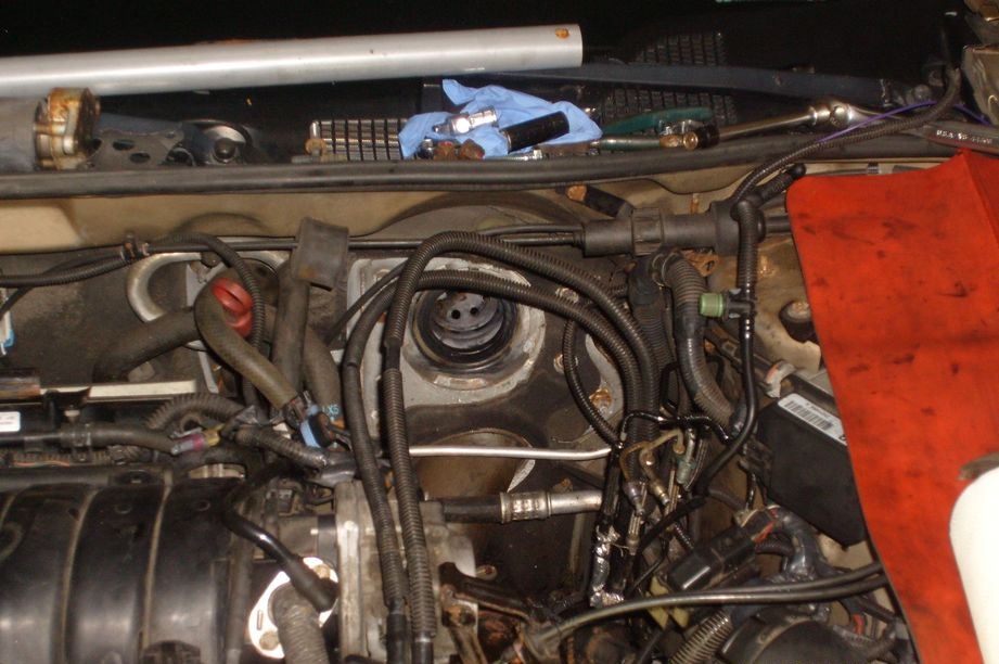

Old Booster removed, ABS removed, EGR valve removed:

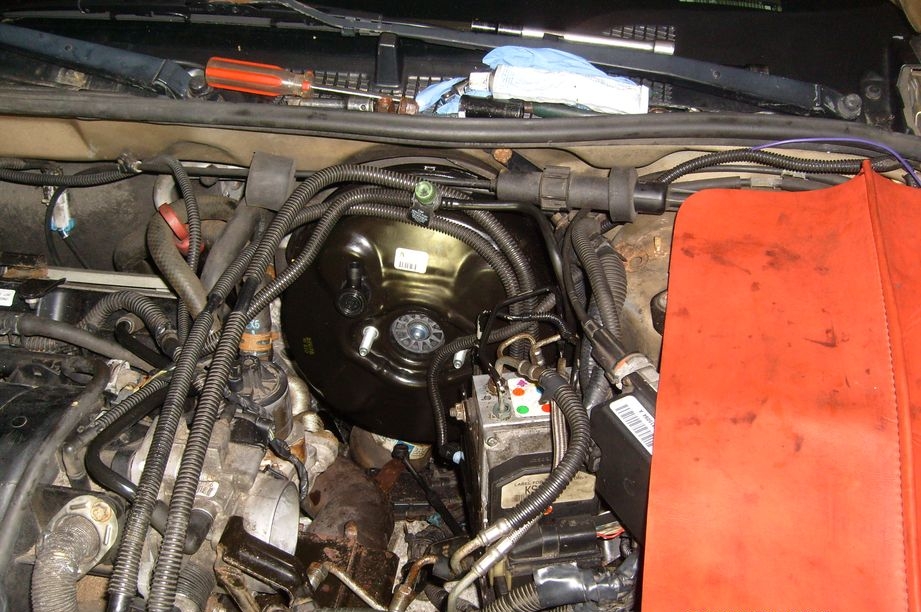

New Booster, ABS (right), EGR valve(left) installed:

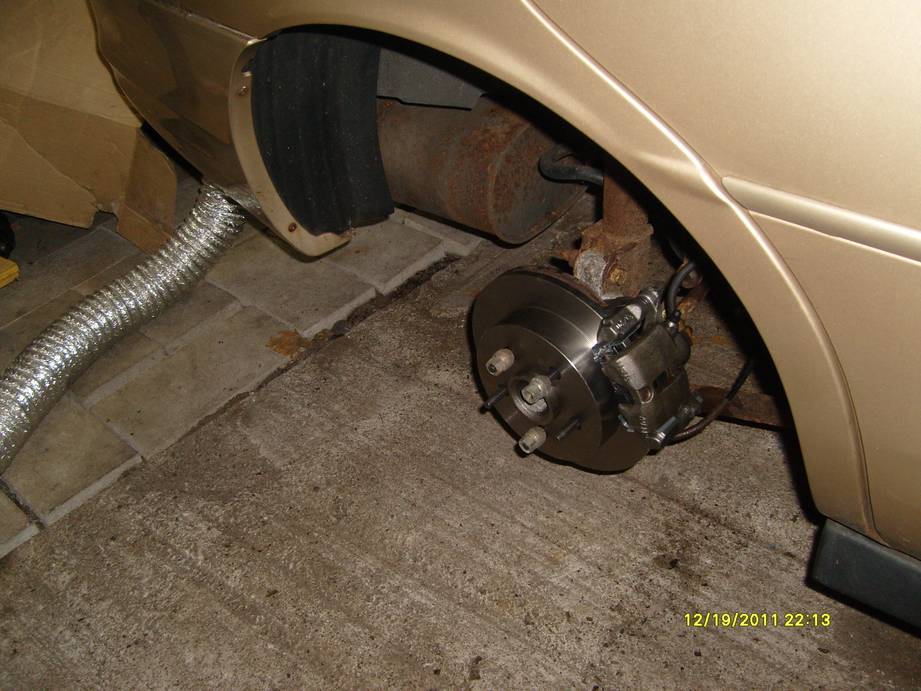

Below is a picture of the rear of my Intrigue, showing one of the new calipers, new hubs, new pads, new rotors, new hoses, etc.
You can see how huge the inside hub portion is. That's because the inside is also an "old fashion" drum/shoe setup for the ebrake.
