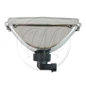

Mel87 Posted September 13, 2011 Author Report Posted September 13, 2011 Here is the 2 headlamps. Old on the left, new on the right. Here is the bulb I broke out of the old one. Notice the greyish rubber thing (as I thought was a sealer) then look deeper inside and you can see where the bulb was glued... makes no sense. Quote

GP1138 Posted September 13, 2011 Report Posted September 13, 2011 idk why gm did that. as how they were made it wouldnt have been hard to make the bulb replaceable. but then again its gm do you have to ask lol Probably to simplify replacement, so people did not have to handle the sensitive glass bulb and fiddle with it. As designed you have to take the housing out anyway, might as well make it a one-step process. Quote
Mel87 Posted September 13, 2011 Author Report Posted September 13, 2011 Probably to simplify replacement, so people did not have to handle the sensitive glass bulb and fiddle with it. As designed you have to take the housing out anyway, might as well make it a one-step process. I can kind of see the good in that. For example, the old headlamp had pits and little dings in them from rocks I guess that won't come off, and new one doesn't (duh) but that is the only pro I see of having to buy a whole new headlamp versus a new bulb. Quote
