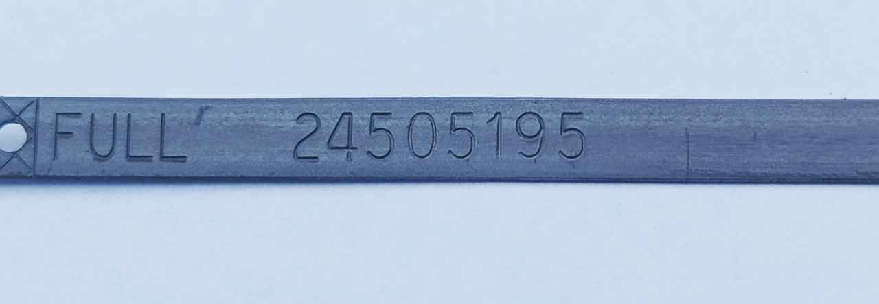

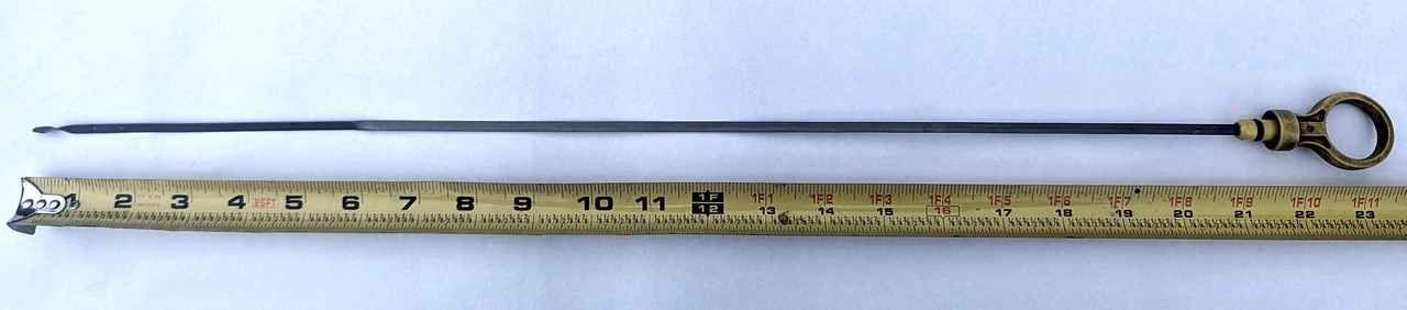

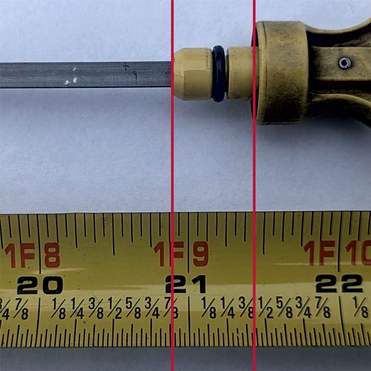

kcac Posted August 5 Report Posted August 5 Do I have the correct dipstick for a 1995 Oldsmobile Cutlass Supreme with the 3.4l DOHC engine? Photos below. The owner's manual states 5.5 quarts of oil when doing an oil and filter change. I change the oil and filter, run the engine for a few minutes, let it sit for about 5 or 10 minutes, then check the dipstick and it shows the oil between the high and low marks. Quote
Raffaelli Posted August 5 Report Posted August 5 That’s the correct dipstick for my 94 z34. Same one I ordered by vin from the dealer. When I change the oil it takes 6qts on the money. Quote
kcac Posted August 12 Author Report Posted August 12 On 8/5/2026 at 1:16 PM, Raffaelli said: When I change the oil it takes 6qts on the money. Thanks fir confirming this, because I always noticed the same thing. Quote
hazelspindle3 Posted October 3 Report Posted October 3 Raffaelli said: That’s the correct dipstick for my 94 z34. Same one I ordered by vin from the dealer. When I change the oil it takes 6qts on the money. Mine lands around 6 with a filter too, so the 5.5 in the manual has always felt a little optimistic. Between the marks after 5.5 isn't a bad place to be though. Quote
