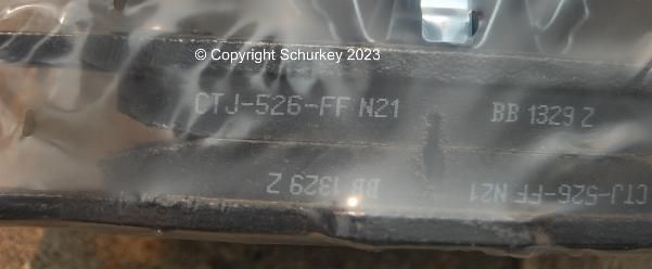

Schurkey Posted January 16, 2025 Report Posted January 16, 2025 Permanent magnet gear reduction (PMGR) "Mini starter" works great on my Euro 3.4Ls. Lotsa guys seem to think the later rear calipers are an upgrade; I disagree but I'm in the minority. About the same for front struts/brake rotors. Yeah, the later struts allow slightly-larger-diameter rotors which has the potential for increased braking power...but the REAL problem with braking power is the vacuum booster used on first-gens. Once the booster is replaced with one that works properly, and the brake fluid is flushed every two years or at least every time pads get replaced, the brake problems are pretty-much done. Rebuilding calipers is relatively easy, and often successful at restoring proper operation. The 2-piston calipers are harder than the single-piston calipers, and aluminum calipers often need to have the corrosion dug out of the seal grooves, or the pistons are "stiff" because the rubber seal is overly-compressed. I like the idea of scrapping the CS130 alternator used on '93--older (?) engines in favor of the CS130D used on newer engines--but in the case of the 3.4L, anyway, it takes an entirely-new front accessory drive mount. I haven't done this on my cars. Quote
