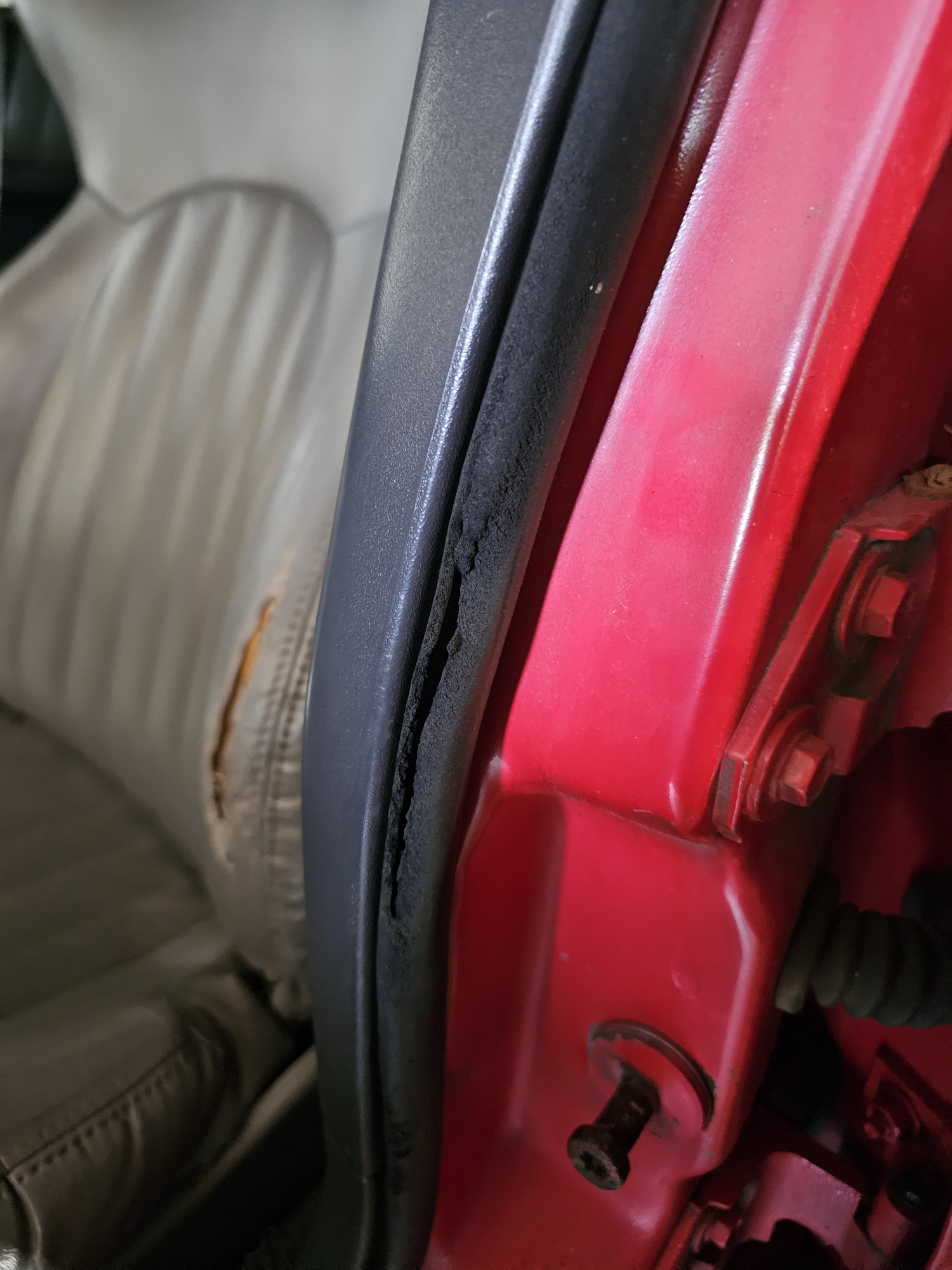

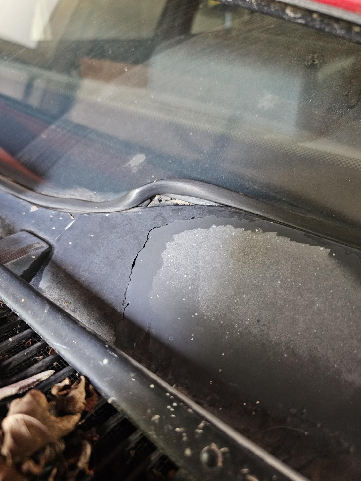

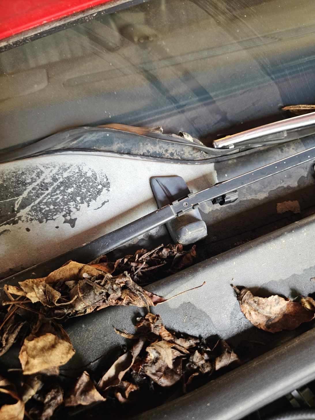

SuperBuick Posted June 19, 2024 Report Posted June 19, 2024 (edited) Hi all - ive done a bunch of searching but cant seem to find this information for sedans, only coupes. does anyone have part information for the body/door seal weatherstrip for 91-93 grand prix sedans? Also - the windshield bottom weatherstrip that always goes bad on these cars - I saw some old info on a “solution” but the links dont work. Is there a current or suggested fix for that issue? And if anyone has any good used spares or new old stock - I am a willing and active buyer currently. thank you Edited June 19, 2024 by SuperBuick Quote
Go4DaMo Posted June 19, 2024 Report Posted June 19, 2024 Home Depot or Lowes sells 2 sizes of boat/marine weather stripping in rolls that I recommend looking into to replace your door seals. Quote
jiggity76 Posted June 19, 2024 Report Posted June 19, 2024 (edited) 11 hours ago, SuperBuick said: Hi all - ive done a bunch of searching but cant seem to find this information for sedans, only coupes. does anyone have part information for the body/door seal weatherstrip for 91-93 grand prix sedans? Also - the windshield bottom weatherstrip that always goes bad on these cars - I saw some old info on a “solution” but the links dont work. Is there a current or suggested fix for that issue? And if anyone has any good used spares or new old stock - I am a willing and active buyer currently. thank you Both of those pieces aren't available anymore NOS. A parts car or junkyard run will be your best bet. I actually found my pieces that way. For the door weather seal, it's part #10283235. For the windshield cowl base, that rubber piece is apart of that metal base where the wipers rest. That part # is 10122028. I actually have the door seal but I need it for my STE. Sorry, I think I might have got the last NOS one. I bought it 6 years ago or so. Possibly...a Lumina/Regal/Cutlass sedan might be the same? I don't know for sure though. Also, a local glass shop might have the rubber piece in stock or could order it for the windshield base. I'm going to the junkyard soon and If I find a good one...either one of those parts, I'll grab them for ya. Edited June 19, 2024 by jiggity76 rich_e777 1 Quote

rich_e777 Posted 2 hours ago Report Posted 2 hours ago On 6/19/2024 at 8:49 AM, jiggity76 said: For the windshield cowl base, that rubber piece is apart of that metal base where the wipers rest. That part # is 10122028. If you can recall, did that rubber NOS piece have that molded dip in it or is the rubber pliable enough to make those curves? I`m looking to replace this on 3 cars and it looks like the same between 1st gen W sedans and coupes/verts. Quote
jiggity76 Posted 1 hour ago Report Posted 1 hour ago (edited) 4 minutes ago, rich_e777 said: If you can recall, did that rubber NOS piece have that molded dip in it or is the rubber pliable enough to make those curves? I`m looking to replace this on 3 cars and it looks like the same between 1st gen W sedans and coupes/verts. I believe it has that dip or channel in it so that it locks to the metal base and follows it's curves. Edited 1 hour ago by jiggity76 Quote
