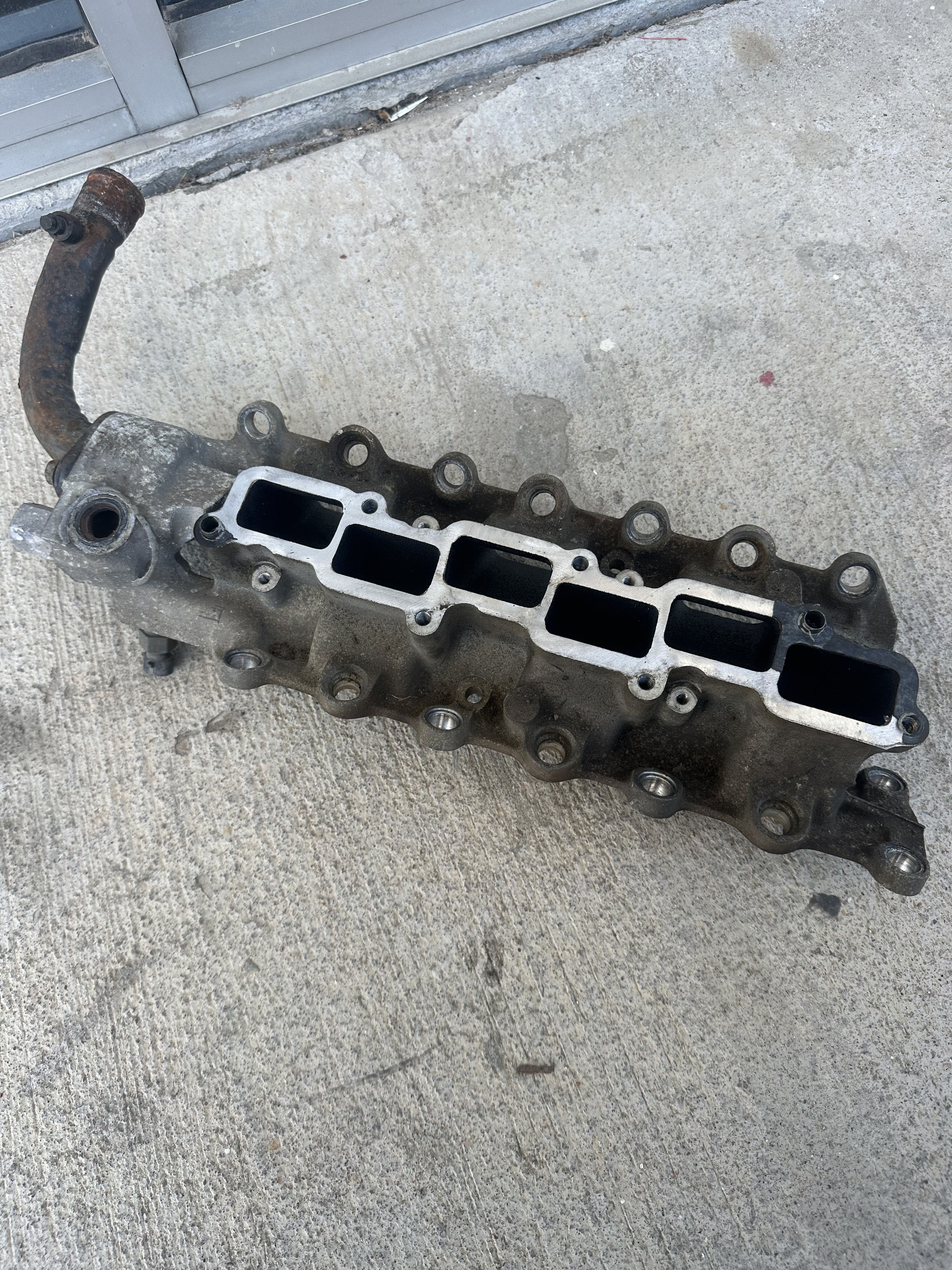

Raffaelli Posted April 5, 2024 Report Posted April 5, 2024 1994 Lumina Z34. I have the upper and lower intake off, and remember reading the later year manifolds made more power. Worth the effort? There used to be a write up on another website, but the page is broken. Insights? Quote

55trucker Posted April 6, 2024 Report Posted April 6, 2024 Each of the intake manifolds design is unique to the upper plenum assembly. If one wants to swap the intake manifold to or from the earlier design then one must also swap the upper plenum assembly. 94 olds vert, Raffaelli and jiggity76 3 Quote
White93z34 Posted April 7, 2024 Report Posted April 7, 2024 Supposedly you can gain a bit of power on the top end due to the intake being better designed. The downside is its a major pain in the ass to pull off properly, and even then it doesn't really fit the earlier engines well. not worth the trouble in my opinion. Psych0matt and Raffaelli 2 Quote
