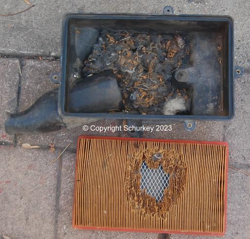

This is my second W-body to have squatters in the air cleaner.  Found essentially the same thing on my '98 Monte Carlo a couple years ago.  This time it's a '92 Lumina Euro 3.4
I'm pleased that the metal mesh on the filter kept 'em out of the throttle body.
A replacement air filter is now nearly twenty dollars.  Thank you SO MUCH, Senile Joe.  Your economic policies are working wonderfully.

Those are some crafty little bastards, I caught one in a glue trap inside a locked Firebird. No idea how it got in there. I wonder if you could scavenge that mesh off the eaten filter to put around the end of the intake to keep them from getting to the next one?

I can't say I've ever experienced that one.
I think I have a stack of air filters I got on closeout from rockauto years ago, with how little I drive my z34 now should be a lifetime supply.
You could get a piece of expanded metal, chicken wire or some sort of metal mesh and put it over the opening. Or hell even liberate the metal screen from your destroyed air filter and cut it to fit over the opening on the airbox
