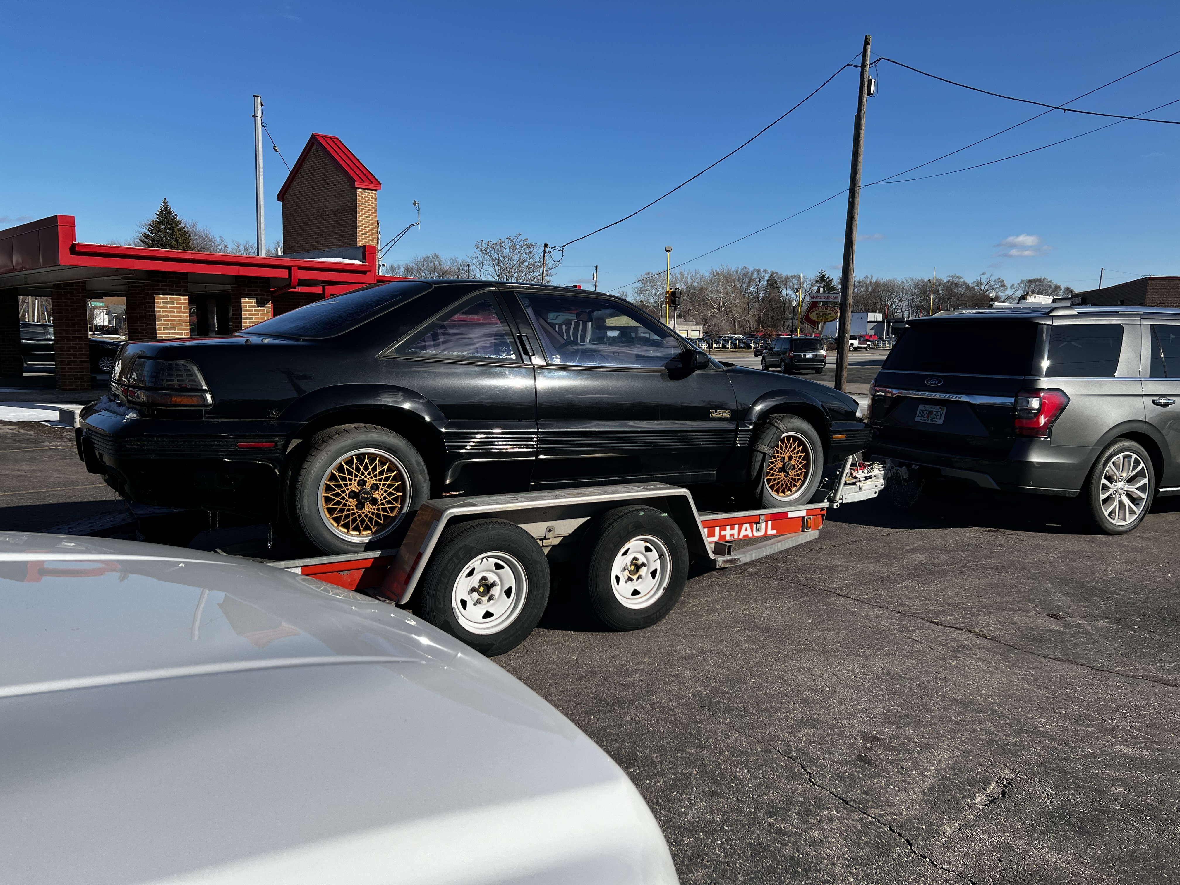

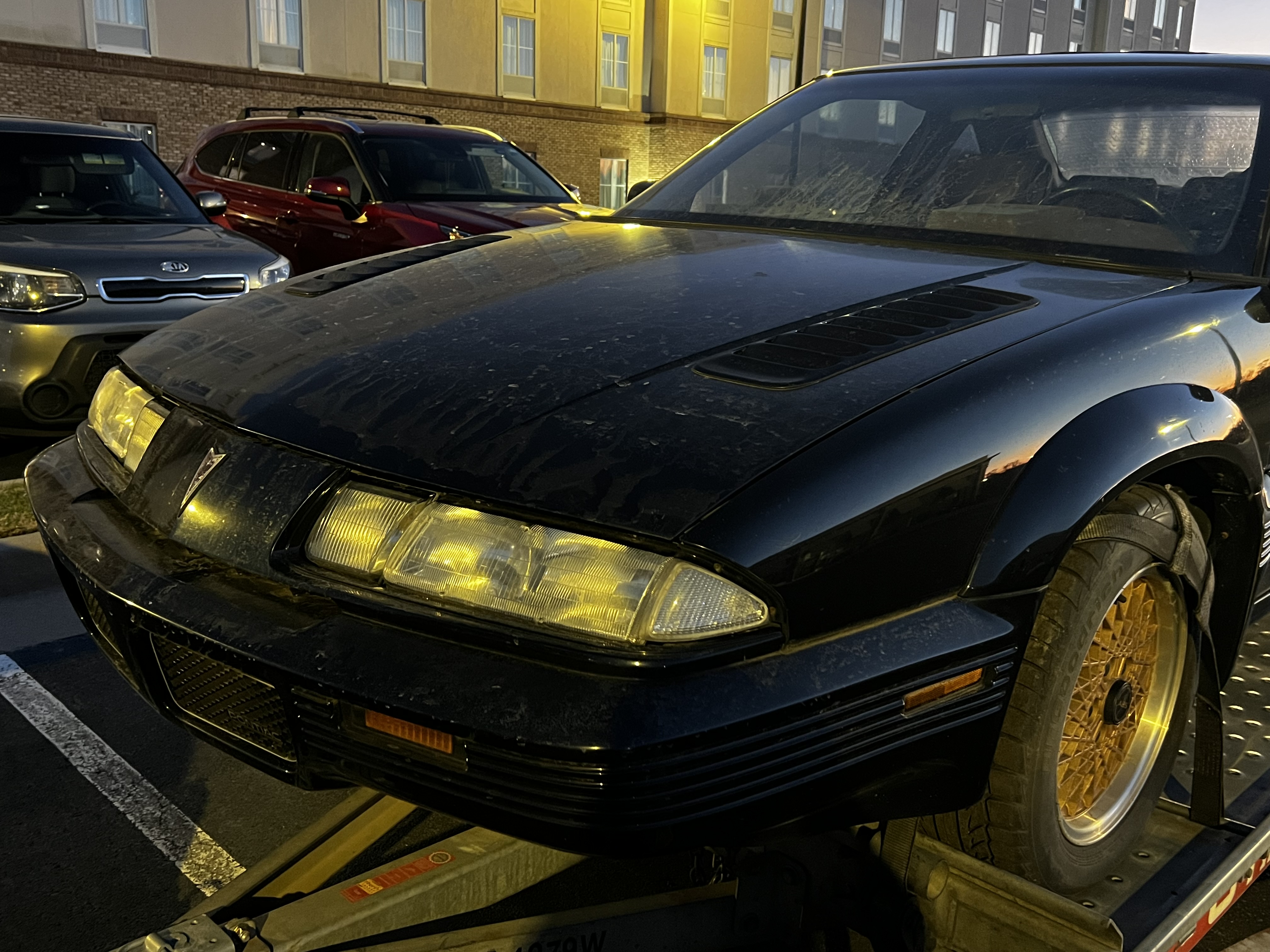

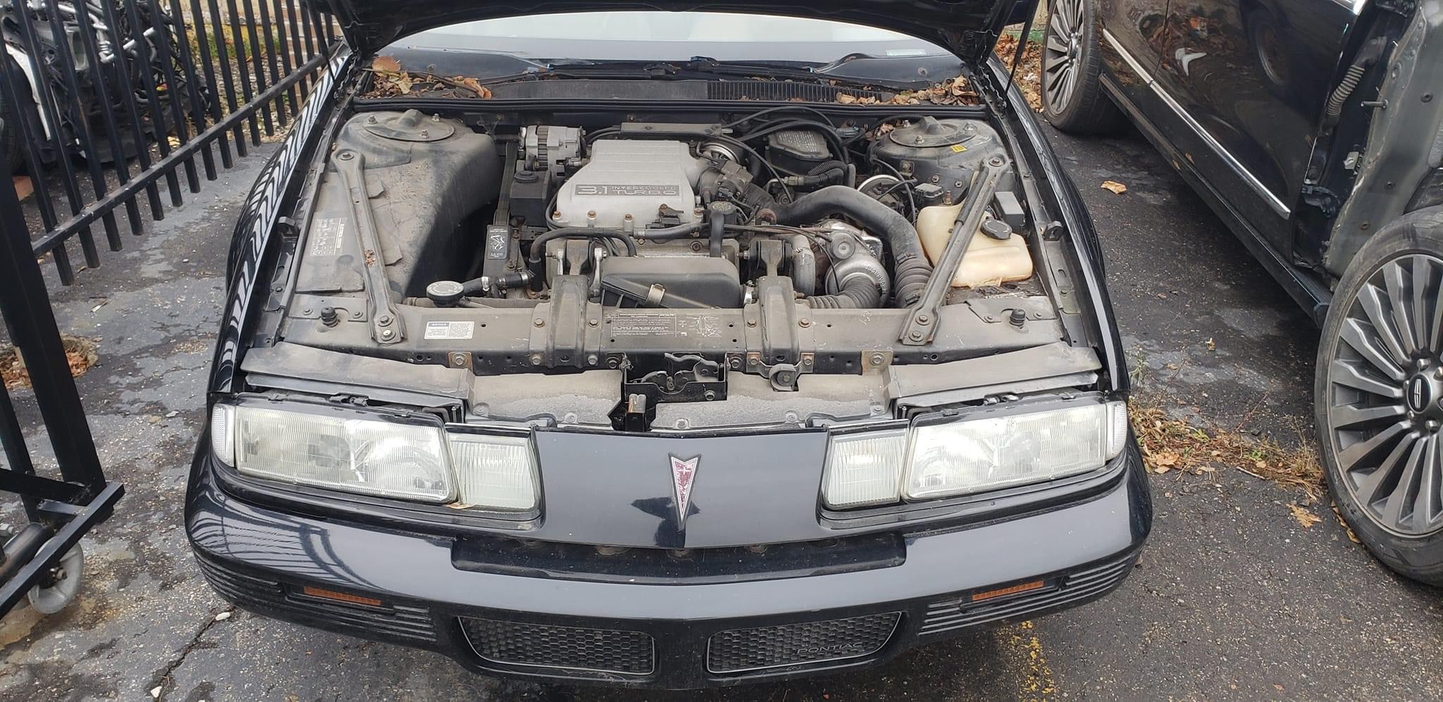

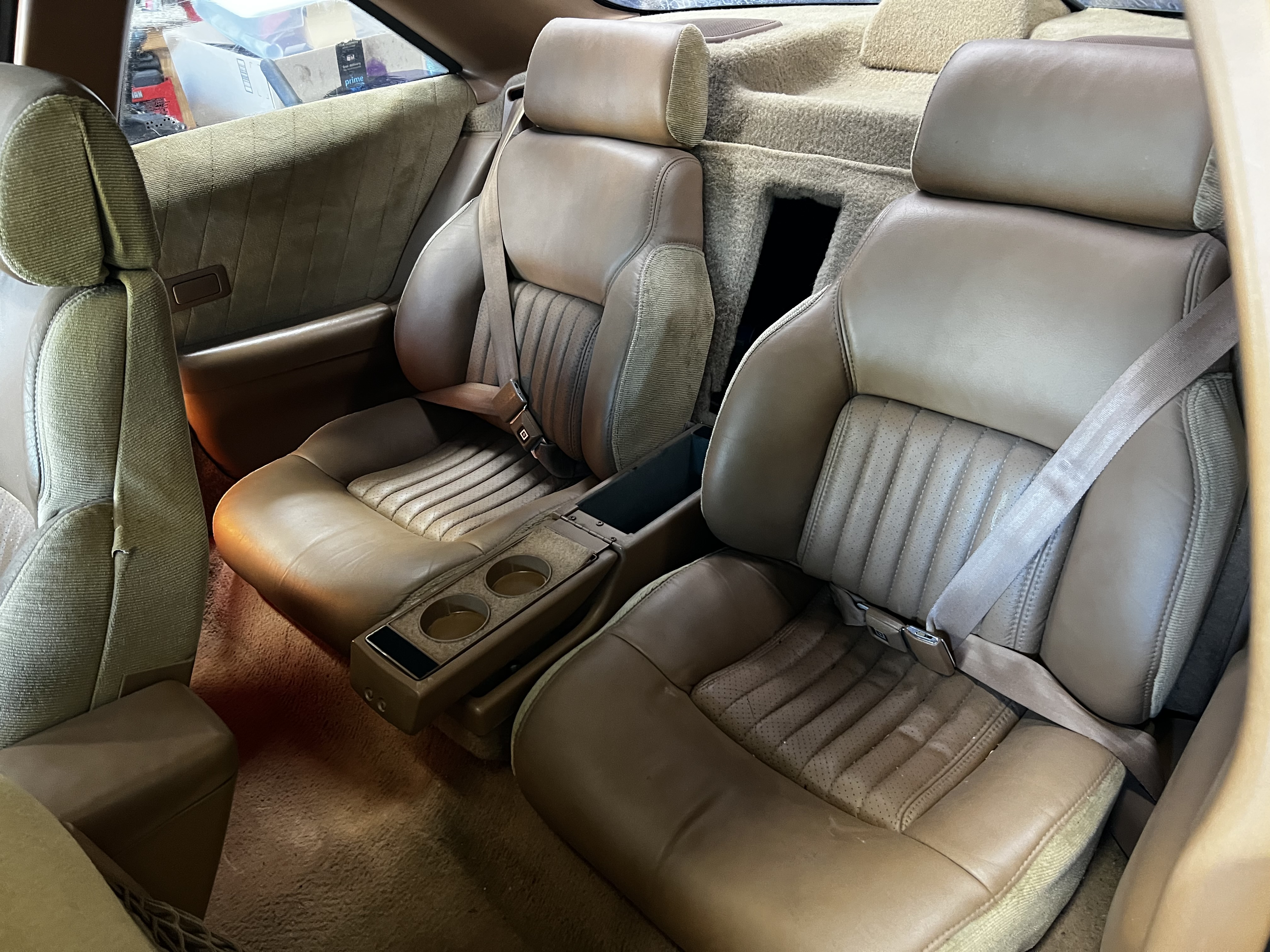

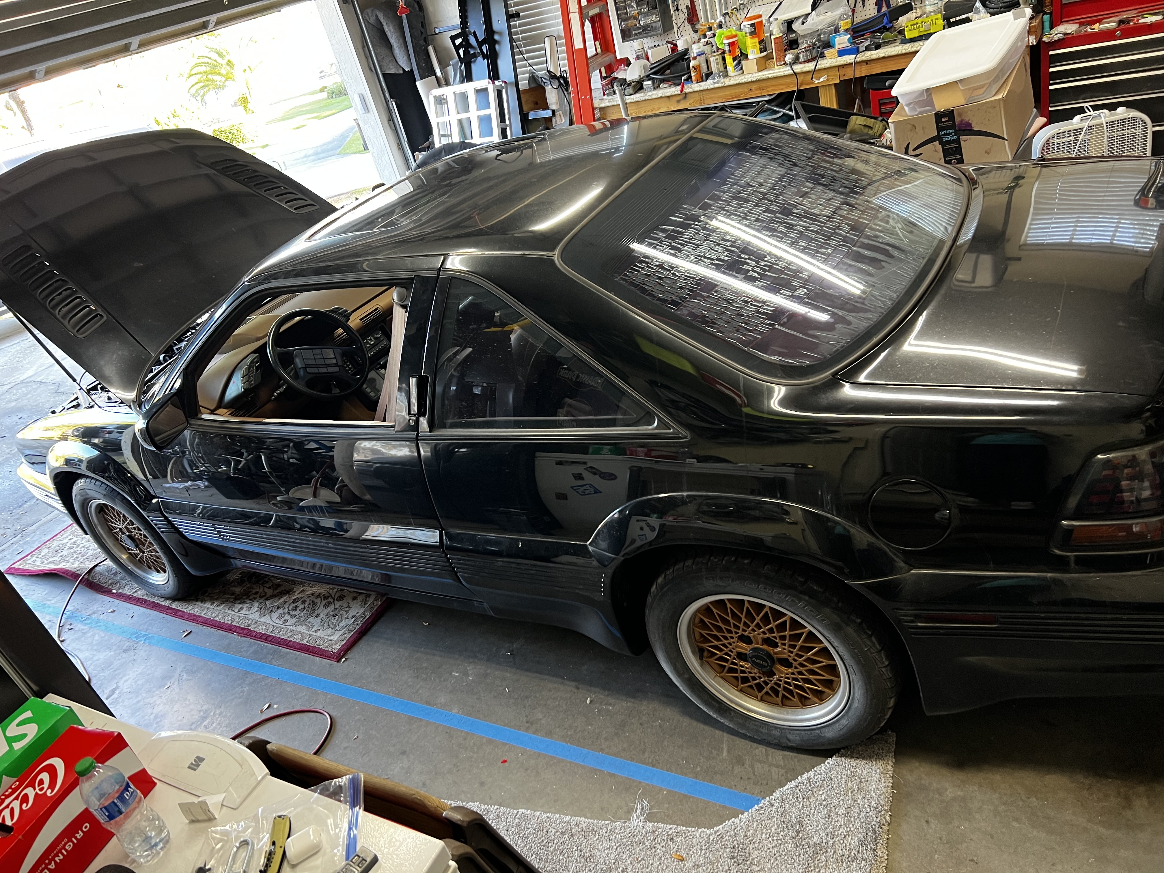

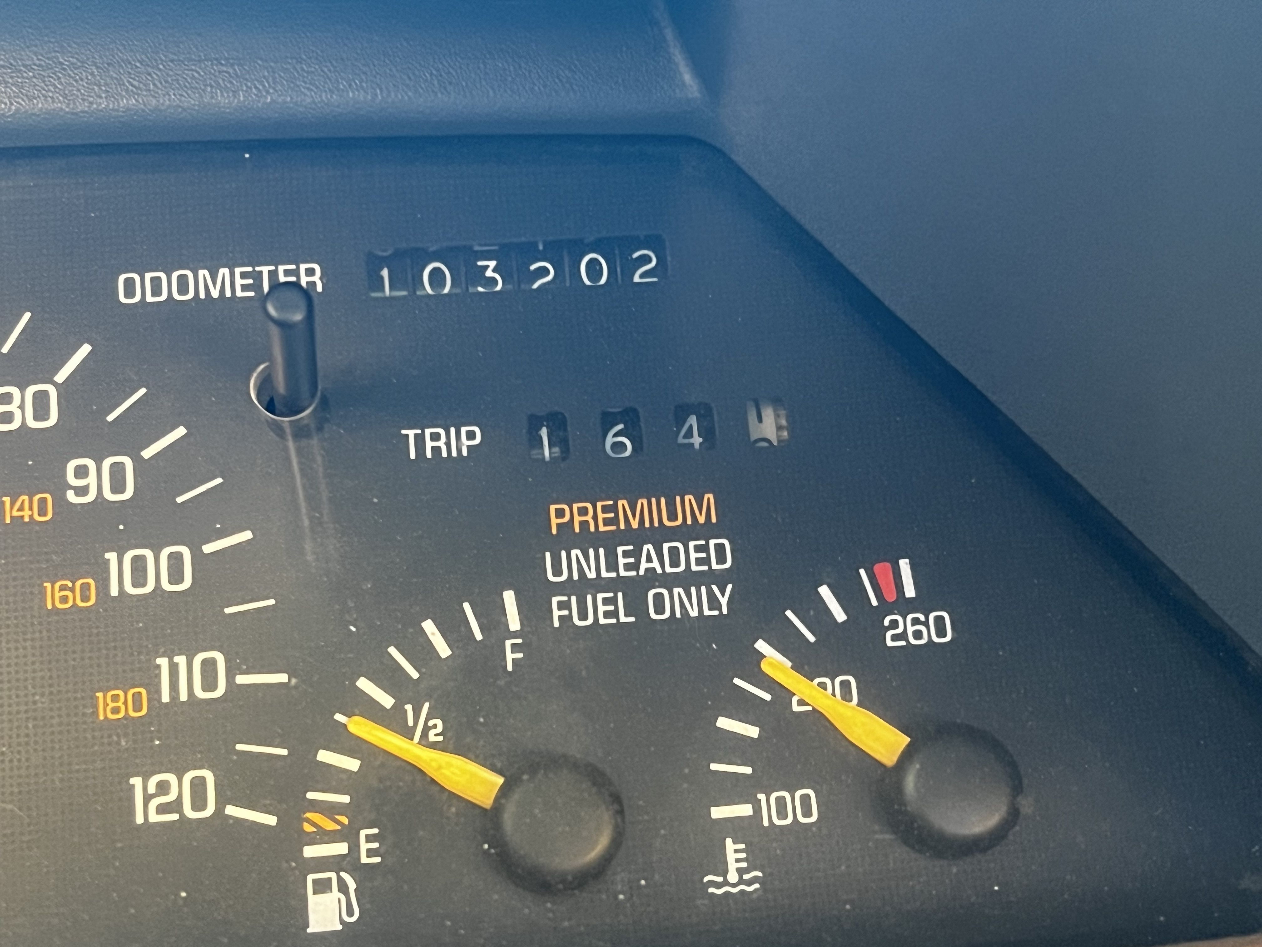

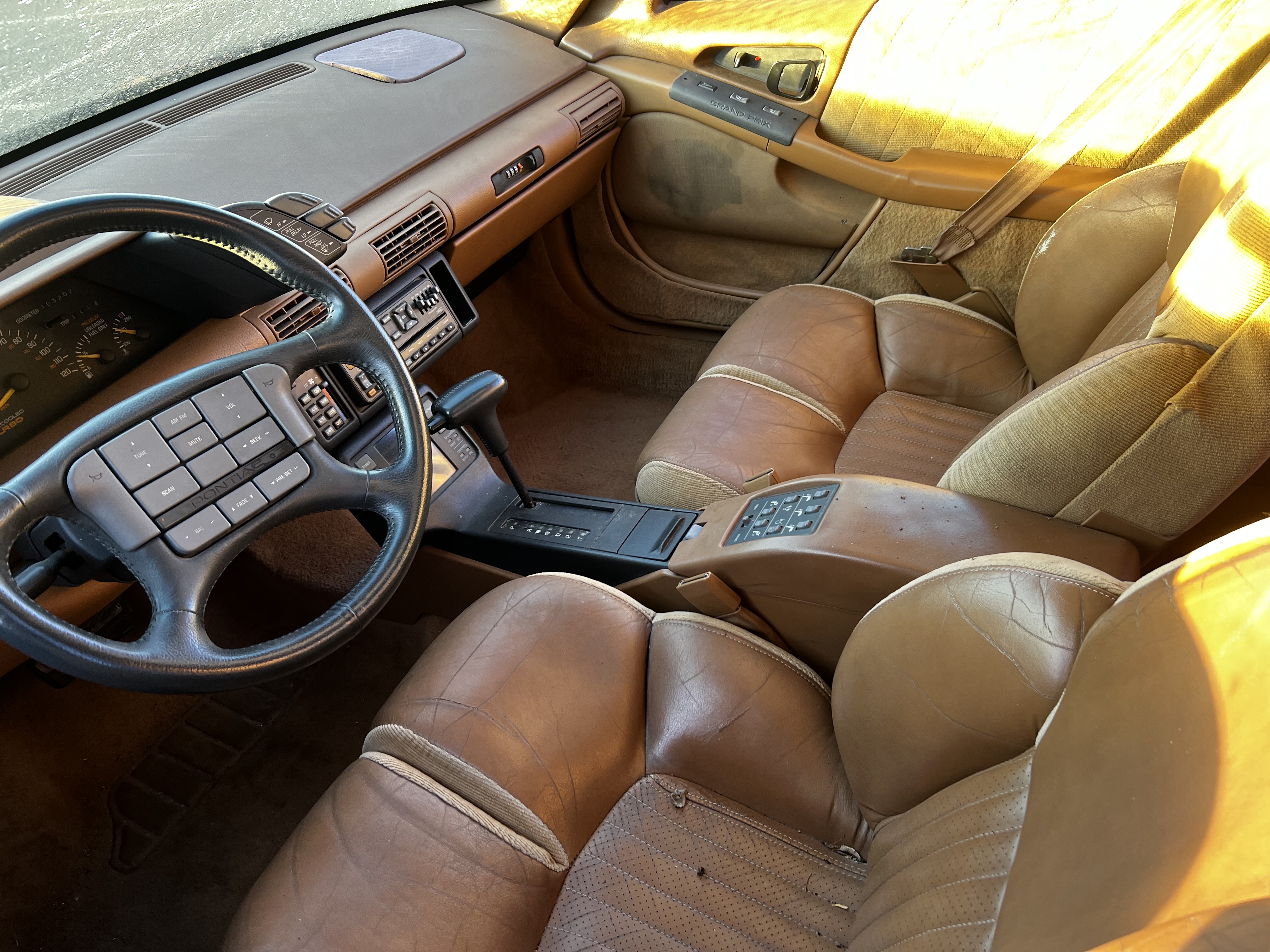

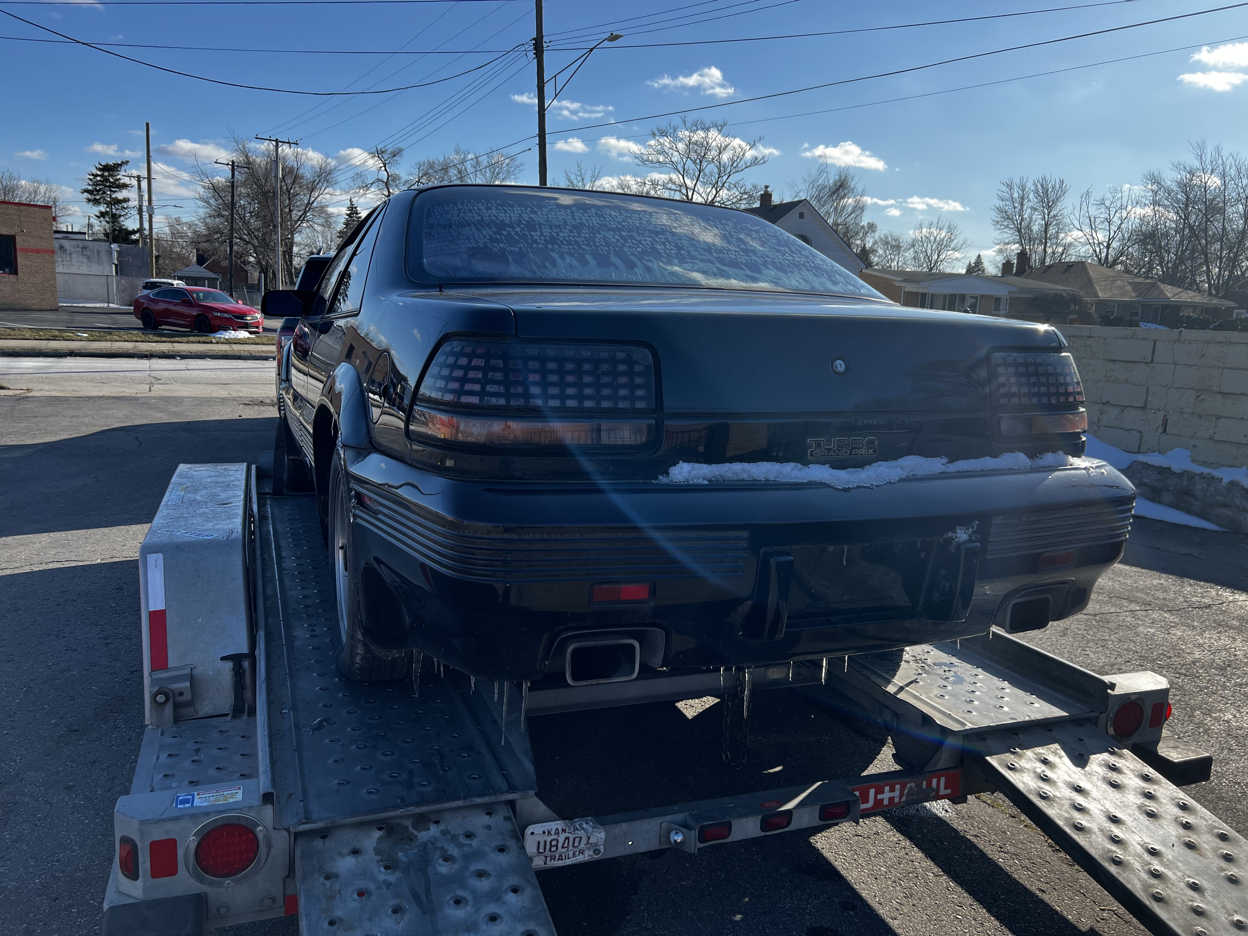

Jaywags Posted March 21, 2023 Report Posted March 21, 2023 (edited) Just picked up this beauty. she's been sitting for about 6 years, she does start, runs and drives but will need some tlc. Super excited to get her on the road again. Edited March 22, 2023 by Jaywags oldmangrimes, 94 olds vert, pwmin and 2 others 2 3 Quote
Bake82 Posted March 21, 2023 Report Posted March 21, 2023 Looks like a solid start! How's the underside of the car? Quote

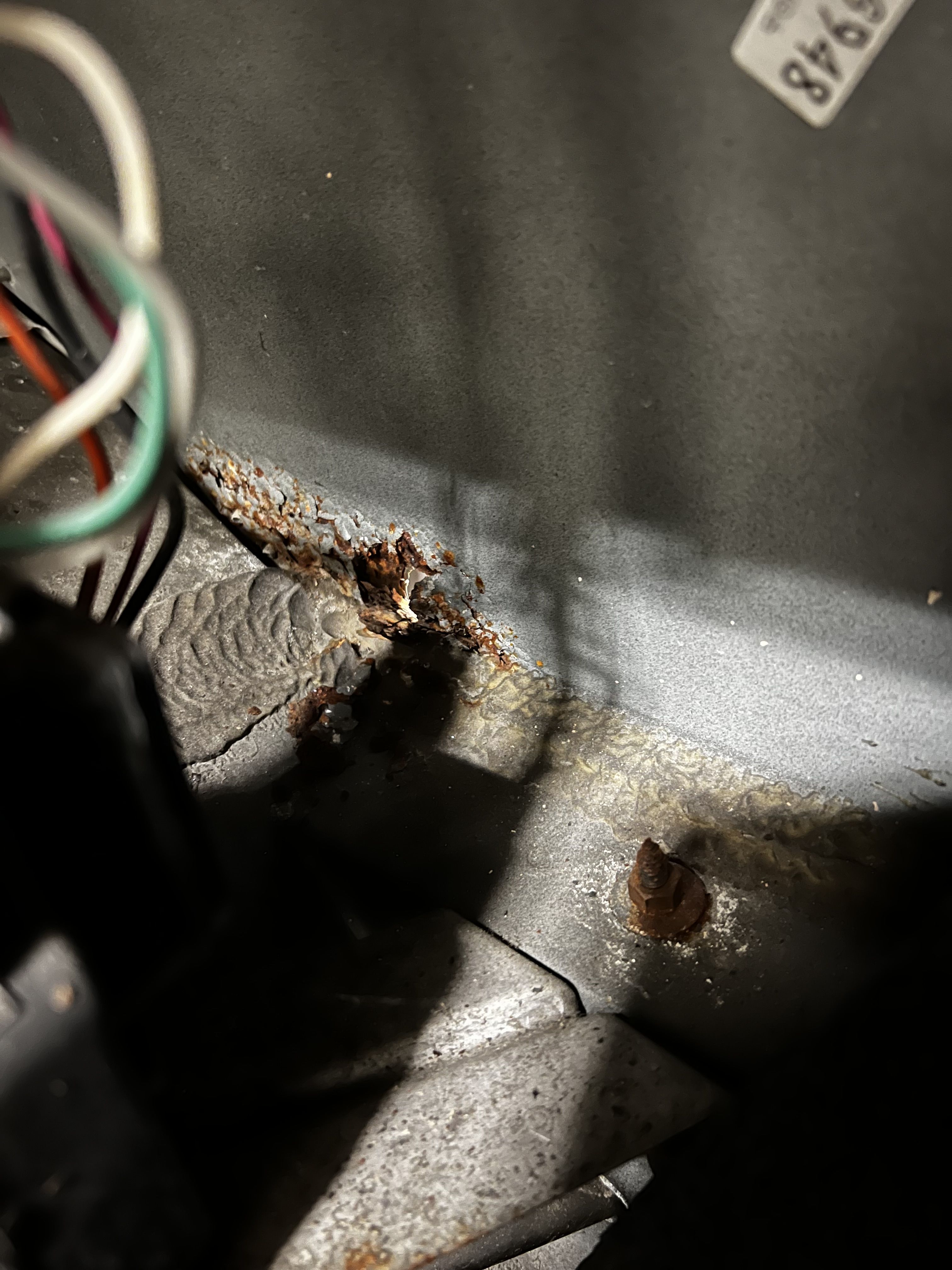

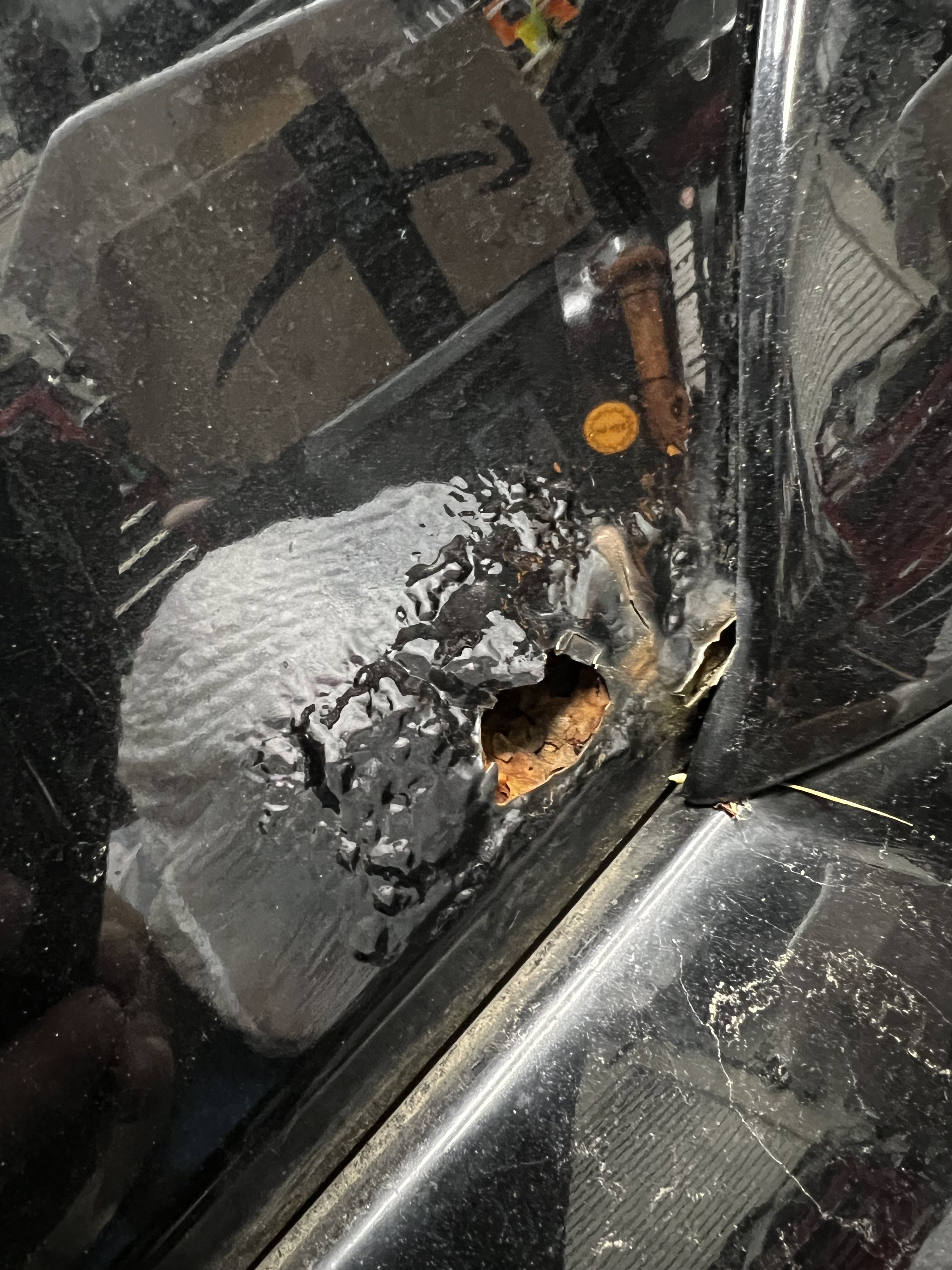

Jaywags Posted March 21, 2023 Author Report Posted March 21, 2023 27 minutes ago, Bake82 said: Looks like a solid start! How's the underside of the car? Surprisingly good considering its from Michigan, under body is mint, just subframe and control arm rust... typical. Body has a rust hole on the passenger rear quarter panel.. looks good otherwise.. 94 olds vert 1 Quote
GTP091 Posted March 21, 2023 Report Posted March 21, 2023 Nice score on the TGP! low mileage! Theryre one of the few wbodys that hold value and are considered a collector. If you get some moisture into those seats quick they might just hang in there. Check your trailing arm mounts before you go for a rip. Jaywags and 94 olds vert 2 Quote
Jaywags Posted March 21, 2023 Author Report Posted March 21, 2023 2 minutes ago, GTP091 said: Nice score on the TGP! low mileage! Theryre one of the few wbodys that hold value and are considered a collector. If you get some moisture into those seats quick they might just hang in there. Check your trailing arm mounts before you go for a rip. For sure, I'm going to go through everything before she hits the road 94 olds vert and oldmangrimes 2 Quote

oldmangrimes Posted March 21, 2023 Report Posted March 21, 2023 I LOVE those wheels, the gold crosslaces with the polished lip, on a black car. Jaywags 1 Quote
rich_e777 Posted March 21, 2023 Report Posted March 21, 2023 Nice find! What a time machine. Ive got a rust spot in the same area as you have on a similar car and found it to be the antenna mast leaking down vs the inner wheel well eating through. I have not had a shop quote mine to know roughly what it`d cost to have it pro repaired. Jaywags 1 Quote
Jaywags Posted March 21, 2023 Author Report Posted March 21, 2023 1 minute ago, rich_e777 said: Nice find! What a time machine. Ive got a rust spot in the same area as you have on a similar car and found it to be the antenna mast leaking down vs the inner wheel well eating through. I have not had a shop quote mine to know roughly what it`d cost to have it pro repaired. Thanks, definitely need to get that spot repaired… didn’t even think about the antenna causing the leak..makes total sense.. thanks for that! Quote
94 olds vert Posted March 21, 2023 Report Posted March 21, 2023 12 minutes ago, Jaywags said: Thanks, definitely need to get that spot repaired… didn’t even think about the antenna causing the leak..makes total sense.. thanks for that! That is a very typical spot for these cars to rust out. Being a MI car that doesn't surprise me for there to be rust in that area. It is repairable, I had a shop repair rust on my old car in that exact same location. primergray and Jaywags 2 Quote
Jaywags Posted March 22, 2023 Author Report Posted March 22, 2023 55 minutes ago, 94 olds vert said: That is a very typical spot for these cars to rust out. Being a MI car that doesn't surprise me for there to be rust in that area. It is repairable, I had a shop repair rust on my old car in that exact same location. How terrible was the price? Quote
94 olds vert Posted March 22, 2023 Report Posted March 22, 2023 4 minutes ago, Jaywags said: How terrible was the price? That was over a decade ago and the repair was less than $500. Jaywags 1 Quote
Jaywags Posted March 22, 2023 Author Report Posted March 22, 2023 1 hour ago, 94 olds vert said: That was over a decade ago and the repair was less than $500. Lol… so just quadruple that for todays cost… 94 olds vert 1 Quote

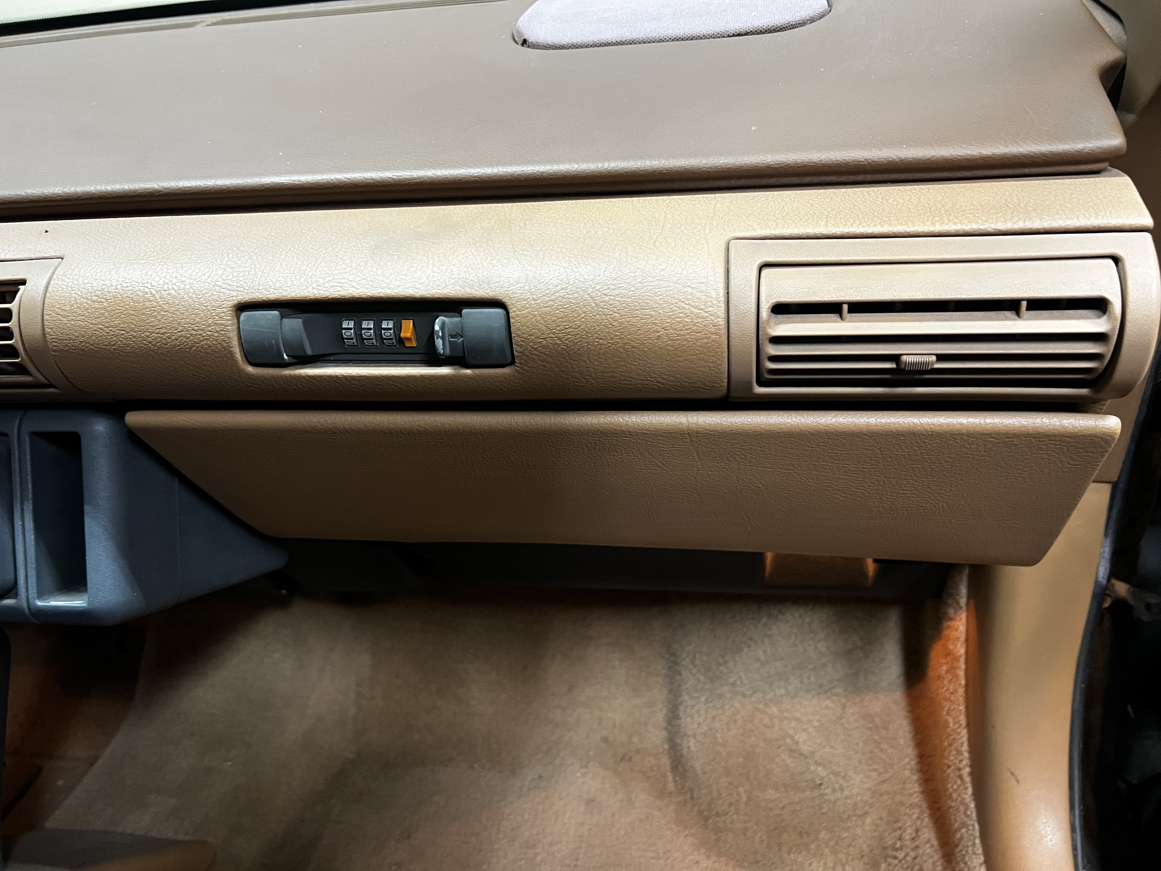

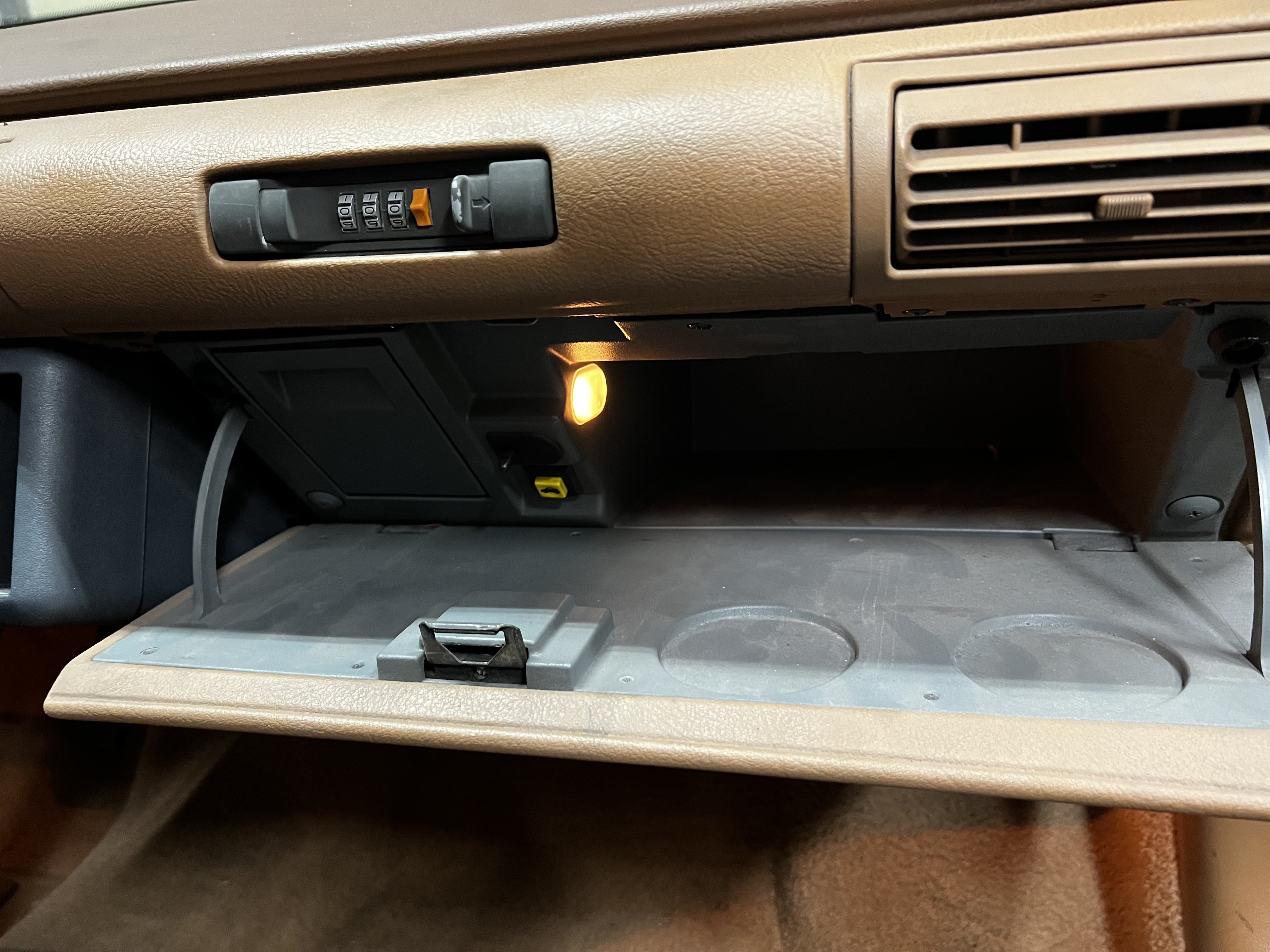

Jaywags Posted March 25, 2023 Author Report Posted March 25, 2023 Had to pick the pad lock… previous owner forgot the combination… lol I reset it to 000… unfortunately no treasures but the fact that the fuses are still intact with original tape… I’ll take it… primergray, rich_e777, Raffaelli and 2 others 3 2 Quote

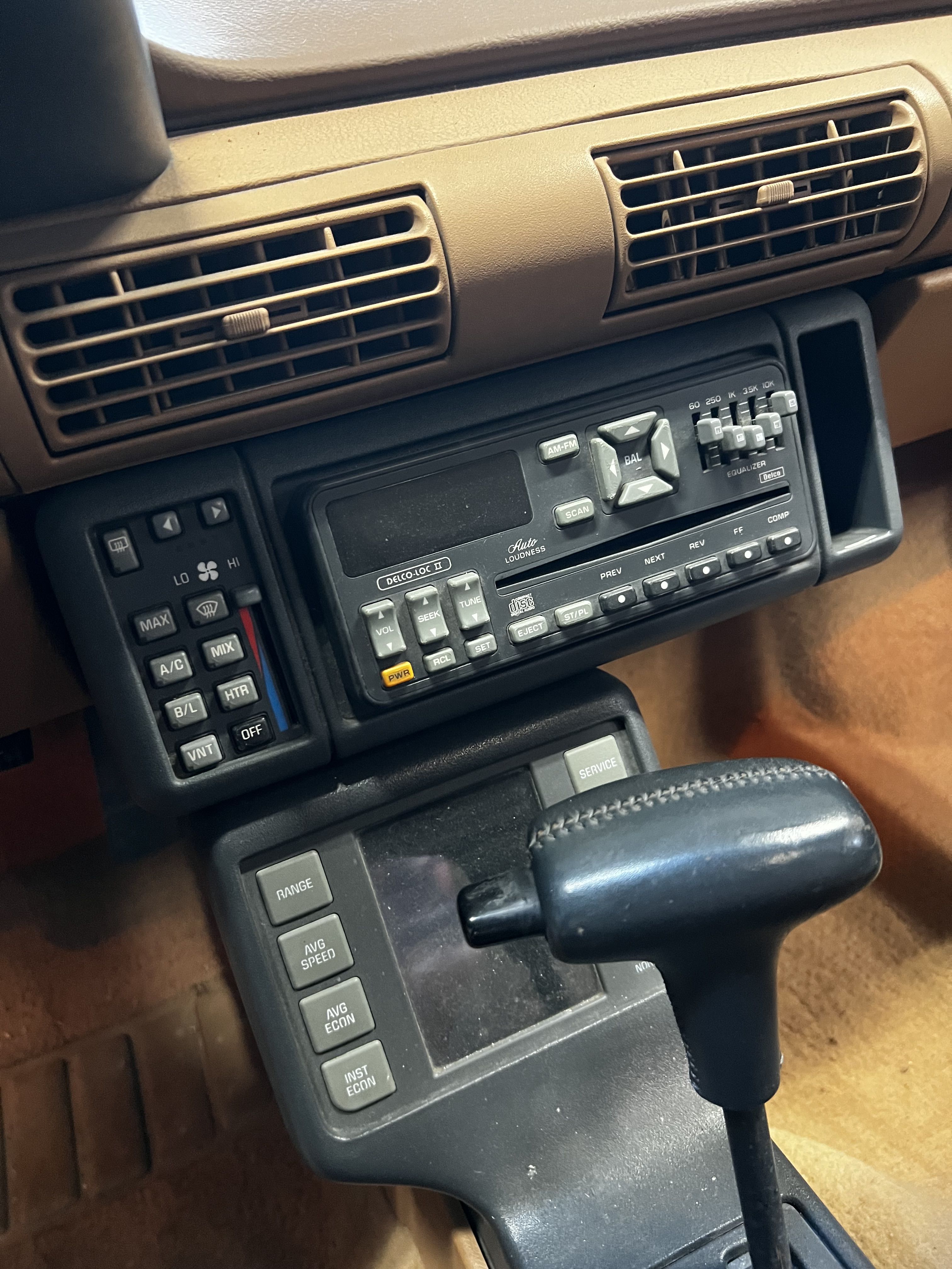

jiggity76 Posted March 26, 2023 Report Posted March 26, 2023 On 3/21/2023 at 6:42 PM, Jaywags said: Thanks, definitely need to get that spot repaired… didn’t even think about the antenna causing the leak..makes total sense.. thanks for that! Make sure the drain tube is hooked up properly and that it's actually down into the trunk floors drain hole...if it's still there and the rust hasn't made it disappear. This tube takes water from the mast and directs it thru the tube, thru the trunk floor, and onto the ground. Beautiful Turbo! Black is more rare than the Red cars and it having CD is awesome! CD units are rare on any early GP really. Jaywags 1 Quote

Jaywags Posted March 26, 2023 Author Report Posted March 26, 2023 1 hour ago, jiggity76 said: Make sure the drain tube is hooked up properly and that it's actually down into the trunk floors drain hole...if it's still there and the rust hasn't made it disappear. This tube takes water from the mast and directs it thru the tube, thru the trunk floor, and onto the ground. Beautiful Turbo! Black is more rare than the Red cars and it having CD is awesome! CD units are rare on any early GP really. Thank you!! Sunroof seal was swollen, so that was probably the issue, it wouldn’t close all the way.. speaking of sunroof… I need a new seal too… another part that discontinued. Only option I have is to source a new glass with a good seal… jiggity76 1 Quote

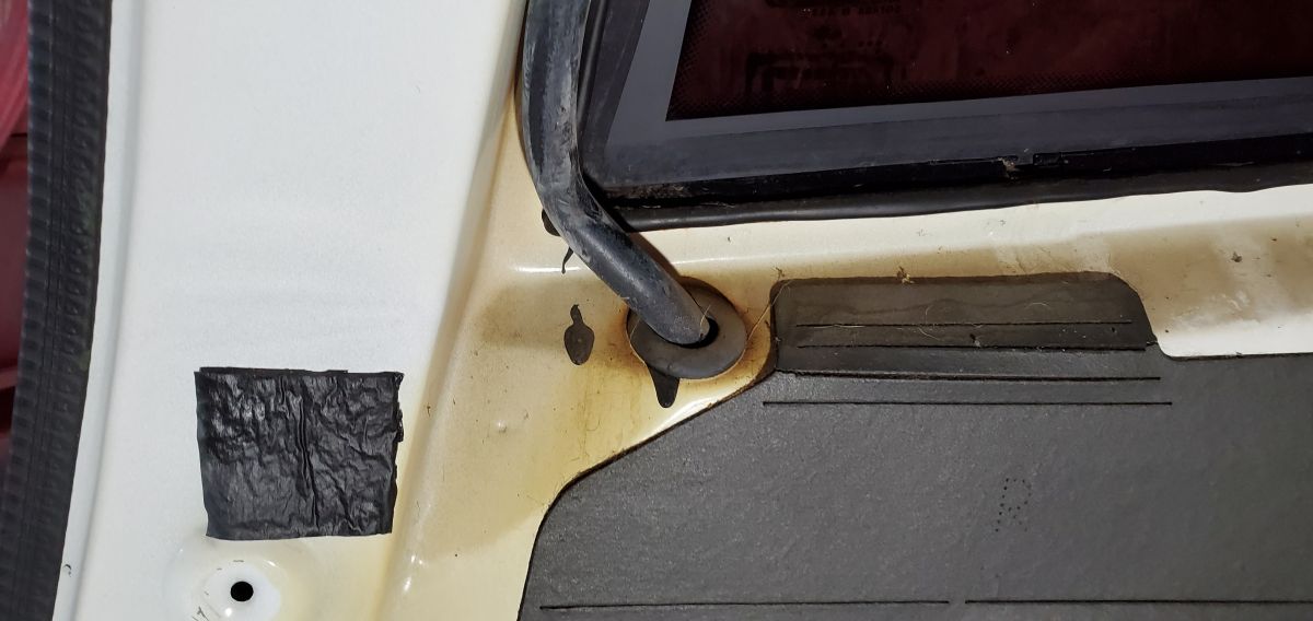

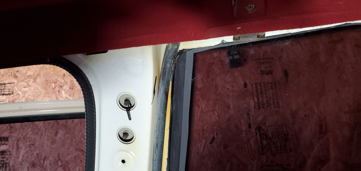

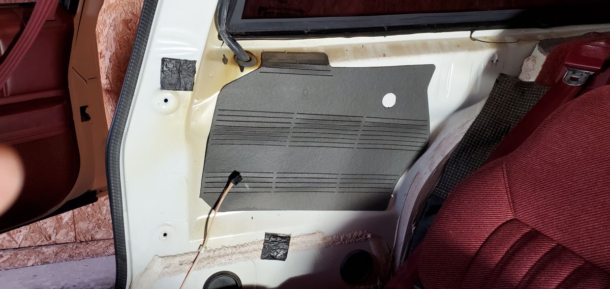

jiggity76 Posted March 26, 2023 Report Posted March 26, 2023 7 minutes ago, Jaywags said: Thank you!! Sunroof seal was swollen, so that was probably the issue, it wouldn’t close all the way.. speaking of sunroof… I need a new seal too… another part that discontinued. Only option I have is to source a new glass with a good seal… No problem. Just to be clear, I was talking about the drain tube for your antenna mast, the area there in the trunk floor and quarter panel being crusty. The sunroof drain tubes will come from the sunroof, down the sides of the B pillars and into the floor pan. Again, there will be a hole in the floor pan where the tube goes thru and exits out into the quarter panel cavity ahead of the rear wheels. You can pull off those black pressure release covers that you see when you open the doors and look down into that cavity. You can check to see if the quarters look ok. Here's my International for reference. Quote
Jaywags Posted March 26, 2023 Author Report Posted March 26, 2023 19 minutes ago, jiggity76 said: No problem. Just to be clear, I was talking about the drain tube for your antenna mast, the area there in the trunk floor and quarter panel being crusty. The sunroof drain tubes will come from the sunroof, down the sides of the B pillars and into the floor pan. Again, there will be a hole in the floor pan where the tube goes thru and exits out into the quarter panel cavity ahead of the rear wheels. You can pull off those black pressure release covers that you see when you open the doors and look down into that cavity. You can check to see if the quarters look ok. Here's my International for reference. Ahhh, ok, yes, I’ll need to check that out… I saw a tube but thought it might had been for the sunroof, again, thank you so much for info.. jiggity76 1 Quote
jiggity76 Posted March 26, 2023 Report Posted March 26, 2023 22 minutes ago, Jaywags said: Ahhh, ok, yes, I’ll need to check that out… I saw a tube but thought it might had been for the sunroof, again, thank you so much for info.. No problem. I need to make a correction after looking at my own pics, LOL. Those sunroof drain tubes don't go down to the floor pan obviously. They go down into the top of the quarter panel inner structure right next to the bottom of the quarter window glass and THEN they do down into the quarter panel cavity. My bad. Quote
