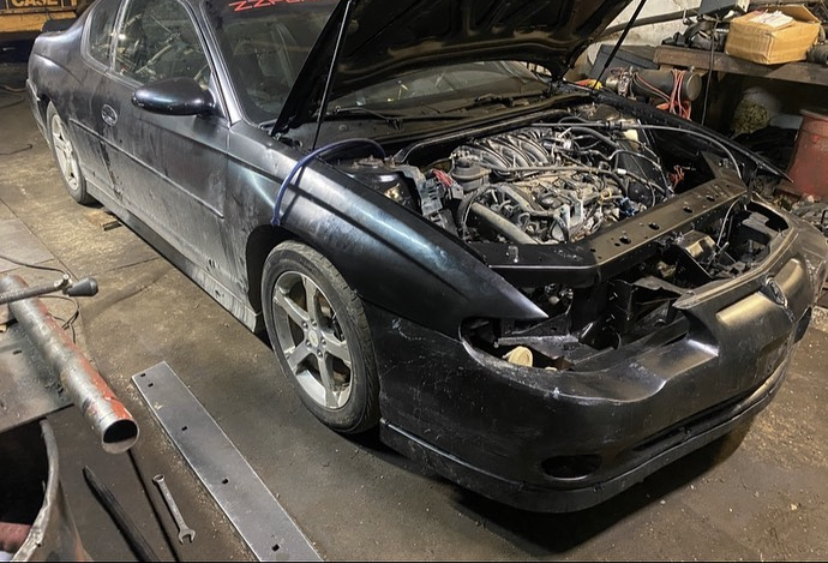

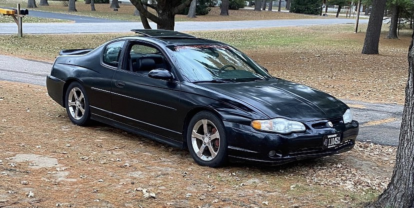

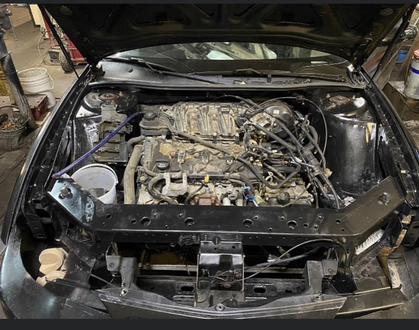

ThatLFXmonteSS Posted January 9, 2023 Report Posted January 9, 2023 Hello all you w body guys! Here is my 2003 Monte Carlo with a 3.6 and 6t70 swap! If you guys have any questions feel free to ask! PastaPirate, 94 olds vert, primergray and 3 others 6 Quote

ThatLFXmonteSS Posted January 10, 2023 Author Report Posted January 10, 2023 10 minutes ago, White93z34 said: Love it. What drove you to choose the LFX over the more conventional L67 swap that people tend to like (I mean aside of the fact that a LFX if more powerful out of the box) Well…. After going through my 9th 4t65e I wanted to do something different, We had the impala sitting out back, we also had an 06 monte ss out back, and a 07 Grand Prix so I mean, i could have done an ls4 swap, or even shoved and l32 in it and called it a day. But as far as I know the lfx swap was never done before, and I have plenty of time, so I decided that the lfx was to way to go mainly because of how strong the 6t70 has proven itself to be, and the fact that I wanted to modernize the car. I loved how the monte was from the factory but I always wished it was a little bit more modern, now with this entire swap I have gained the stability control + the altogether better traction system, the whole car uses the can-bus now so you can do a few more electronic things in the car, and well, I always have liked dohc v6s and I’ve always liked the dohc v6 sound when they have equal length exhausts so I I just figured it was worth a shot to try the swap so maybe other people could do it in the future too! tornado_735, White93z34, GnatGoSplat and 1 other 4 Quote
