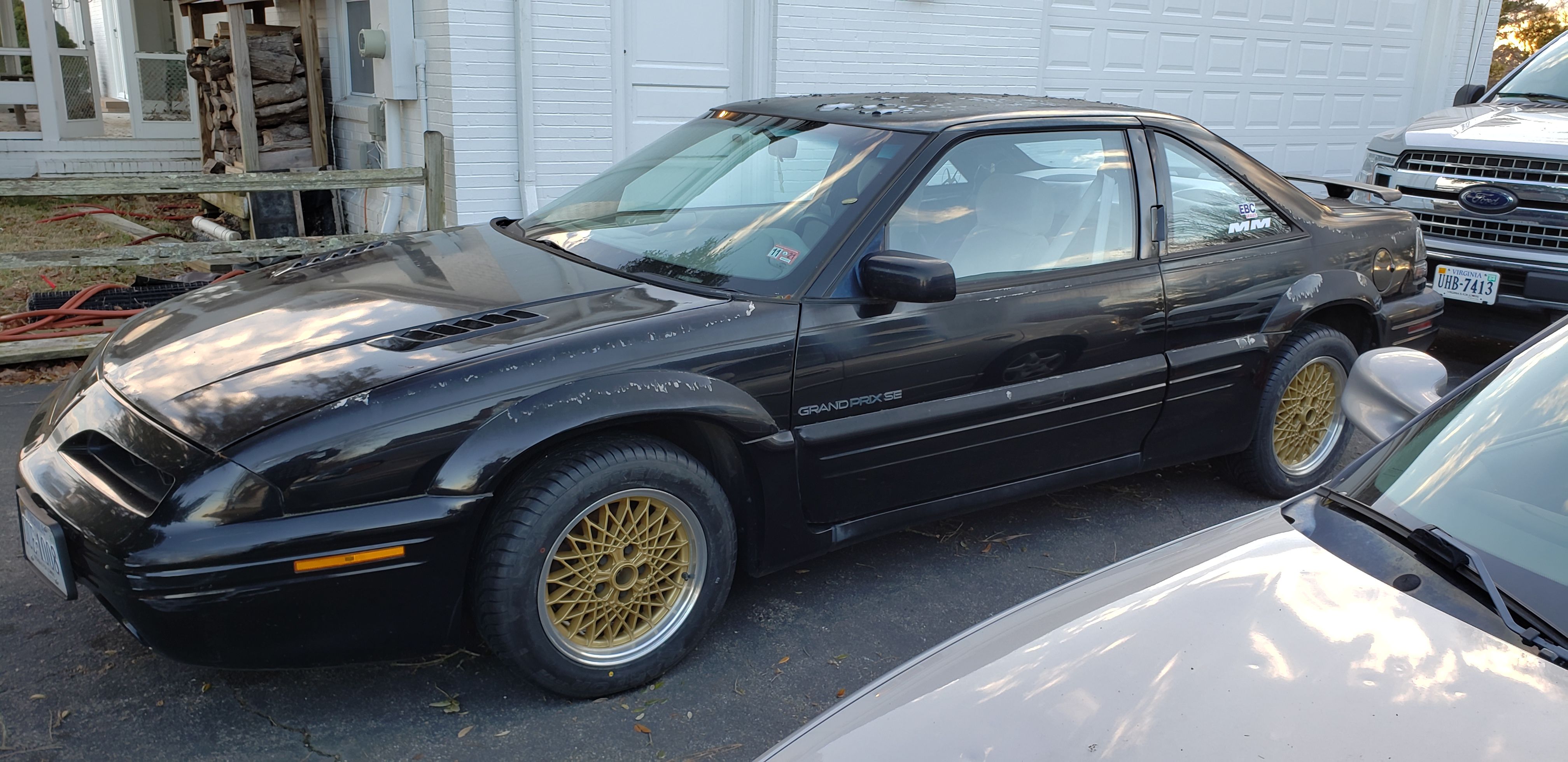

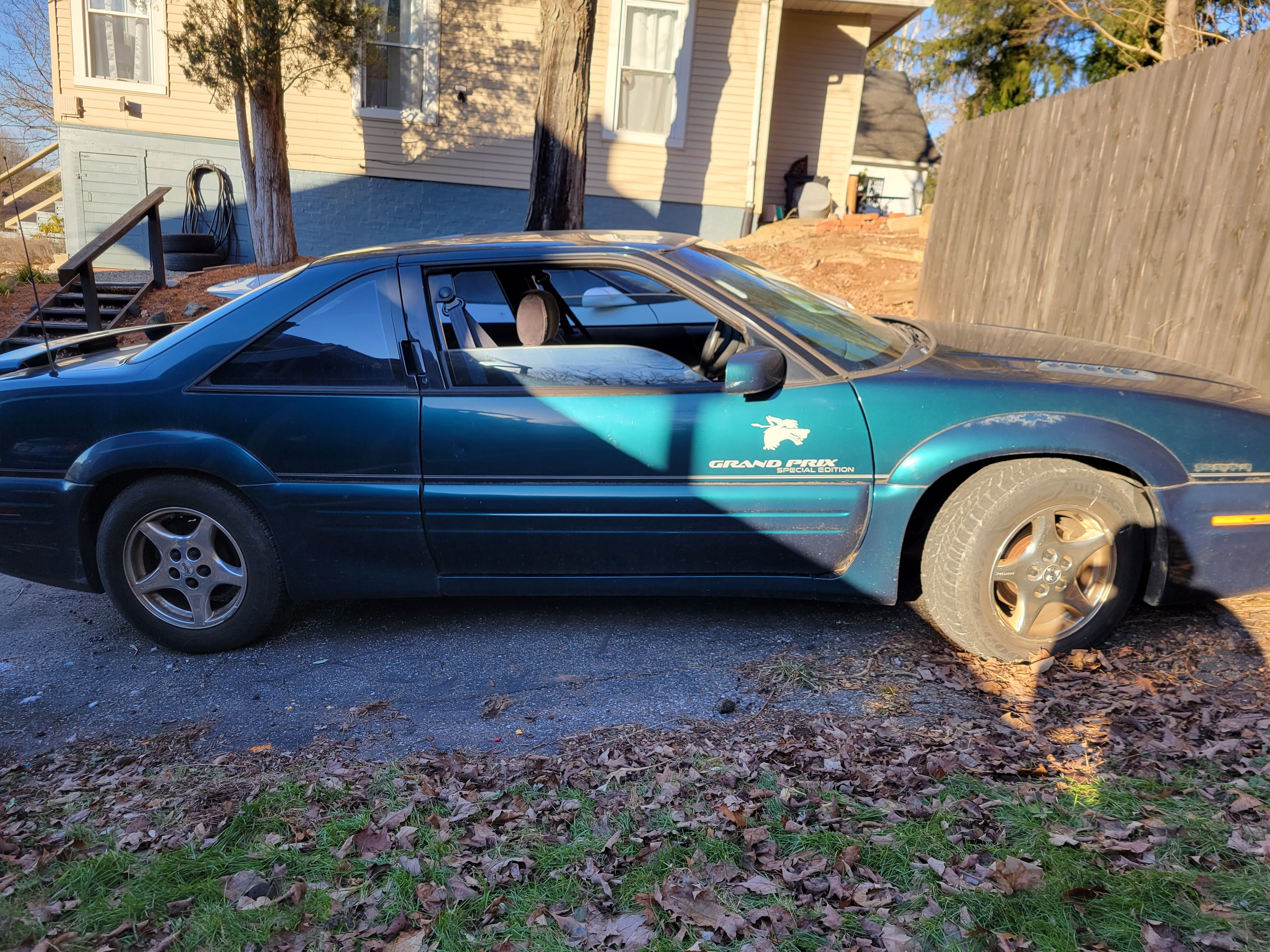

96fan Posted February 26, 2022 Report Posted February 26, 2022 Howdy everyone. Longtime fan of the 89-96 GPs. Recently picked up a 96 SE w/GTP package. Car actually had original window sticker in glove box. Looking forward to good conversation and good information. Picked her up a week ago from a small lot. $1800 plus tax. 138k miles. Looks great other than some clear coat peeling. Desperate need of some love. Just got new oil and filter and air filter in it. New interstate battery. Replaced cracked tires. Have transmission filter and fluid and fuel filter in hand, waiting on time to do those. Just ordered new plugs, wires and ignition coils as it has a miss under load at low rpm. Any insight to things to look for or look over is greatly appreciated. Thanks everyone. 94 olds vert, jiggity76 and GTP091 3 Quote

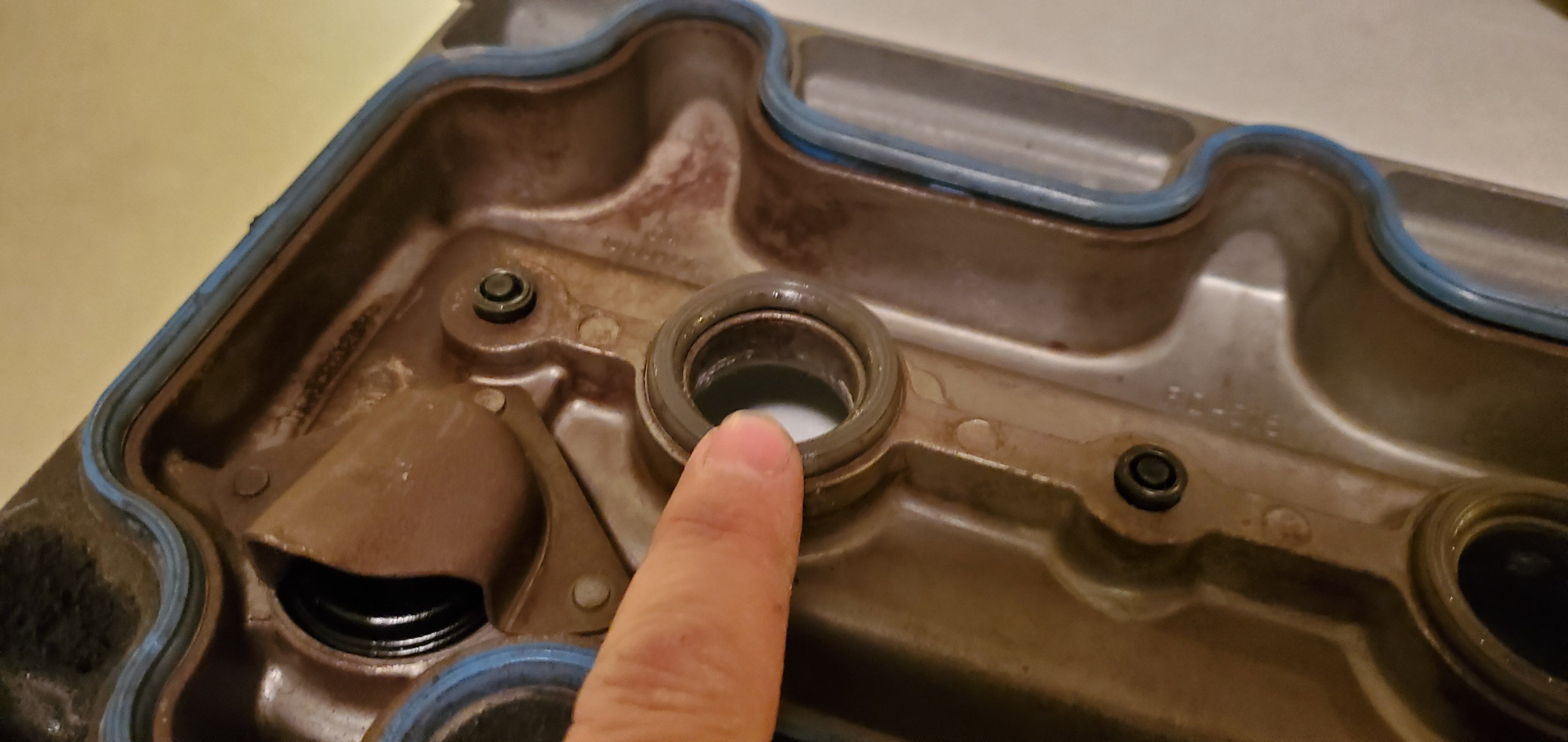

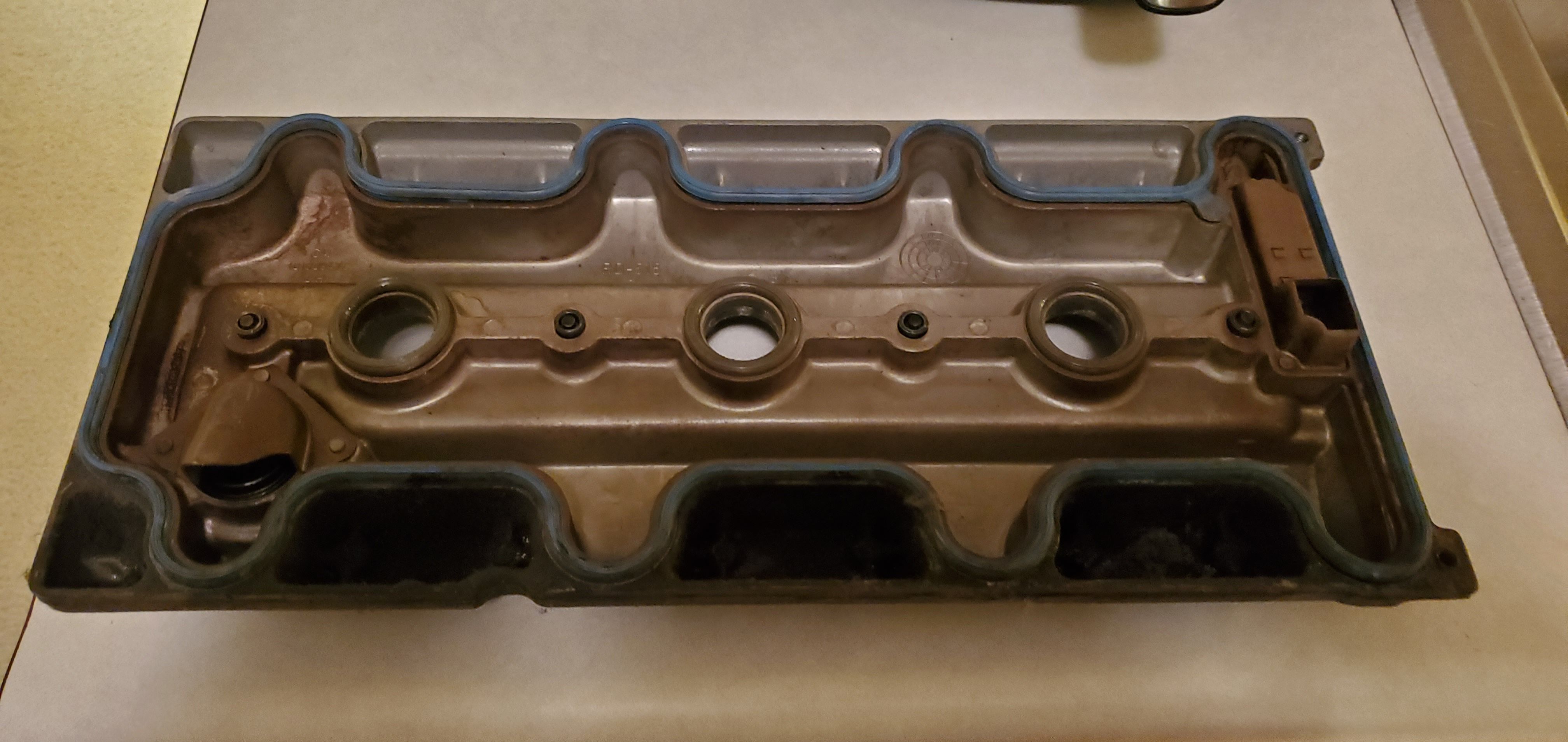

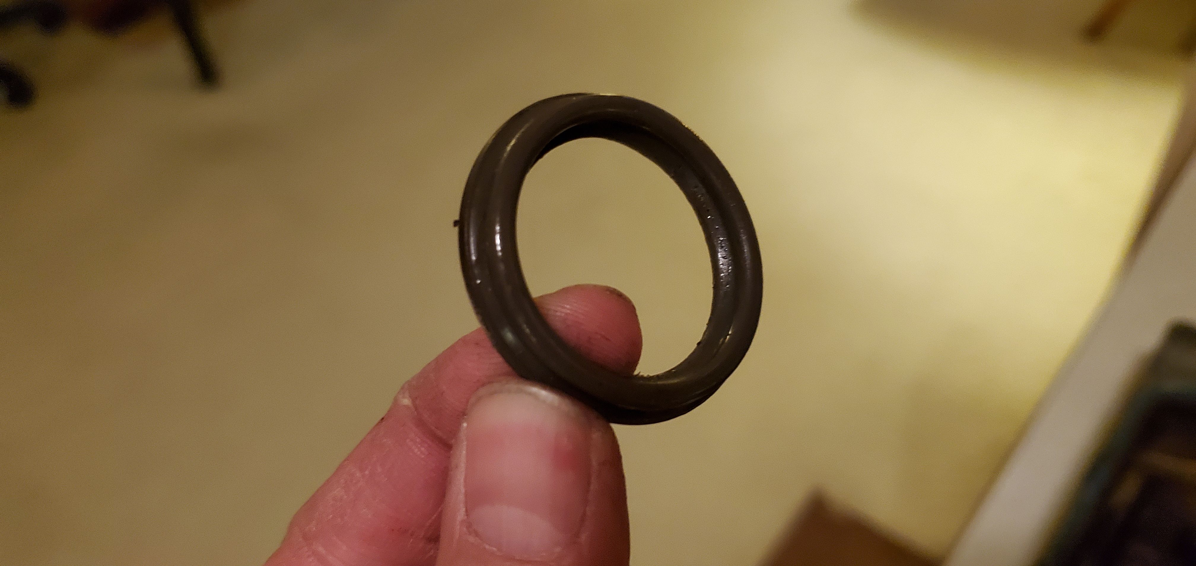

96fan Posted February 27, 2022 Author Report Posted February 27, 2022 20 minutes ago, jiggity76 said: I hope I'm not overstepping but I think this is what 55trucker is referring to. The gaskets or seals on the cam carrier cover for the spark plug holes. These guys. Thanks for the pics. Are those a simple "unbolt" like a valve cover on a 350sbc? Are those known to go bad and I should plan to replace regardless since I'll be doing plugs? jiggity76 1 Quote

jiggity76 Posted February 27, 2022 Report Posted February 27, 2022 4 minutes ago, 96fan said: Thanks for the pics. Are those a simple "unbolt" like a valve cover on a 350sbc? Are those known to go bad and I should plan to replace regardless since I'll be doing plugs? Yup, you'll just have to pull off that vacuum line that goes into the passenger side of it and then it's 4 - 8 MM or 10 MM, I can't remember, bolts that stay with the cover. They will not fully come out as they are locked into the cover with gaskets or something on the underside. 96fan 1 Quote

55trucker Posted February 27, 2022 Report Posted February 27, 2022 (edited) 26 minutes ago, 96fan said: Are those known to go bad and I should plan to replace regardless since I'll be doing plugs? When you pull out the plugs check for oil in the bottom of the tubes, the oil gets in there when those O-rings fail, usually the plug/s will be coated in some degree with oil. It will also show up on the surface of the plug boots Edited February 27, 2022 by 55trucker 96fan and jiggity76 2 Quote
