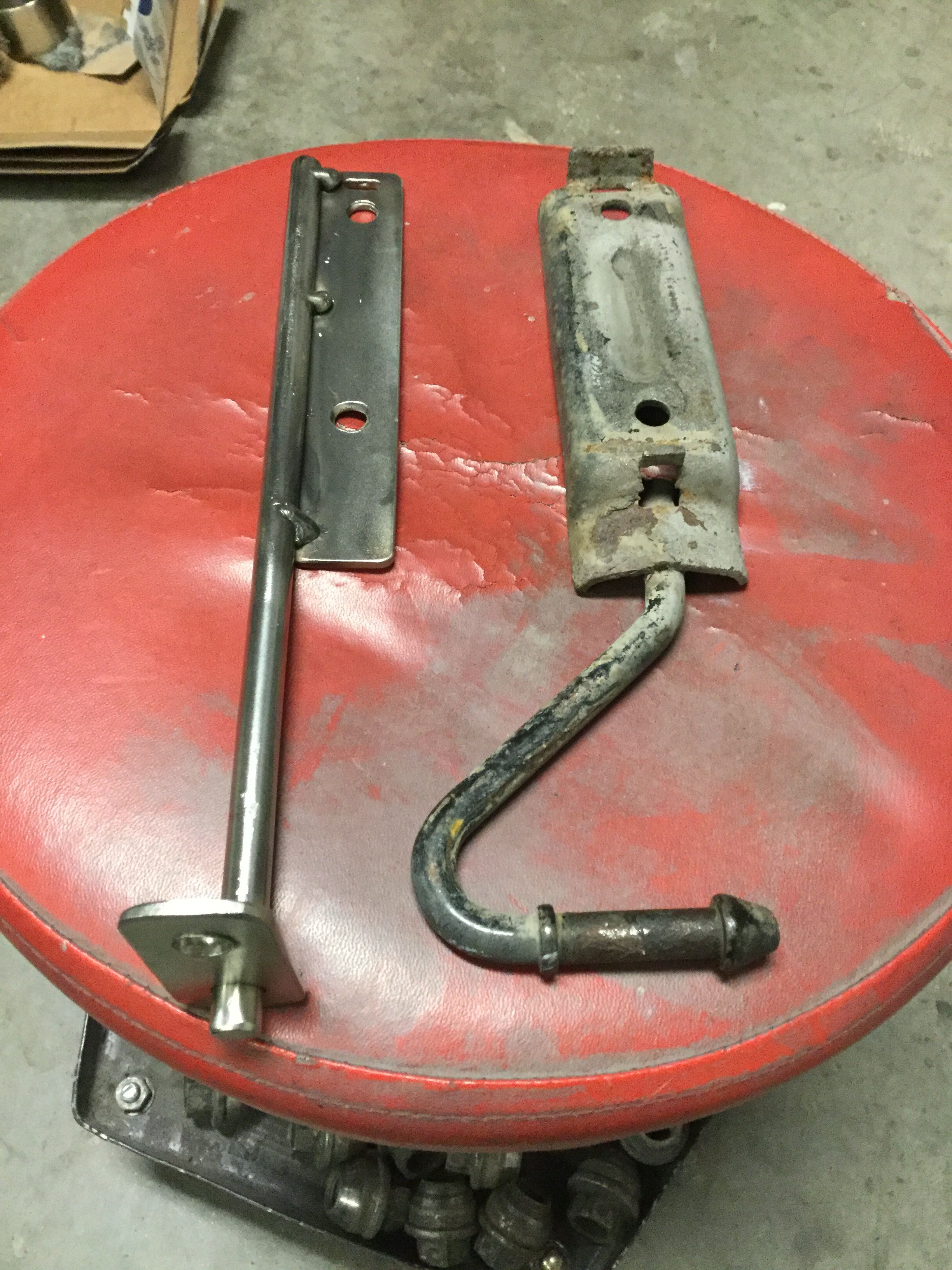

GTP091 Posted March 24, 2021 Author Report Posted March 24, 2021 Y pipe hanger is finished up. Now just need to finish the welding. jiggity76 1 Quote

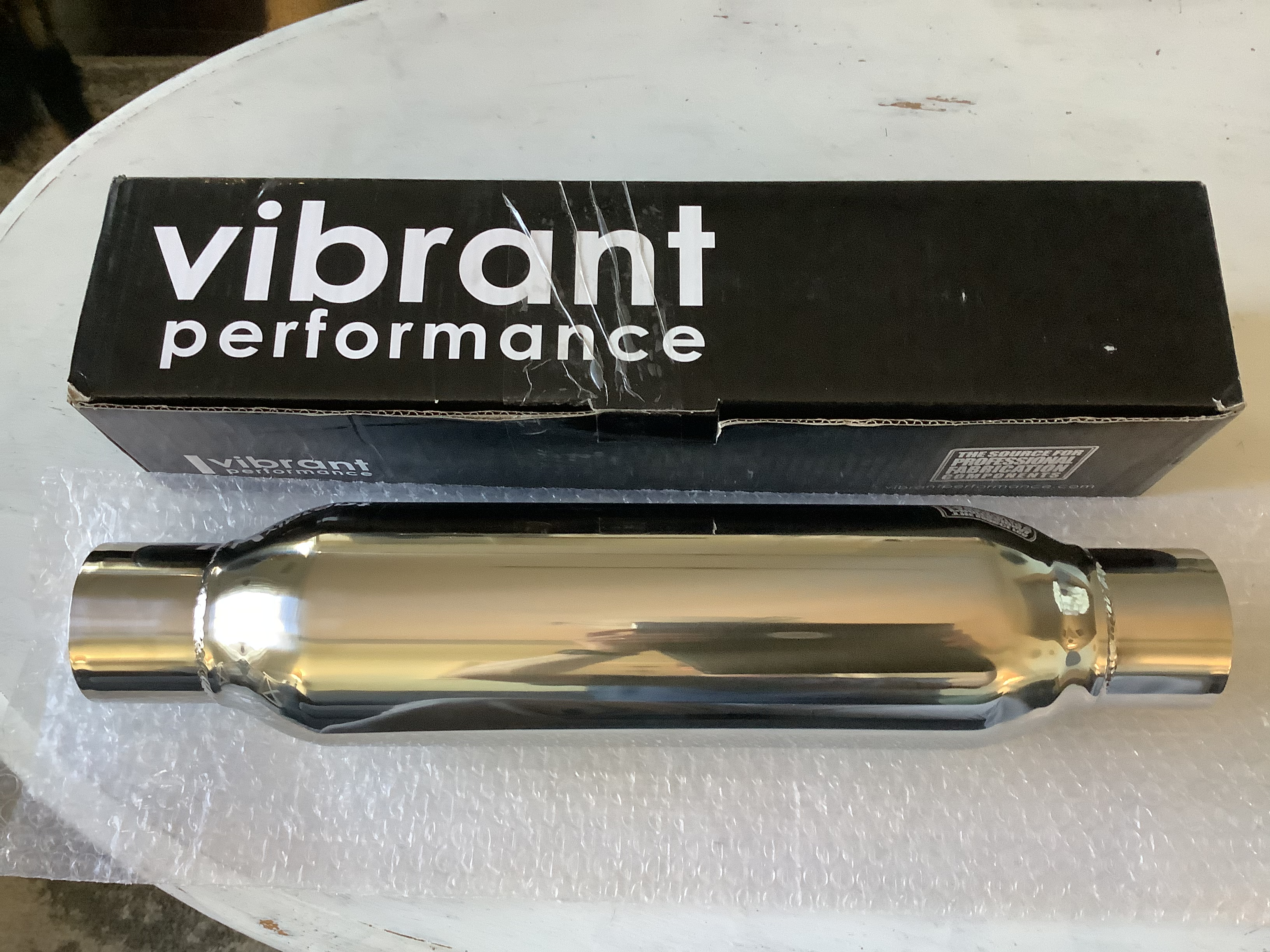

GTP091 Posted March 23, 2023 Author Report Posted March 23, 2023 Well here it is. I over researched it and ended up right back where I started. Vibrant 1793…. I’m very impressed with the build quality of the piece. To bad it’ll be under the GTP where no one will see it. Now for a cut, tack, and off to the tig shop. 2 weeks max for the sweepers to be done! 94 olds vert, Robbie and pwmin 3 Quote

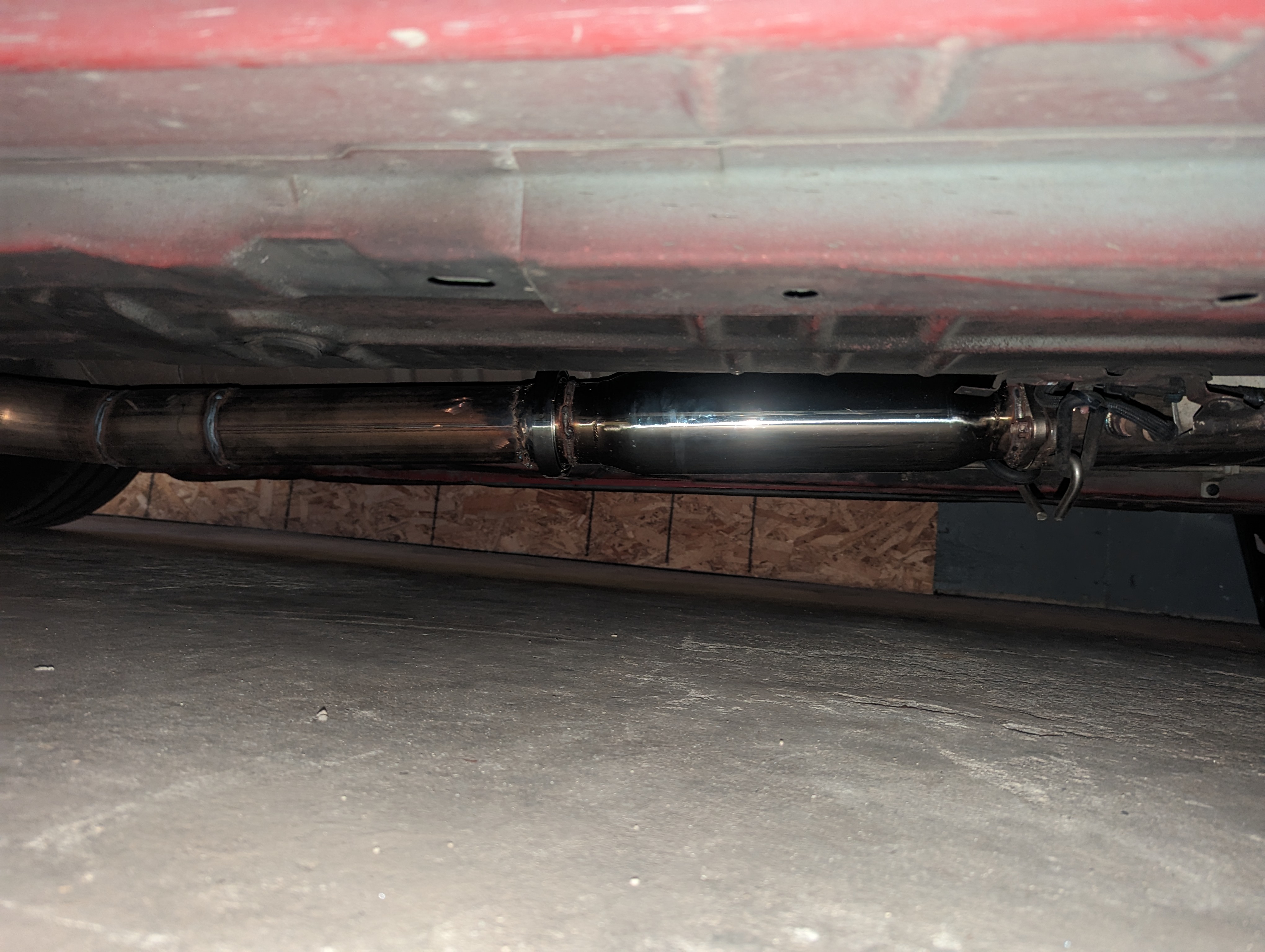

GTP091 Posted April 22, 2023 Author Report Posted April 22, 2023 (edited) Got the resonator back from the tig’r yesterday and put the system back together tonight. It sounds awesome actually. Better than I was expecting. The drone is gone no cold startup rasp. It’s relatively quiet at idle. Has a low rumble under light load. And really growls when younger into the throttle. Best thing is the rumble in the cabin is gone. Street sweepers are mostly done now so I took it for a long rip tonight. First time out! Edited April 23, 2023 by GTP091 pwmin 1 Quote
