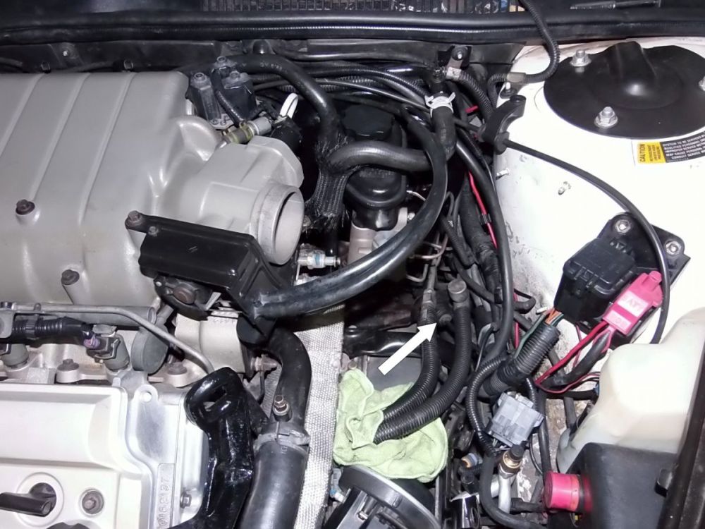

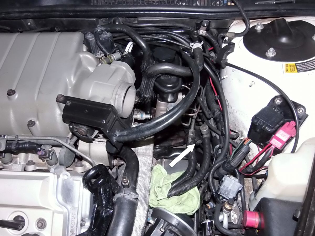

Human Posted September 29, 2020 Author Report Share Posted September 29, 2020 Between weather and work, I haven't had time to get the convertible back over to the transmission shop but I've driven the convertible a few times and sort of figured out what's happening. As I've mentioned before, if I pull the shift lever out of park, back to the first stop, it's in neutral instead of reverse and watching the gear indicator on the console when I do this, I can actually see the red light move just past the 'R' . To get the car into reverse, I have to stop moving the lever at a point when it feels like it's halfway between Park and Reverse. At this point, the 'R' is illuminated and it is indeed in reverse. While this works okay in the short term, I'm concerned that it could lead to problems later on, so the first chance I get, I'll be taking it back to the shop, yet again. Quote Link to comment Share on other sites More sharing options...
55trucker Posted September 29, 2020 Report Share Posted September 29, 2020 (edited) Sounds to me by what you're describing that the trans shifter cable mounted on top of the trans housing is out of sync. Somewhat surprised the the trans shop didn't get the cable position properly set before they gave the car back to you. Edited September 29, 2020 by 55trucker 94 olds vert 1 Quote Link to comment Share on other sites More sharing options...
