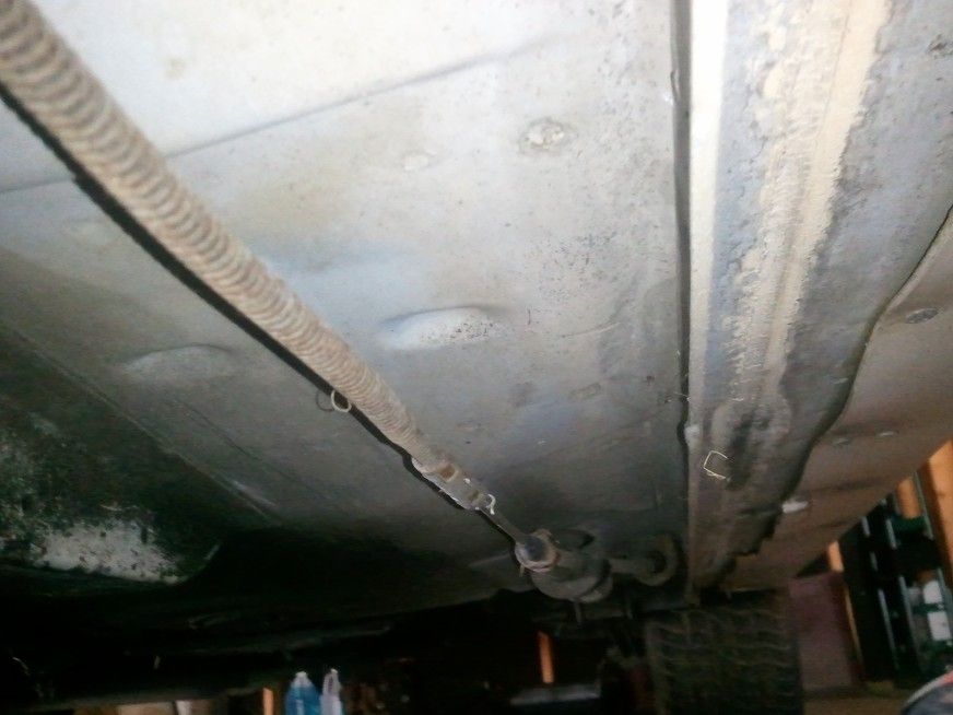

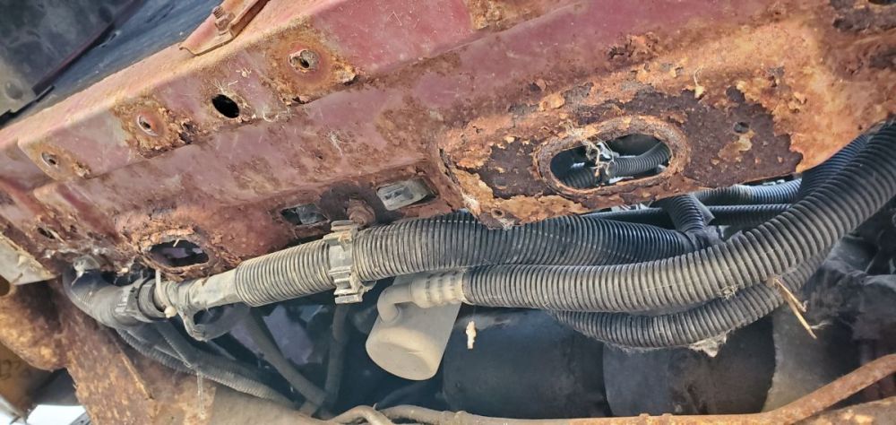

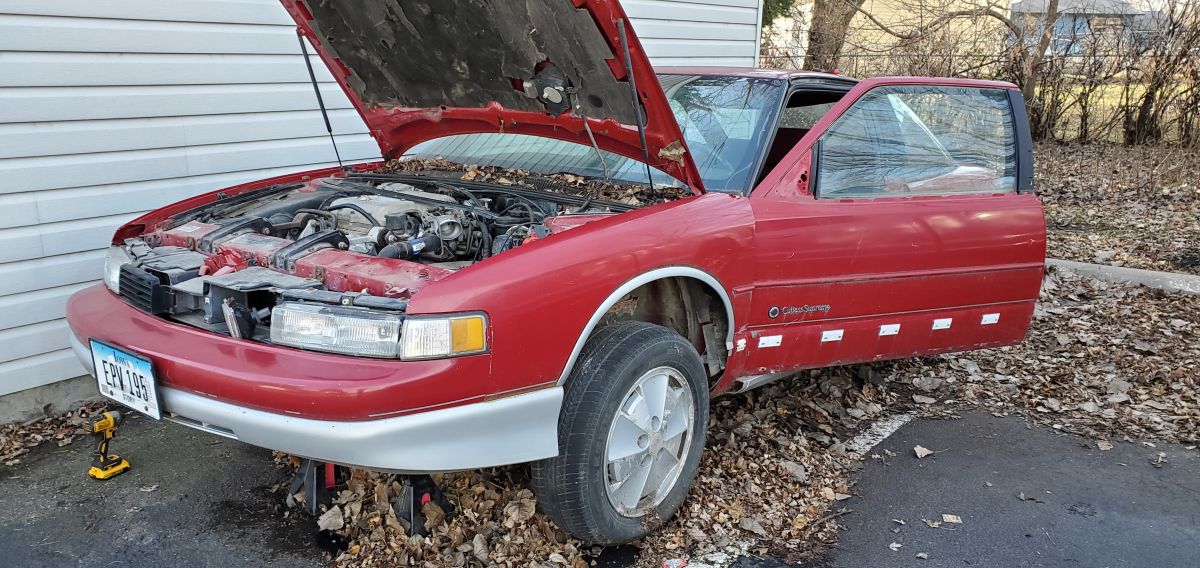

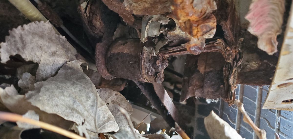

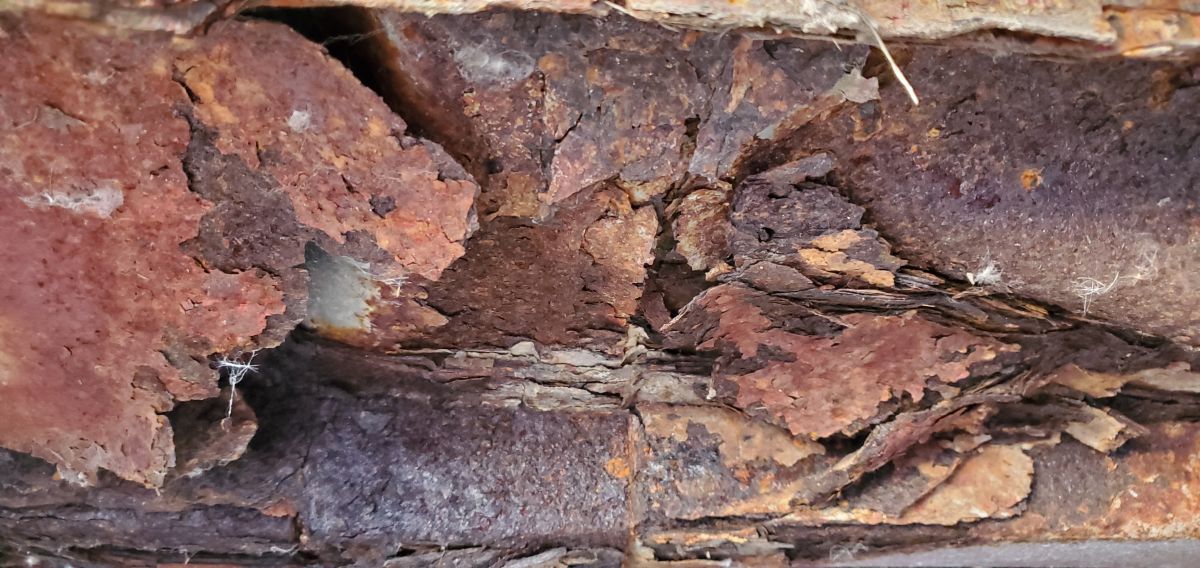

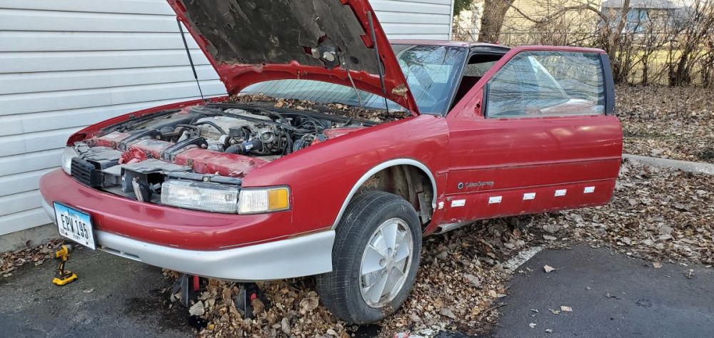

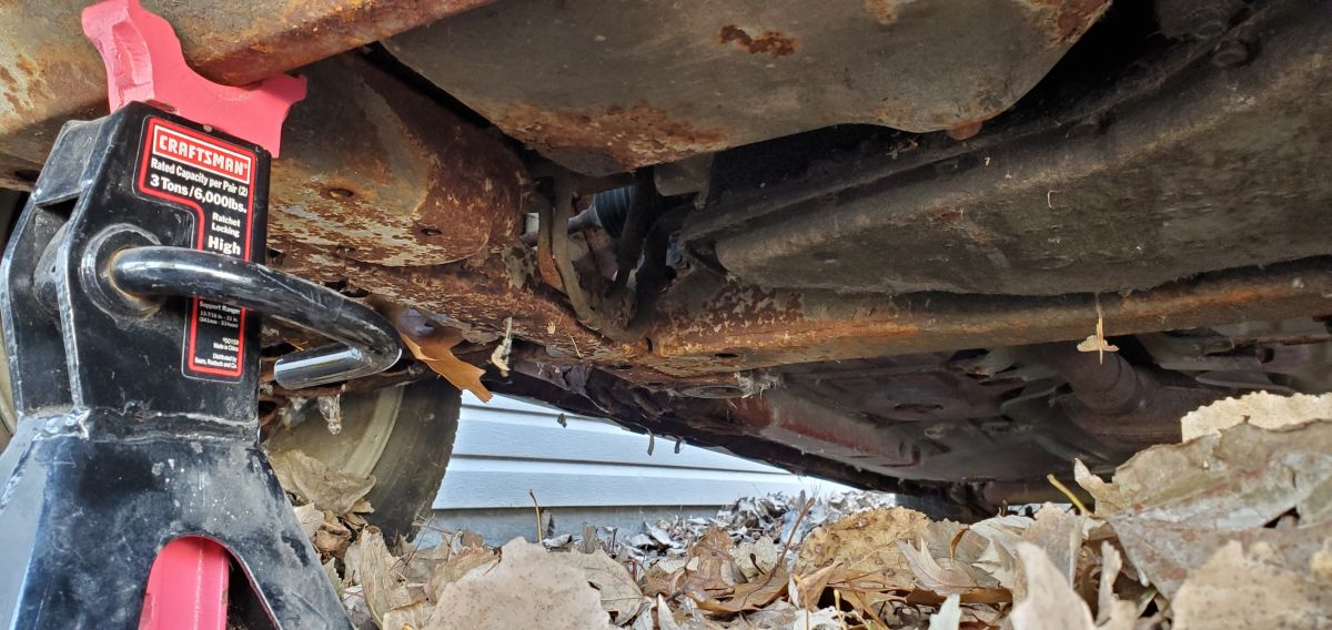

jiggity76 Posted December 21, 2019 Report Posted December 21, 2019 More rotted out parts car pics. Quote

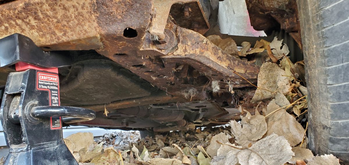

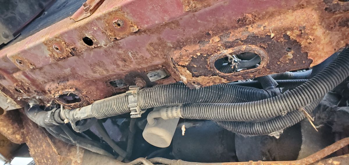

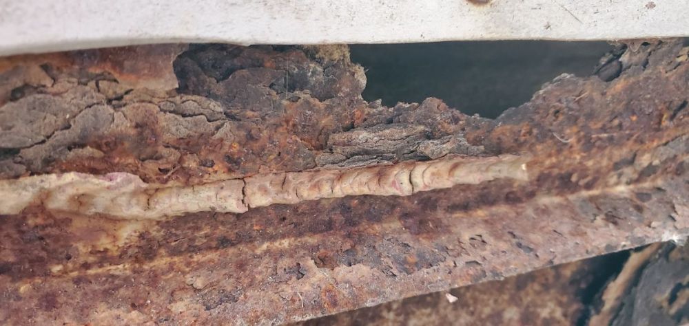

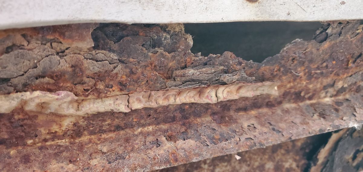

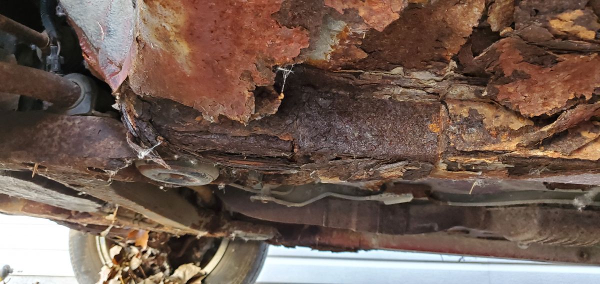

jiggity76 Posted December 21, 2019 Report Posted December 21, 2019 What's left of the driver's side torque box/support rail areas under where the driver's feet would be. 94 olds vert 1 Quote
06goat75 Posted December 22, 2019 Author Report Posted December 22, 2019 That's some serious rust. If this CSC is anything like the above, I'll be passing! I'll check all the standard areas for rust, anything hidden that I can easily look for, especially being a convertible? I'm used to the Fiero world, and know where to pull carpet/panels to look for serious rust issues. Most of the W-bodies I have dealt with were not rust belt cars. jiggity76 1 Quote

jiggity76 Posted December 22, 2019 Report Posted December 22, 2019 4 hours ago, 06goat75 said: That's some serious rust. If this CSC is anything like the above, I'll be passing! I'll check all the standard areas for rust, anything hidden that I can easily look for, especially being a convertible? I'm used to the Fiero world, and know where to pull carpet/panels to look for serious rust issues. Most of the W-bodies I have dealt with were not rust belt cars. I'm unfamiliar with the verts concerning any other specific areas prone to rust. I do know all W-bodies, no matter what variant likes to rust in the pics I posted. Quote

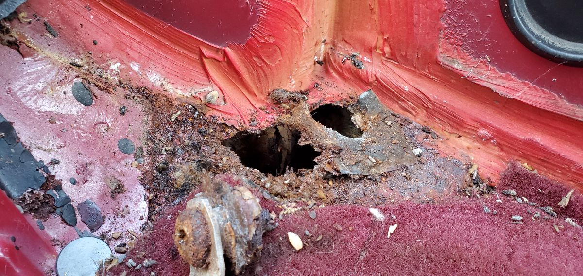

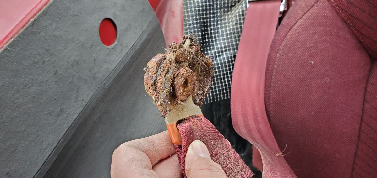

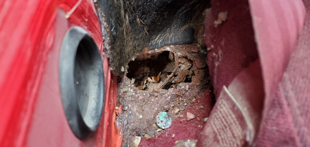

jiggity76 Posted December 23, 2019 Report Posted December 23, 2019 Ok, I'll keep a lookout. By the way, since were talking about rust issues. Get this, my parts car is so rotted, the seat belt bolts that are mounted to the floorpan, they completely tore from the body due to the rot! 94 olds vert 1 Quote
94 olds vert Posted December 23, 2019 Report Posted December 23, 2019 I have seen that before in MI. I used to pull on the seat belts at cars in the junkyard just to see if they would pull free. A lot of them did. Pretty scary. jiggity76 1 Quote
jiggity76 Posted December 23, 2019 Report Posted December 23, 2019 I figured they would since the bolt head was so rotted. If this car was in an accident with belted rear seat occupants, it wouldn't be good. 94 olds vert 1 Quote
94 olds vert Posted December 23, 2019 Report Posted December 23, 2019 Was that an Iowa car its whole life? I didn't think you guys got that much rust down there? Or am I wrong? Quote
jiggity76 Posted December 23, 2019 Report Posted December 23, 2019 Now I just need to figure out how to get the rotted metal out of the seat belt mount, LOL! Quote
94 olds vert Posted December 23, 2019 Report Posted December 23, 2019 16 minutes ago, jiggity76 said: Now I just need to figure out how to get the rotted metal out of the seat belt mount, LOL! soak it in vinegar with some salt in it. The rust will fall off and only clean metal will be left. Then you could probably just push it out. I would be afraid to cut a seat belt mount. One small cut or scrap and you reduce its structural integrity. jiggity76 1 Quote
jiggity76 Posted December 23, 2019 Report Posted December 23, 2019 14 minutes ago, 94 olds vert said: soak it in vinegar with some salt in it. The rust will fall off and only clean metal will be left. Then you could probably just push it out. I would be afraid to cut a seat belt mount. One small cut or scrap and you reduce its structural integrity. I would have never thought of that! How long should I soak it for? The 91 car has good seatbelts in it, just wanted these as a spare since they are damn near perfect ones too. Quote

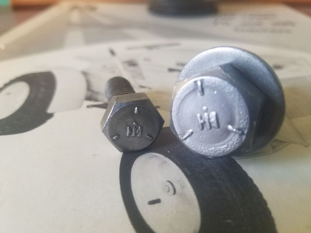

94 olds vert Posted December 23, 2019 Report Posted December 23, 2019 2 minutes ago, jiggity76 said: I would have never thought of that! How long should I soak it for? The 91 car has good seatbelts in it, just wanted these as a spare since they are damn near perfect ones too. I have let stuff sit in salt and vinegar for a month it does a great job. It will only attack the rust not the clean metal. A week should give you very good results. Just as an example a couple of bolts that were very rusty on my 50 year old cub came out great after a week sitting in that solution. jiggity76 1 Quote
jiggity76 Posted December 23, 2019 Report Posted December 23, 2019 14 minutes ago, 94 olds vert said: I have let stuff sit in salt and vinegar for a month it does a great job. It will only attack the rust not the clean metal. A week should give you very good results. Just as an example a couple of bolts that were very rusty on my 50 year old cub came out great after a week sitting in that solution. That's amazing, I'm gonna try this. Just plain old white vinegar? Thanks man! 94 olds vert 1 Quote
94 olds vert Posted December 23, 2019 Report Posted December 23, 2019 Just now, jiggity76 said: That's amazing, I'm gonna try this. Just plain old white vinegar? Thanks man! Just plain white vinegar. Then just sprinkle in salt till you see bubbles. You might not want to do it in a container you care about. The rust could turn it yellow. jiggity76 and Nas Escobar 2 Quote
