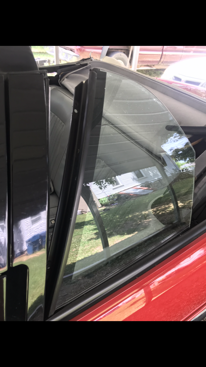

The windows are a little off on my 90 Vert and I’m trying to get them to operate correctly. This window seems like something is broke and goes sideways when rolled up. Do need to replace the whole window? Any one else have this issue?
Your going to have to remove the trim panel and see if it's come out of it's track or the bolts that hold the track to the motor have fallen of.
