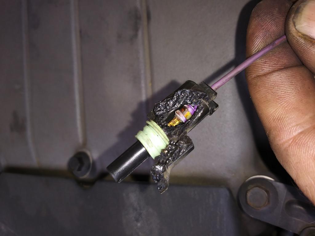

Taper123 Posted June 24, 2018 Report Posted June 24, 2018 New here. Picked up a 1993 Lumina Euro with the 3.4 lq1 engine. It has almost 45k miles on it, and spent most of it's life in a garage so everything looks really nice. Ran great for a bit, but having a few issues lately, and figured this might be a good forum, or someone can point me to one. It started running rough so I took a look under the hood. I see one of the vacuum lines had been replaced, and a wiring harness not properly put back in place (single purple wire connection). Connection is cooked from being against engine. Several elbows on vacuum lines cracked with finger pressure. One of the front spark plugs has oil in the cylinder well. I'm thinking replace most anything rubber on the vacuum lines as age has made them brittle. Need to track down what the cooked wire connector goes to, and see where the oil is coming from. I'm betting these are the original plugs. I put 3k miles on it since I got it. Nice car though... so I want to make it run smooth again. Quote

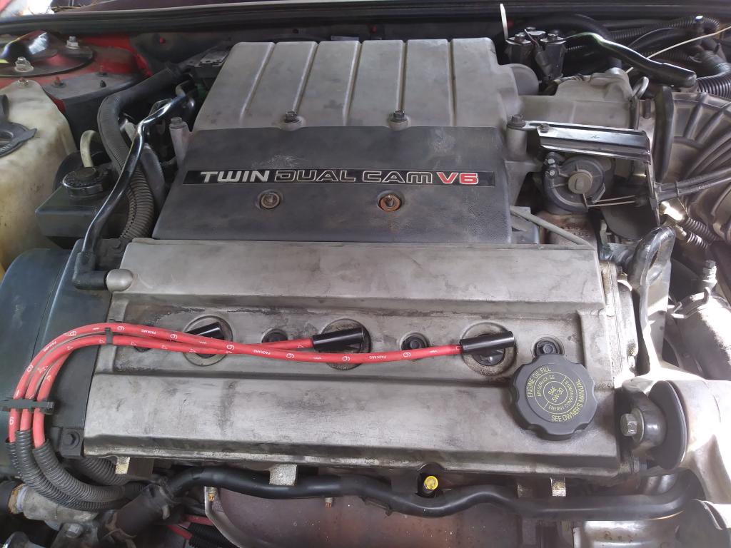

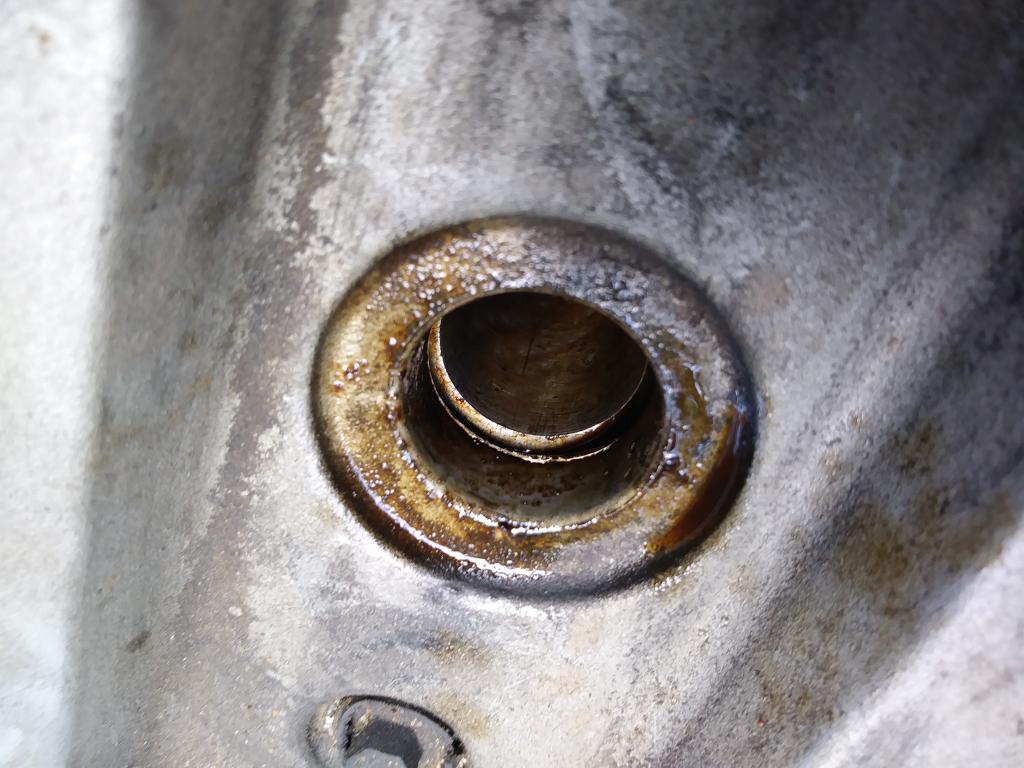

Taper123 Posted June 24, 2018 Author Report Posted June 24, 2018 Sounds good. I changed the front three plugs today and it ran super smooth after that. The oil is coming from the valve cover gasket. Hit it with some compressed air...and oil went everywhere. Local auto parts place didn't have a gasket in stock, so I'll search online and order one along with vacuum lines. Back three plugs look like a challenge to get out. Car was a family members. She kept it in the garage, and bought it brand new. I'm the second owner for it... Torch red euro lumina 3.4 Quote

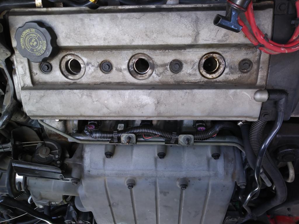

Taper123 Posted June 24, 2018 Author Report Posted June 24, 2018 It's the number 2 cylinder that had oil in it from the upper valve cover gasket. Here's a pic of it. The wire in the back is a challenge to get to. If I took off the upper intake manifold, would be easier to fix, and make changing the rear plugs simpler. That's just my opinion, as I have no manual and am simply guessing. Quote
Imp558 Posted June 24, 2018 Report Posted June 24, 2018 I think that's the oxygen sensor, it's a bitch to get to. Quote

Taper123 Posted June 27, 2018 Author Report Posted June 27, 2018 Replaced the rubber vacuum elbows and the front valve cover gaskets. Runs so much better now. Going to do rear plugs tomorrow, and hope no leaks on that valve cover. #2 had about a half inch of oil in it from te valve cover spark plug gasket/o-ring. Oxygen sensor connection seems like it's working, even if it melted some. It's the connector the oxygen sensor plugs into that had the damage on it. Finding a wiring harness for it might be a challenge, so ill at least put some shrink tubing on it. Noticed after changing front plugs and some vacuum fittings it starts so much easier and has plenty of power again. For an older 4 door sedan... it's what I'd call a sleeper car. Doesn't look like t has the performance that it does. Can anyone point me to a schematic for the drivers side door panel window controls? three out of four windows work, drivers window is intermittent as to if it will go down. Need to wash and wax it and post some pics next. jiggity76 and MemphisMan 2 Quote
Imp558 Posted June 27, 2018 Report Posted June 27, 2018 (edited) Let me look, I think I have a p/n and source for that O2 plug for just a couple bucks. Mouser Electronics has a large assortment of Delphi but you have to know the Delphi p/n to find it. Edited June 27, 2018 by Imp558 Quote
