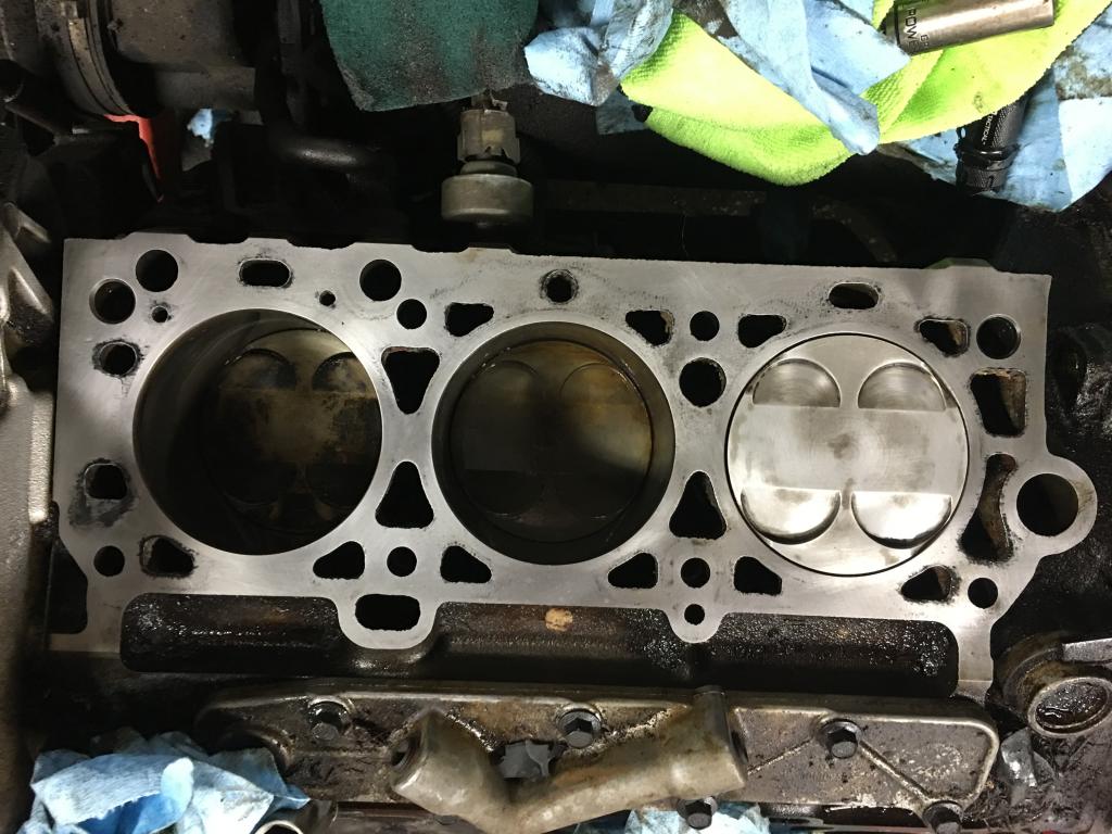

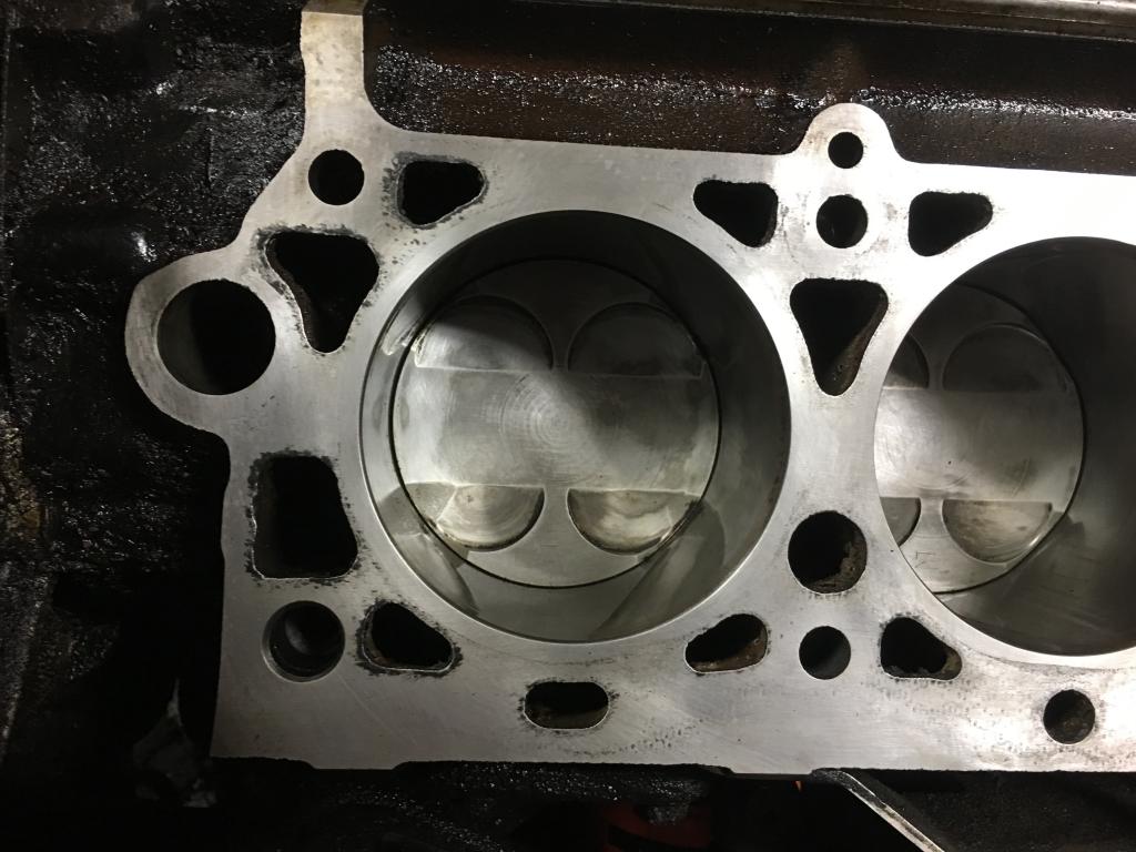

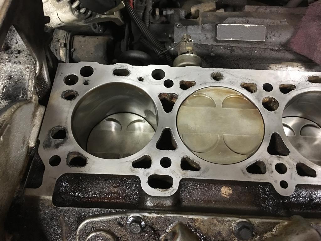

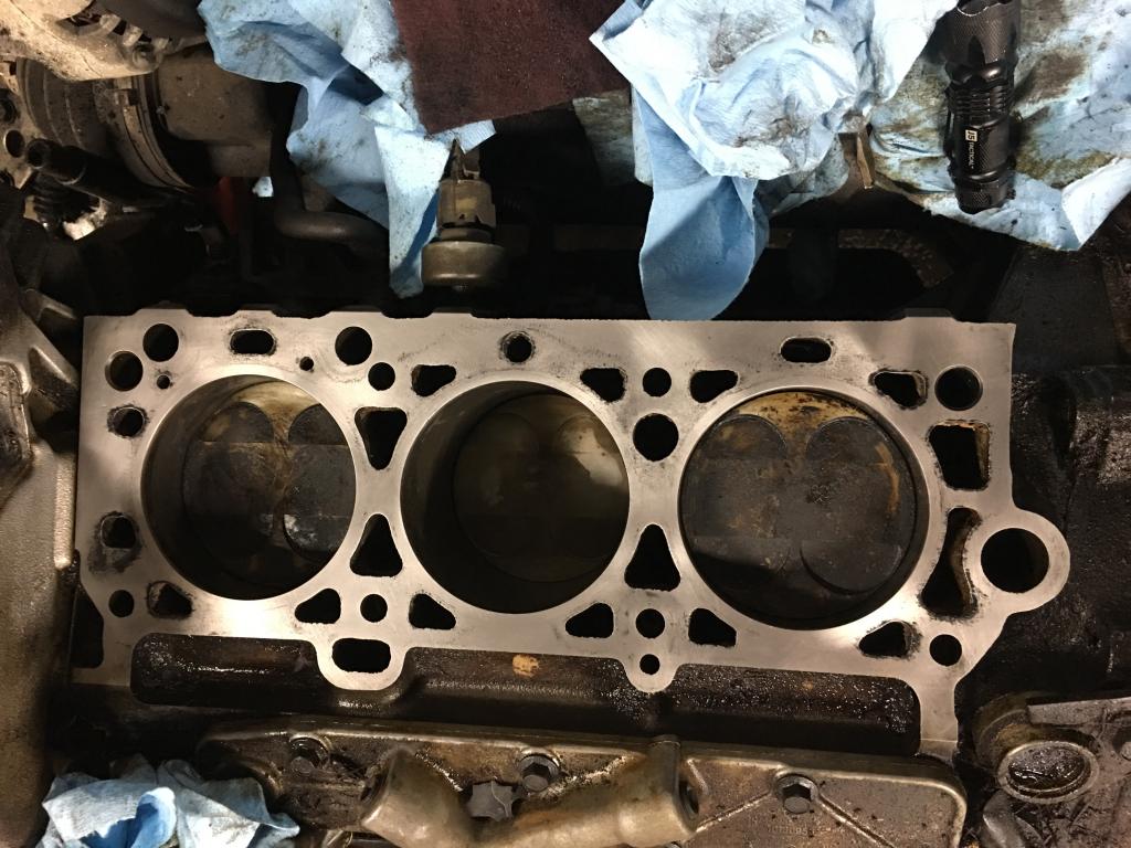

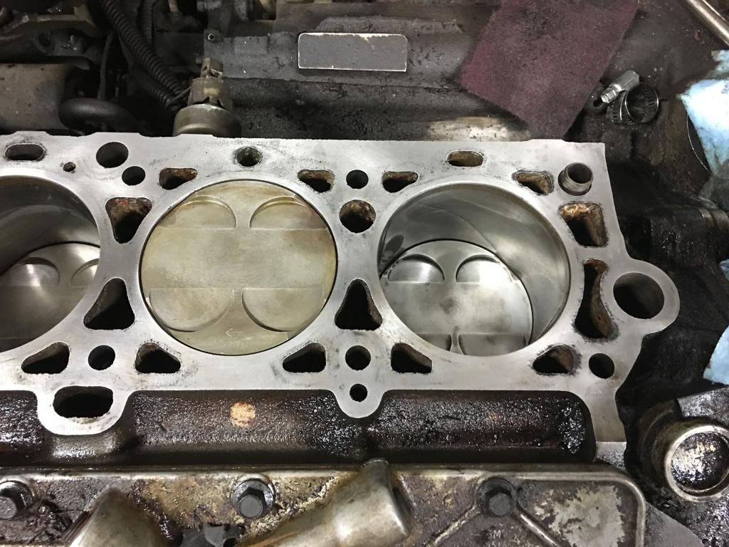

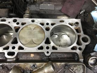

NCTyphoonKid Posted February 10, 2018 Author Report Posted February 10, 2018 Is this clean enough or should I keep going some more? Quote
Imp558 Posted February 10, 2018 Report Posted February 10, 2018 I'd get it all off, acetone should take it from there Quote
NCTyphoonKid Posted February 10, 2018 Author Report Posted February 10, 2018 I'd get it all off, acetone should take it from there I hit it with some acetone and it still has a little bit Quote
Imp558 Posted February 10, 2018 Report Posted February 10, 2018 I can't tell in the picture. Mine came completely clean. There were discolored spots but nothing stuck to them. Quote

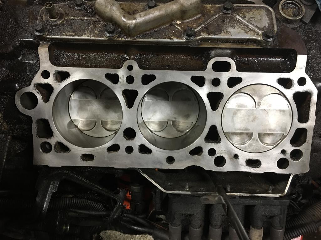

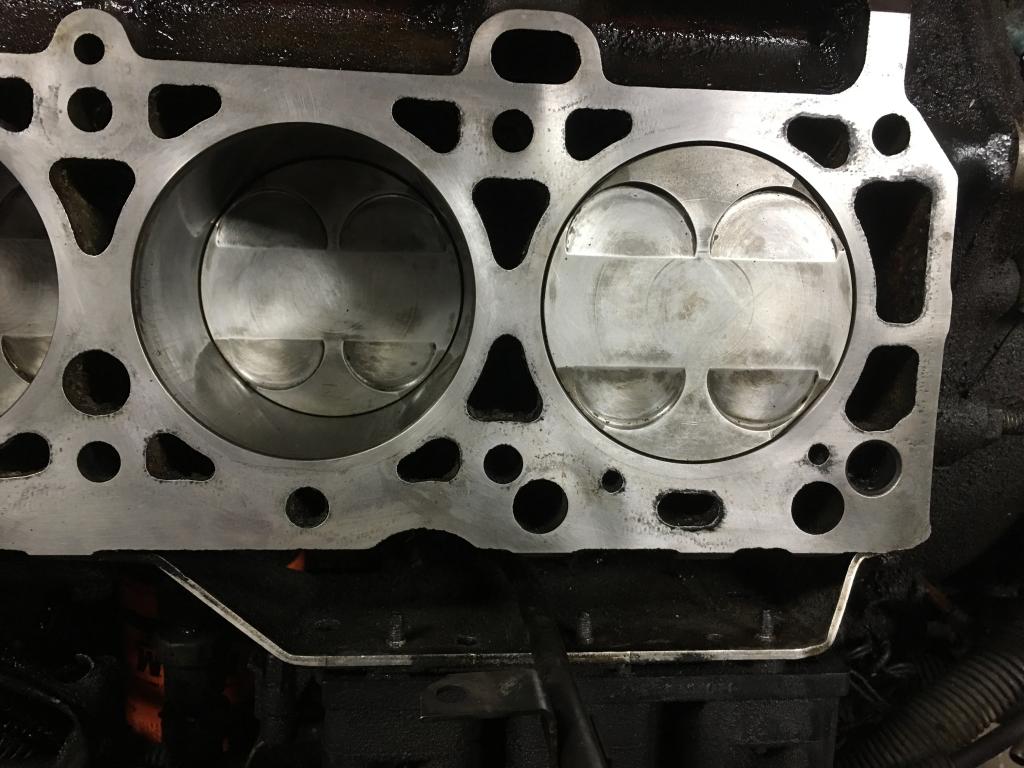

NCTyphoonKid Posted February 11, 2018 Author Report Posted February 11, 2018 Looking pretty good Galaxie500XL and wstefan20 2 Quote
