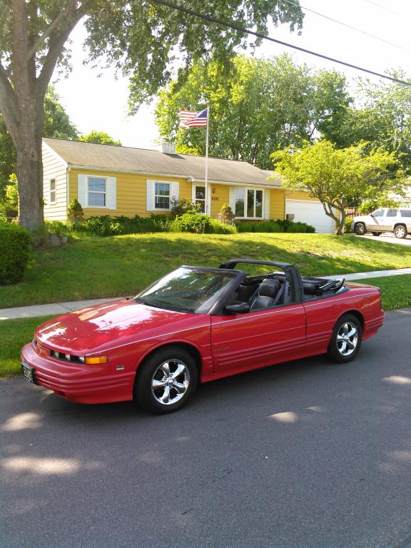

gr_elvis Posted June 13, 2017 Report Posted June 13, 2017 1993 Oldsmobile Cutlass Supreme 4 bucket seat model access to convertible top motor? Quote

kennyb13126 Posted June 24, 2017 Report Posted June 24, 2017 you can access it thru the trunk or by taking the rear seats out Quote
kennyb13126 Posted June 24, 2017 Report Posted June 24, 2017 good looking car....if you need to shop for a new motor and pump I had trouble finding one, so i ended up using one from a 1994 mustang. i had to change the electrical connector, but the hydraulic lines fit perfect. Even the grommets holding it down lined up with the original.. rich_e777 1 Quote
