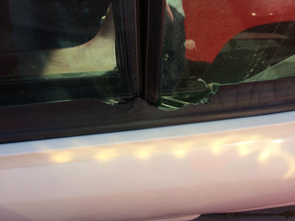

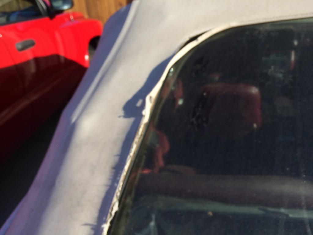

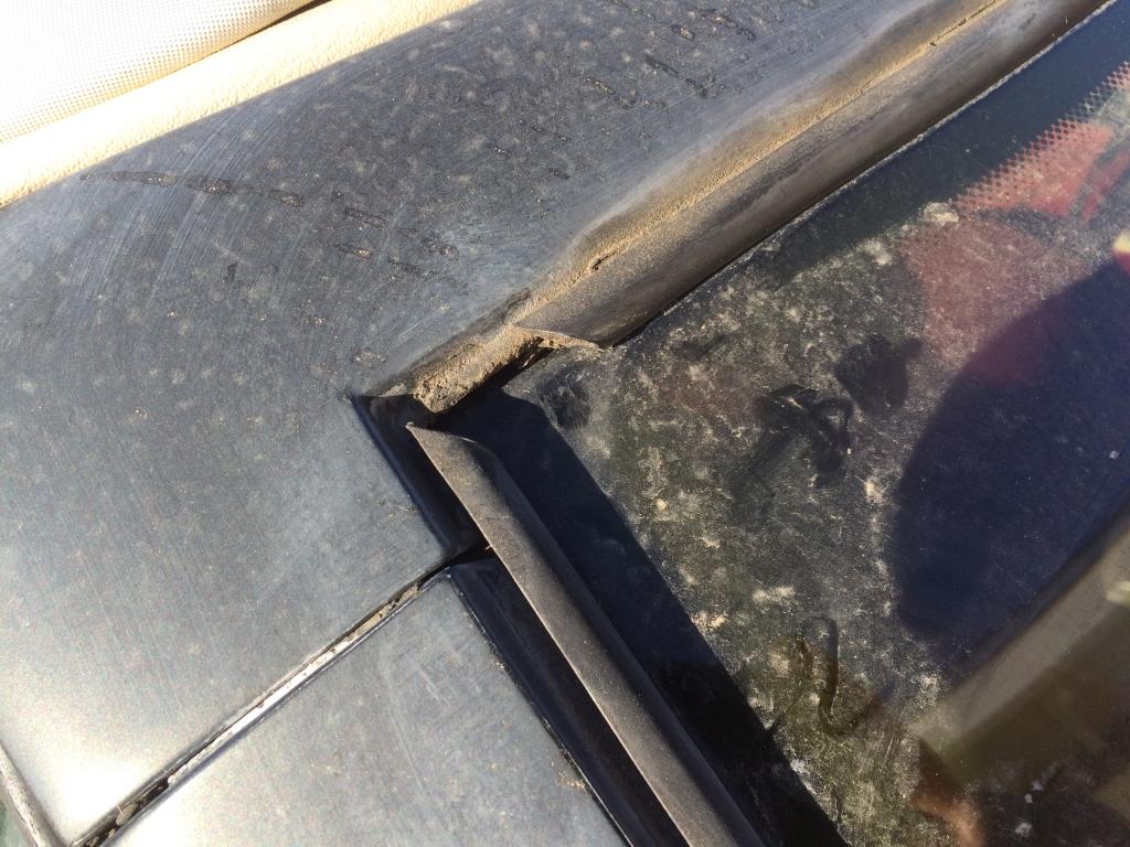

Billyvannuys Posted May 24, 2017 Report Posted May 24, 2017 Top photo, rubber around windshield disintegrating, next; original top on car falling apart, next; classic rubber around rear quarter window problem, bottom: there she is, warts and all. So, here I am oh, I'll say about $5,500 into this car counting $3200 paid for car (way too much, I know), plus new tires, new AC compressor, motor pulled and all gaskets replaced, all new brake parts all around including master cyl. and new ABS pump, but brakes still suck, plus so many other things I've paid for, I can't even remember them all.. The bad- Now needs new top, needs some brake work, brights stopped working, rubber falling apart around all windows on outside of car. I messed-up rims using wrong cleaner and now they are etched. Needs body and paint. Mono leaf may be source of clunking sound when I pull in driveway. Every time I put top down, that weird rubber piece falls off the little side window. Convertible top motor is sounding a little weak. The car has 78,000 miles, but the original owner didn't take care of it and it obviously sat in the sun for a very long time. Wife hates car, gets mad at me every time I put money in it. The good- car starts at the flick of the key, tranny feels great, AC blows cold. Has only 78K miles. no rust. only two tiny dents on car. All lights and gauges and do-dads work perfectly. Interior is in fair-good condition with no rips and little wear on red leather seats but some seams are coming loose. In the 17 months I have owned this car, I have never seen another one on the road and I live in Los Angeles County. I am basically neutral-heading-towards-bailing on car at the point. It has put me through so much hell I have never really had much fun with it. So, what am I looking at here for a new top, new paint, fix brakes, fix rubber parts? About another $5K? Wow! This is what happens when emotions take precedence over logic. Oh, yeah, there are no junkyards within 90 miles of me that have any parts for this car. I can probably fix the bottom exterior rubber pieces around rear top area myself because you guys have provided enough instructions and I know someone on here sells them. Otherwise, all other repairs will have to be done by a professional. So, should I stay or should I go? What would you do? I know there are likely no idiots like me out there (not you guys) to pay what I paid for this car. But, if I keep it, I want paint, top, brakes, rubber pieces, brights, smooth rims, blah, blah, blah. Quote
Imp558 Posted May 24, 2017 Report Posted May 24, 2017 Chinese Matt has a fix for the weatherstrips, he mods a more readily available one. The other rubber parts I imagine a 'vert guy will comment on but if they aren't available I personally would pull a piece off and walk a wrecking yard looking for something similar. There was a story about soaking stuff like that in tranny fluid to restore it a while back. Also taking them to your local body supply, they may be able to match it up with something. The wheels are no big deal but they will cost you a weekend of your life. It's nice to have them broken down first but Epoxy paint stripper (rubber gloves involved for damn sure) some of those nylon plastic wheels and buffing wheels from HF and they can be stripped down to aluminum and polished really nicely. My X-Laces had really bad clearcoat on them and I gave up a weekend of my life a while back. There's actual wheel paint out there too if you wanted to paint the center parts white after stripping and buffing. The high beams aren't an issue, members here can give you guidance and help troubleshoot that when you're ready. I have schematics for it, as do others. The top is a problem and as another member is finding out now doing it at home is possible but is a huge amount of work. If it's not your daily driver perhaps put the top down and keep it in the garage as a sunny day car so you can enjoy it for a while. Of course you just said you did an AC compressor but... tonytoca_87 1 Quote
rich_e777 Posted May 24, 2017 Report Posted May 24, 2017 Here is the source I found a shop to do mine. https://www.topsonline.com/model/Convertible_Tops_And_Accessories/Oldsmobile/1992_thru_1995_Oldsmobile_Cutlass_And_Cutlass_Supreme.html To fix the rubber piece in the first pic the windshield will need to be removed and new weather stripping put in. A fairly easy fix if you have the right tools or a windshield repair shop can do it for you. Since the windshield is still intact it shouldn't be that much. Forget the rims and plan a trip to a yard and find some 5 spoke or similar rims on a W-body. I had those same ones one my coupe and switch to 2nd gen GTP rims and it made a hell of a difference. Those things weigh a ton. When you say all new brake parts I think literally every thing related to the braking system all the way to the manifold vacuum. Decent pads, rotors, hardware, replace old fluid and bleed air. If everything was replaced properly the brakes shouldn't suck. Maybe you need to find out if the vacuum going to the booster sucks like its suppose to. tonytoca_87 1 Quote
Imp558 Posted May 24, 2017 Report Posted May 24, 2017 Here's the cables a little cheaper: http://www.hydroe.com/Oldsmobile-Cutlass-CONVERTIBLE-TOPS-POWER-WINDOW-PARTS-p-121.html Quote
95whitevert Posted May 24, 2017 Report Posted May 24, 2017 I feel your pain... I just had a lot of that stuff replaced, I am lucky that I have a family member who owns a body restoration shop. The windshield rubber was replaced with rubber from a town and country van, it matched up the best from the samples we found. I think I paid ten bucks for it. I used a mod found in the forum for the back windows. It worked pretty well. A little modification was needed but now they look great. I had the top replaced by an old timer a few years back. I was told it was a bear to do so I took it to a retired professional. Should have had the convertible top motor replaced when the top was being replaced, the motor crapped out two years ago and it was a pain to replace. I am also lucky my wife actually likes the car so all the money I have sunk into the car isn't used against me (yet). Oh and the brakes on my vert are pretty weak, I had the master cylinder/pads/rotors/lines replaced and bled and re-bled and they still are weak. Haven't replaced the booster yet.... tonytoca_87 1 Quote
