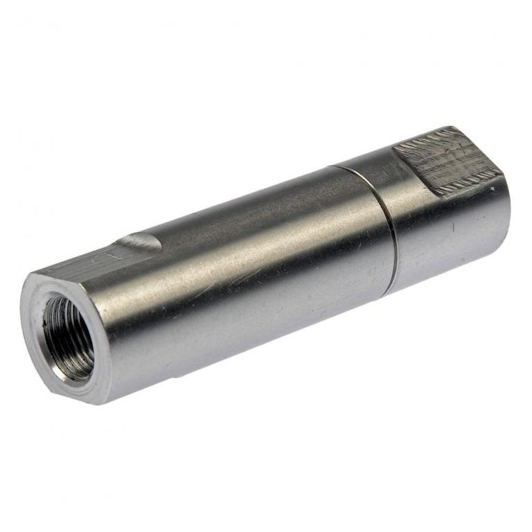

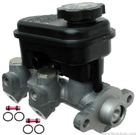

Imp558 Posted November 13, 2017 Report Posted November 13, 2017 I was going to start a new thread but this is along the same lines and the information could still be useful here. Eliminating ABS, in my case not a PM III, I'm going to an earlier non-ABS MC, the ACDELCO 18M672. In the image there are two doodles that I can only imagine are prop valves to slide into the ports for the rear. It was said in another thread there is proportioning done internally. My theory is these are supplemental to be added if the vehicle has rear disk brakes but I'm hoping these are the internal prop valves and not supplimental. In my application I'm running second Gen brakes all around, on a second gen the prop valves for the rear are inline, the Dorman P/N is 905952. It has me wondering if in my application, or another first Gen doing a big brake upgrade if the Second Gen rear prop valves wouldn't be a better idea if the ACDELCO 18M672 internal prop valves are those removable things? It stands to reason we may be able to leave those doodles out and use the Second Gen prop valves to have it be more or less correct for the bigger brakes. Anybody have any input? Quote
