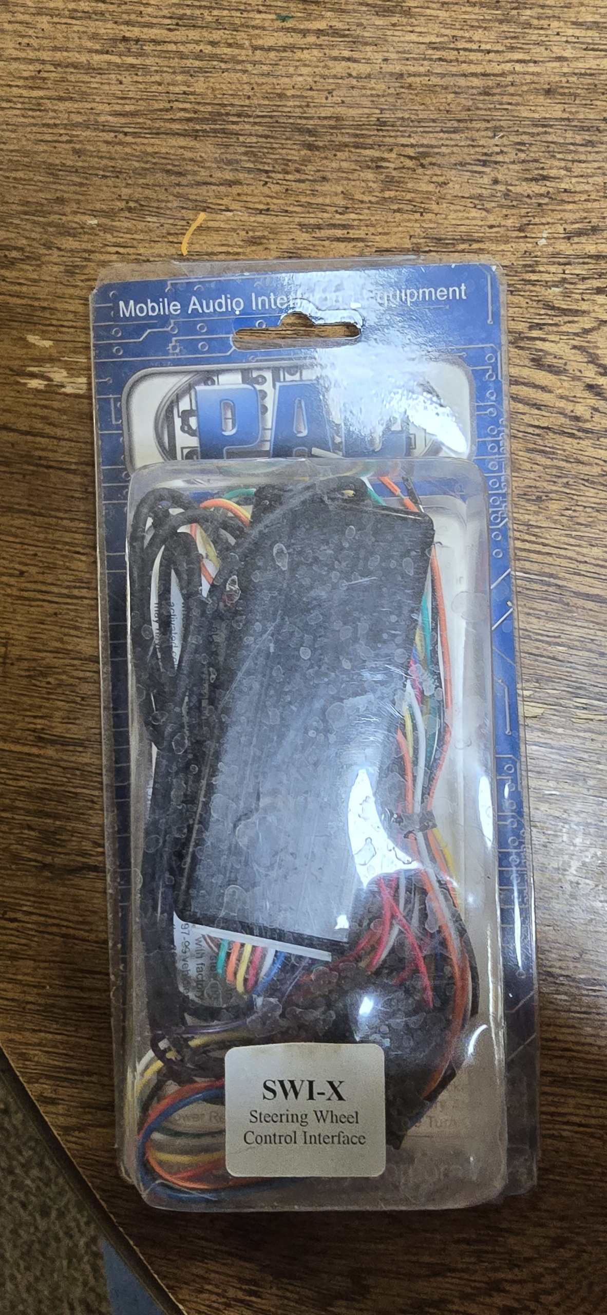

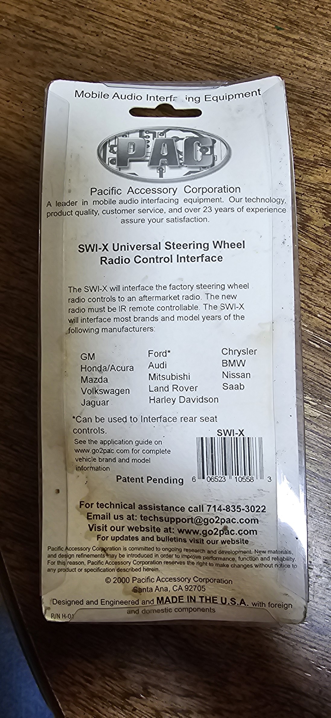

Nick727 Posted May 2, 2024 Report Posted May 2, 2024 can someone post a link(s) or part #'s or the exact type for SWC adapter for my 93 cutlass. I'm having no luck finding one. Thanks Quote
Pontiac6KSTEAWD Posted May 9, 2024 Report Posted May 9, 2024 (edited) I know I have one NOS in my my Parts Stash, and theres another member wanting to buy some parts out of that box... I just gotta find it in my garage.. Kids... Dont hoard stuff.. When you want something, you will NEVER find it! Edited May 9, 2024 by Pontiac6KSTEAWD jiggity76, ManicMechanic, rich_e777 and 2 others 4 1 Quote

Pontiac6KSTEAWD Posted June 21, 2024 Report Posted June 21, 2024 I got to the box last night, after removing a bunch of garage crap (lawn mowers, snow blowers, etc).. I did not open the box yet.. Quote
Pontiac6KSTEAWD Posted June 22, 2024 Report Posted June 22, 2024 Check your PM.. Sent you a message about it. Quote
