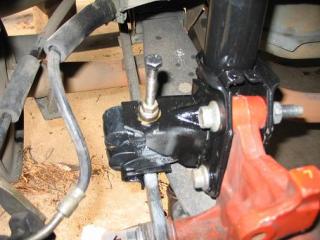

95GS Posted August 8, 2016 Report Posted August 8, 2016 When I bought new rear struts, they came with 2 identical bolts - each approx. 3" x 1/4" - for compressing the auxiliary dampers (connected to rear lateral links) while changing the struts. I neglected to keep/misplaced these bolts. Now that I'm changing the cross member (95 Regal), I see these bolts could be useful. Does anyone know the length/diameter/thread pitch of these bolts? Quote
ron350 Posted August 8, 2016 Report Posted August 8, 2016 On my 96 I used a 6 inch long 3/8 x 16 threads per inch allthread bolt. http://www.w-body.com/topic/45786-96-rear-struts/?hl=strut rich_e777 1 Quote
mfewtrail Posted August 8, 2016 Report Posted August 8, 2016 M10 x 1.5 x 90mm in length is the provided bolt that comes with Monroe and other struts. rich_e777 and Imp558 2 Quote
95GS Posted August 8, 2016 Author Report Posted August 8, 2016 Great - thank you both for these timely answers (+ link & photo!). Nice paint job. Yes, they are Monroe Sensa-tracs from Canadian Tire. I wasn't aware these were the softest ride, but apparently OEM replacements, and work for me. The previous set froze solid at the end of one winter, when temps dipped low. Not soft at all. Quote
ron350 Posted August 8, 2016 Report Posted August 8, 2016 Woops, if a 10 mm x 1.5 threads in to the hole then I am wrong and used the wrong bolt. Quote
mfewtrail Posted August 9, 2016 Report Posted August 9, 2016 Woops, if a 10 mm x 1.5 threads in to the hole then I am wrong and used the wrong bolt. It was obviously close enough to work. . To the thread starter: Something longer than 90mm might be better for you if you have no bench vise or other method of getting them compressed enough to start the bolt. Quote
95GS Posted August 9, 2016 Author Report Posted August 9, 2016 Yes it was close enough to work for Ron, but the available choice for me (3/8 threaded rod) only caught on one side. So switched it to the other side, now neither will hold. LOL Perhaps I made the mistake of cleaning out the holes. Then checked that M10 is indeed a little larger than 3/8, so both sides are a little stripped out. Will get some (long) M10s later today. Or the next size to hold. Not a problem. Thanks both - great tips, good intentions Quote
