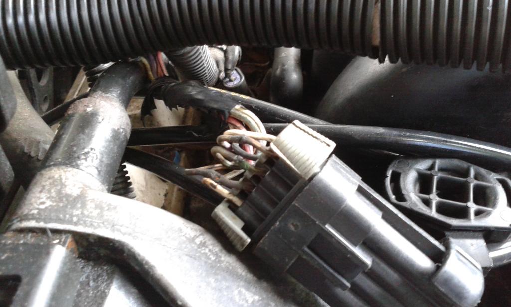

Yall know what? I did cross 2 plugs on the back of the engine. I swear, I swear, I swear. Nope, I messed it up. Of course it would be on the back of the engine. I was irritated with reaching my hand back there trying to find what plug they went on. Once the cross was addressed the car smoothed out but still had an obvious miss.
What was causing the miss? Something else I would have overlooked if my Dad was not there. It's in the picture below. The exposed wire and melted insulator were on top of a hose clamp and that was shorting out my spark and not getting fire to the 2 rear plugs. The wire has since been taped up with electrical tape to keep the wire insulated and off any ground.
I about threw my work table across the yard after seeing this. They don't call it "Fool Injection" for nothing.
I'm glad the car runs well now. I was about at my end with diagnosing this.
Code 26 must be something small because it's not the brake light switch or the torque converter switch. It has to be something stupid making it come up too. Guess I'll figure it out later on.
Link to comment
Share on other sites
Some fucking jackass supermechanic nicked all of those wires because he wasn't smart enough to stick a probe or safety pin past the seals in the plug.
Anyway I'm glad you found it, nothing beats a good visual inspection.

Thanks. I was wondering why it was suddenly missing as bad as it was. Part of it was my inexperienced self and the other part was the wiring on that connector. If it was just me figuring this out I would have gone insane trying to find it.
