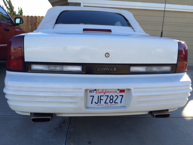

Billyvannuys Posted February 15, 2016 Report Posted February 15, 2016 Had car 10 weeks. If I had known this much about them before I bought, I might have picked another convertible. the freaky rear suspension is clever but but prone to bushing problems. The doors are too heavy for the flimsy hinges and pulls, engine too small, steering column and associated controls and buttons needed all kinds of replacing, ordering stuff online, going to wrecking yards. The way the top with the little folding windows matches up with the rear quarter windows is a terrible design; leaks, impossible-to-find moldings shot. Buddy replaced all brake parts, but brakes still feel like a '54 Pllymouth. Going to have to go to real brake guy to figure out why they don't feel like power brakes. Appears I have a power steering fluid leak that mechanic buddy having hard time finding. Horn started blaring the other night for no apparent reason and neighbor pounded on my door, had to remove the damn underhood cross-brace to pull the fuse. I think I'll name this car "Christine", although, unlike that demonic car, this one doesn't fix and improve itself. Plus, they're not very popular cars so few aftermarket parts made for them. Right before I bought this, I was looking online at a slightly hot-rodded '65 Cutlass convetrtble that was in my price range. I bet I can find parts for that easier than for this car. Also liked the Pontiac G6 convertible at a local dealer, but that would have required a second car payment (already have payment on truck). Okay, that's my rant. I didn't intend for fixing this car to be a part-time career needing supernerd research capabilities, I don't know really what I expected, but I'm in now and there's really no going back. You guys will probably tear into me for this, or just snicker at the stuff you all already know by now. Man, that red G6 vert sure did look good. Quote
