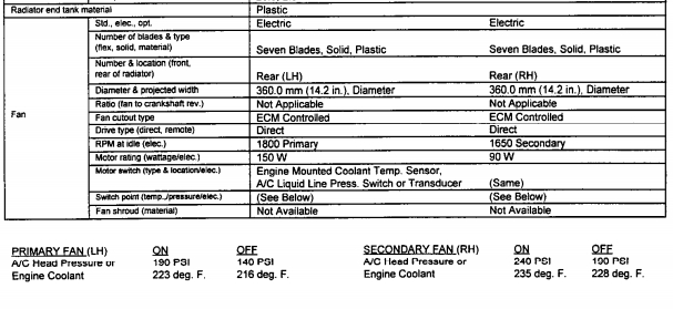

1979lee Posted May 1, 2014 Report Posted May 1, 2014 driver's side fan is the primary.passenger's side fan is the secondary. really? on my 97 3100 lumina,the pass side fan mooves WAY more air....strange both blades look the same, but the motors are different. i'd like to swap out the slower fan for the faster pass side fan... did any W's come with better cfm fans? Quote

Galaxie500XL Posted May 2, 2014 Report Posted May 2, 2014 Since you say the passenger fan moves way more air, and the driver's fan is the primary, it could simply be since the driver fan is used most of the time, it's gotten "tired". Over the years, I've replaced far more fan motors that were working, but not moving enough air, than I have replaced that didn't work at all. really?on my 97 3100 lumina,the pass side fan mooves WAY more air....strange both blades look the same, but the motors are different. i'd like to swap out the slower fan for the faster pass side fan... did any W's come with better cfm fans? Quote
1979lee Posted May 4, 2014 Report Posted May 4, 2014 Since you say the passenger fan moves way more air, and the driver's fan is the primary, it could simply be since the driver fan is used most of the time, it's gotten "tired". Over the years, I've replaced far more fan motors that were working, but not moving enough air, than I have replaced that didn't work at all. Yes the pass side moves more air. i did the "feel test" when the car was just started from cold. warm outside with the a/c on max. and yes the drivers side was less. now when i checked on a hot day they were closer but not the same. aka pass side more flow than left. i have a pdf file from gm, (1998 lumina l82) see attached pic. it does indeed show lh or drivers fan to pull more air... , well time for a new lh fan! thanks everyone:thumbsup: Quote
