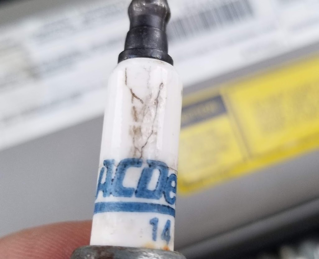

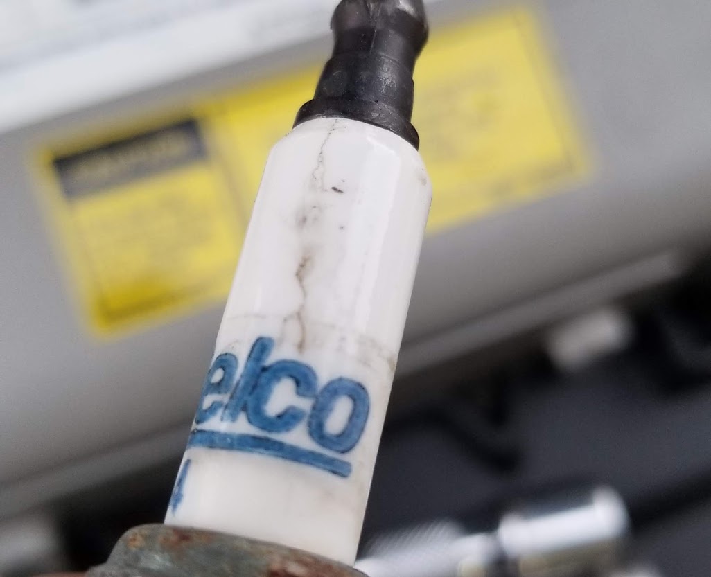

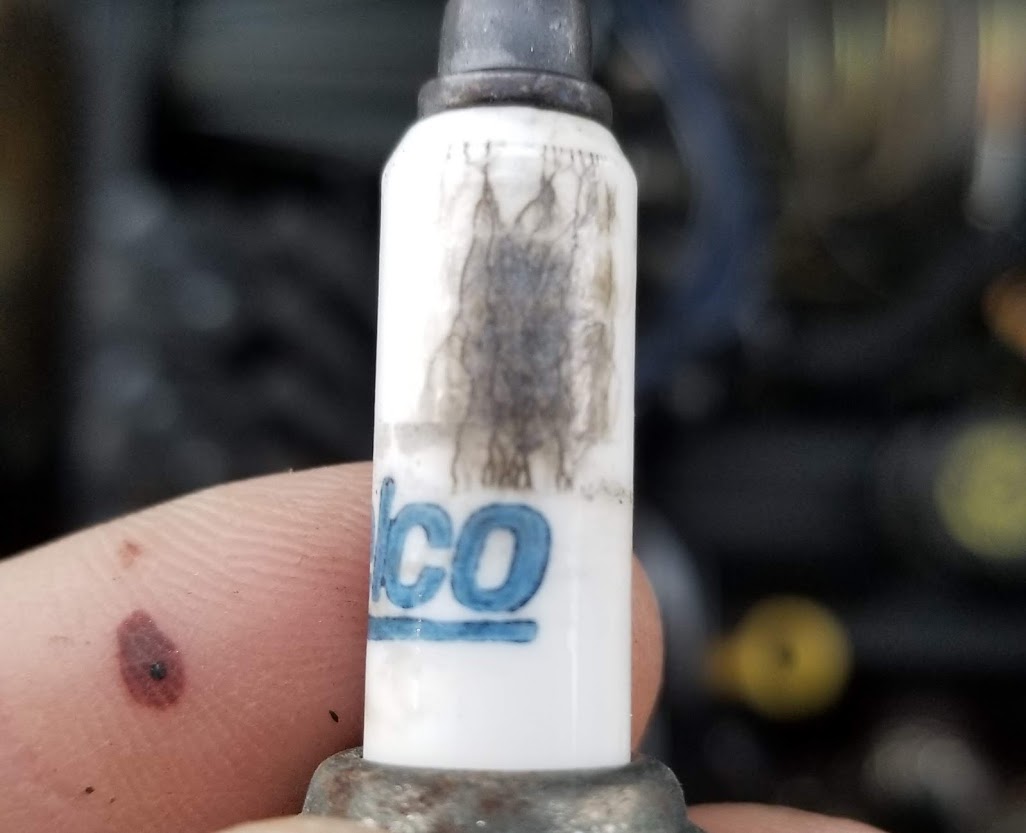

Jim_rockford_007 Posted April 29, 2021 Report Posted April 29, 2021 These came out of My Lumina that was having a bad stumble after the Engine swap. front 3 Quote
Schurkey Posted April 29, 2021 Report Posted April 29, 2021 (edited) Remember, thousands of years ago, when spark plug porcelains had "flashover ribs" to reduce that sort of problem? Now, plugs are smooth-sided. You found out the hard way what happens next. I guess the plug engineers managed to shave off half-a-penny by producing plugs with no ribs. Thank God for progress! Another reason that dielectric silicone grease is essential. Edited April 29, 2021 by Schurkey Quote
