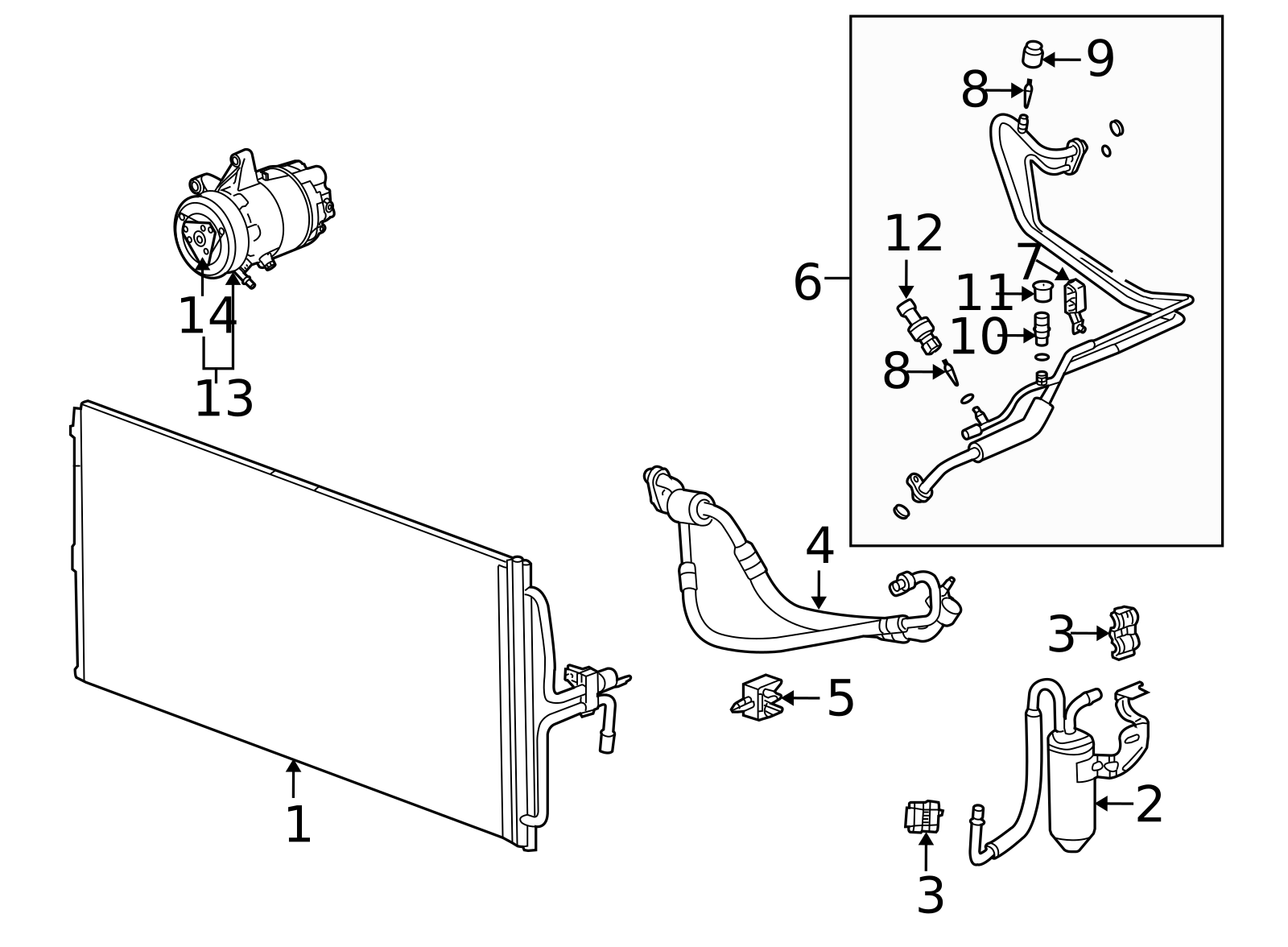

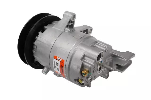

Quaraxkad Posted December 14, 2025 Author Report Posted December 14, 2025 (edited) A CVC compressor used in 04-08 and 09 LaCrosse 3.8L is a completely different mounting design from *all* the others posted above. I bet none of the others would even fit. And looks to have very different fittings on the back... This is an 04 Impala SS diagram: Edited December 14, 2025 by Quaraxkad Quote
55trucker Posted December 14, 2025 Report Posted December 14, 2025 12 hours ago, Quaraxkad said: A CVC compressor used in 04-08 and 09 LaCrosse 3.8L is a completely different mounting design from *all* the others posted above. I bet none of the others would even fit. And looks to have very different fittings on the back... I see, but the powertrain you have in the car is from the same 04 Impala?......so the a/c compressor mounted to that block would be the cvc unit....and that's what currently still mounted to the engine?.....if you've removed the compressor what are you using for a pulley to take the place of the compressor? Quote
Quaraxkad Posted December 14, 2025 Author Report Posted December 14, 2025 Yes, there is currently the original 04 Impala compressor installed, but I will need to replace it. It's been disconnected from the lines for years since the initial swap and the inlet and outlet have not been plugged, who knows what kind of gunk has gotten in it. So I am replacing *everything* except (if I can avoid it) the evaporator. Quote
Black92GS Posted December 14, 2025 Report Posted December 14, 2025 13 hours ago, Quaraxkad said: A CVC compressor used in 04-08 and 09 LaCrosse 3.8L is a completely different mounting design from *all* the others posted above. I bet none of the others would even fit. And looks to have very different fittings on the back... This is an 04 Impala SS diagram: One thing to be careful of there is that 2004 was a bit of a transitional year. A 2004 Lacrosse is a 3rd gen W and came with the 3800 series 3, while the 2004 Monte/Impala was still a 2nd gen and came with the 3800 series 2. Compatibility wise, you’re very much going to be stuck running a compressor compatible with a 2004 Monte SS if you want any hope of things functioning properly. The other potential gotcha is that 2nd gens also ran a BCM. There is a possibility that the PCM requires input from the BCM in order for the AC compressor to run correctly in the first place. 92Lumi 1 Quote
