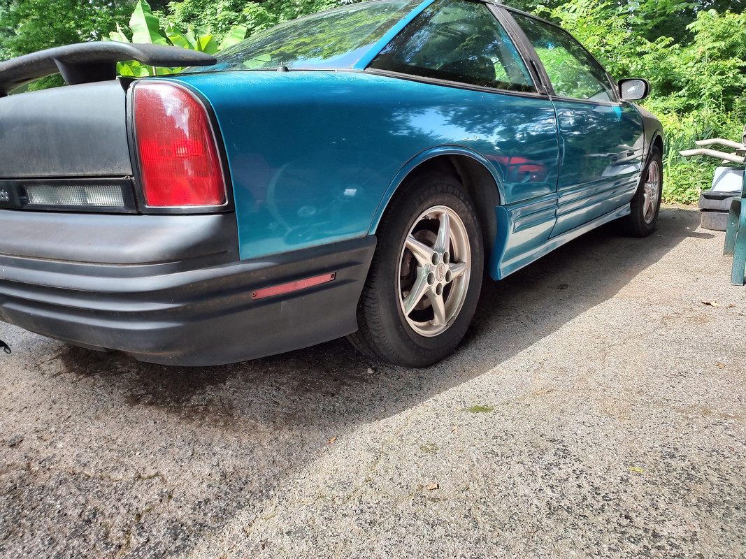

Taz1959 Posted June 16, 2025 Report Posted June 16, 2025 I have a 97 Chevy Lumina LS with 16" aluminum wheels a guy has 1999 Pontiac GT 16" wheels for sale can I put them on without any problems I made the mistake of buying 4 wheels from a Pontiac Grand Prix from 2002 and found out the wheels hit the front calipers. Tire man said to get them on I needed spacers which I think would be dangerous. My brother said threads are not gonna reach bolts to snug with spacer on. Quote
pwmin Posted June 16, 2025 Report Posted June 16, 2025 Which 2nd gen W wheels? Offset is a lot more positive on the 2nd gens than 1/1.5G, so they'll sit in farther. They usually "fit" IME, but obviously not always. I like it the other way around (1G wheels on 2G's) Quote
55trucker Posted June 16, 2025 Report Posted June 16, 2025 '99 GP is the same suspension platform as the '02..........you'll be SOL pwmin 1 Quote

55trucker Posted June 17, 2025 Report Posted June 17, 2025 Any stock wheel from the Gen 1/1.5 family, the car fitted with drums at the rear? Quote
pwmin Posted June 17, 2025 Report Posted June 17, 2025 Stock is +25mm 7" wide (8" for "crosslace" wheels like in 55trucker's attachment) for 1/1.5, +43 for 2/3. Anything +25mm, 5x115. You can use spacers if you put in longer wheel studs. Quote
