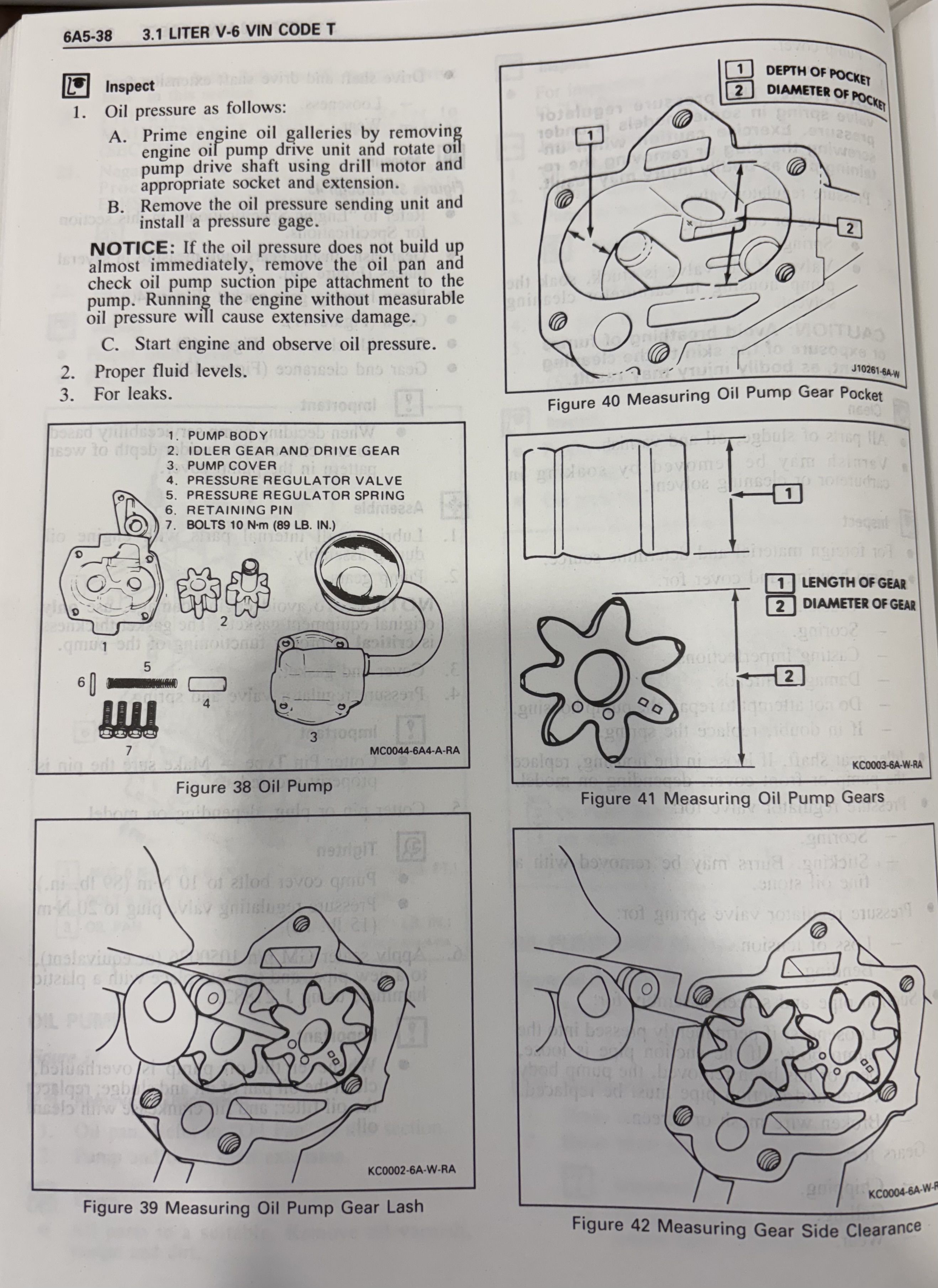

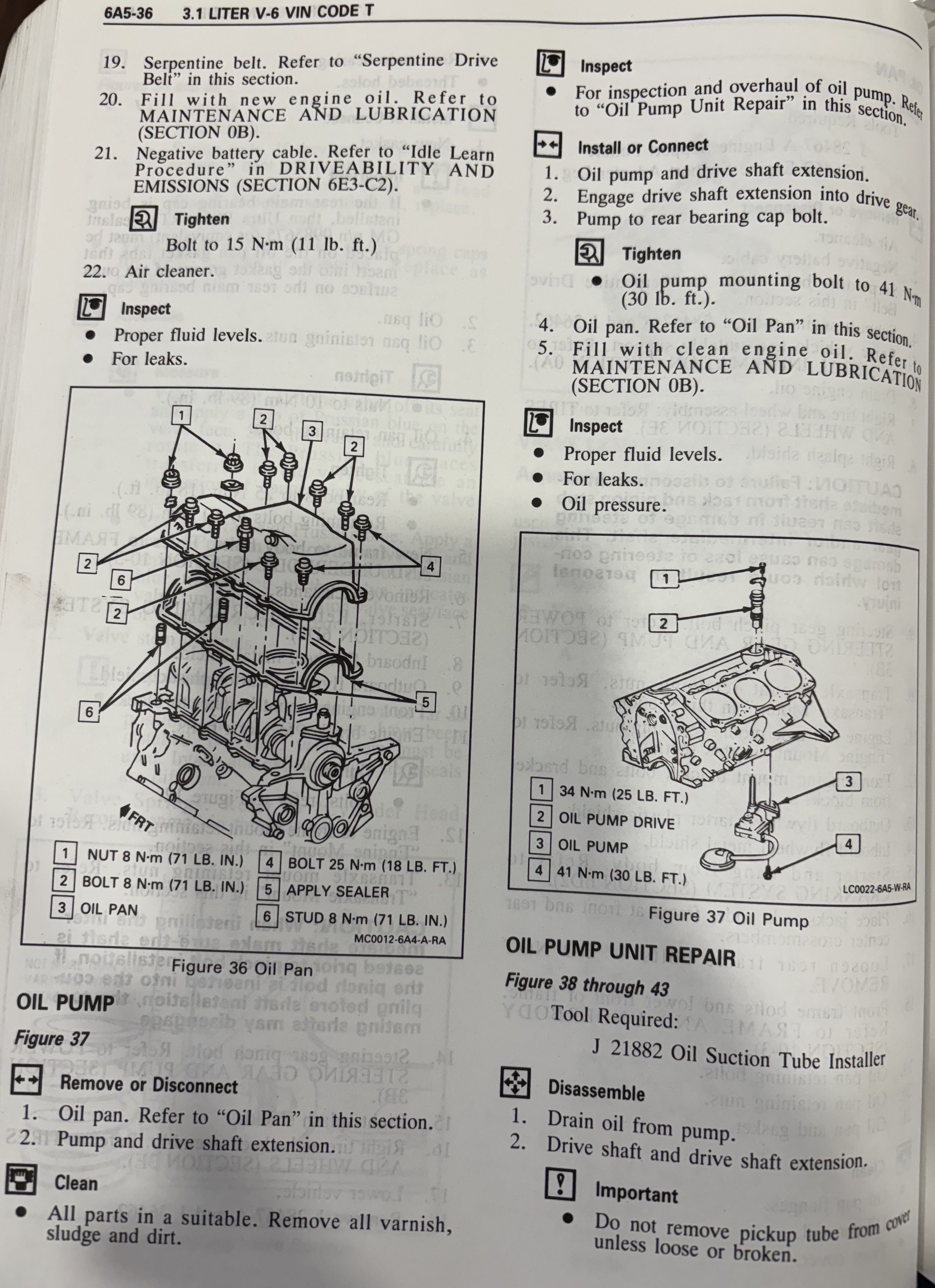

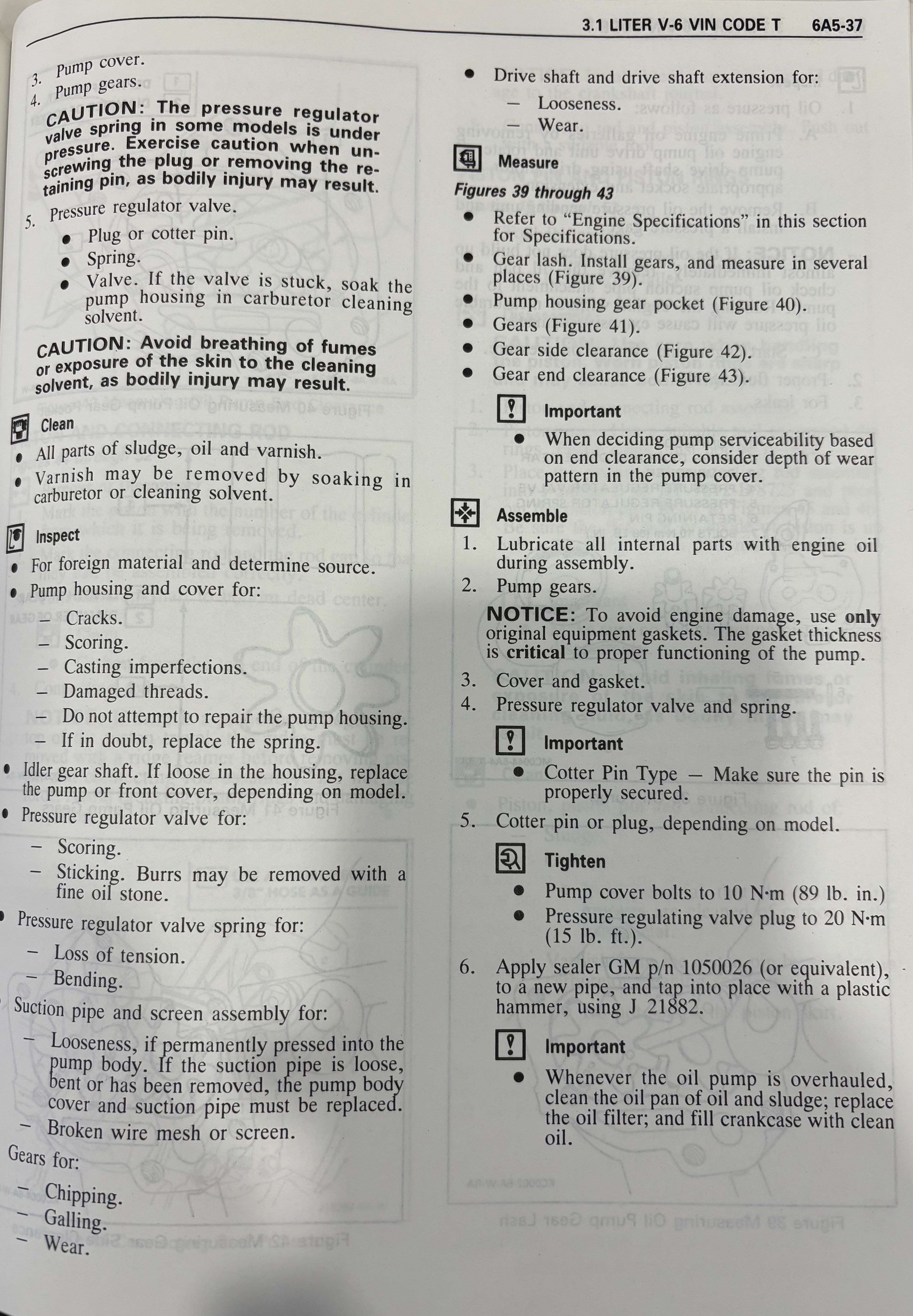

Black92GS Posted March 28, 2025 Report Posted March 28, 2025 Here’s the 3.1 L oil pump section from my 92 Regal FSM. It also lists the oil pressure spec for the 3.1 at 15psi at operating temp @ 1100 RPM. I’d assume that is a minimum spec, rather than being absolute. Quote
Terry K Posted March 30, 2025 Author Report Posted March 30, 2025 (edited) On 3/28/2025 at 1:23 PM, Black92GS said: Here’s the 3.1 L oil pump section from my 92 Regal FSM. It also lists the oil pressure spec for the 3.1 at 15psi at operating temp @ 1100 RPM. I’d assume that is a minimum spec, rather than being absolute. Yeah, it looks like the relief valve is on the oil pump. From what I remember about my car, there is no way to reach all the pan bolts without dropping the dropping the sub-frame. But I need to look again cause that doesn’t right…and I really hope I’m wrong. Edited March 30, 2025 by Terry K Quote
