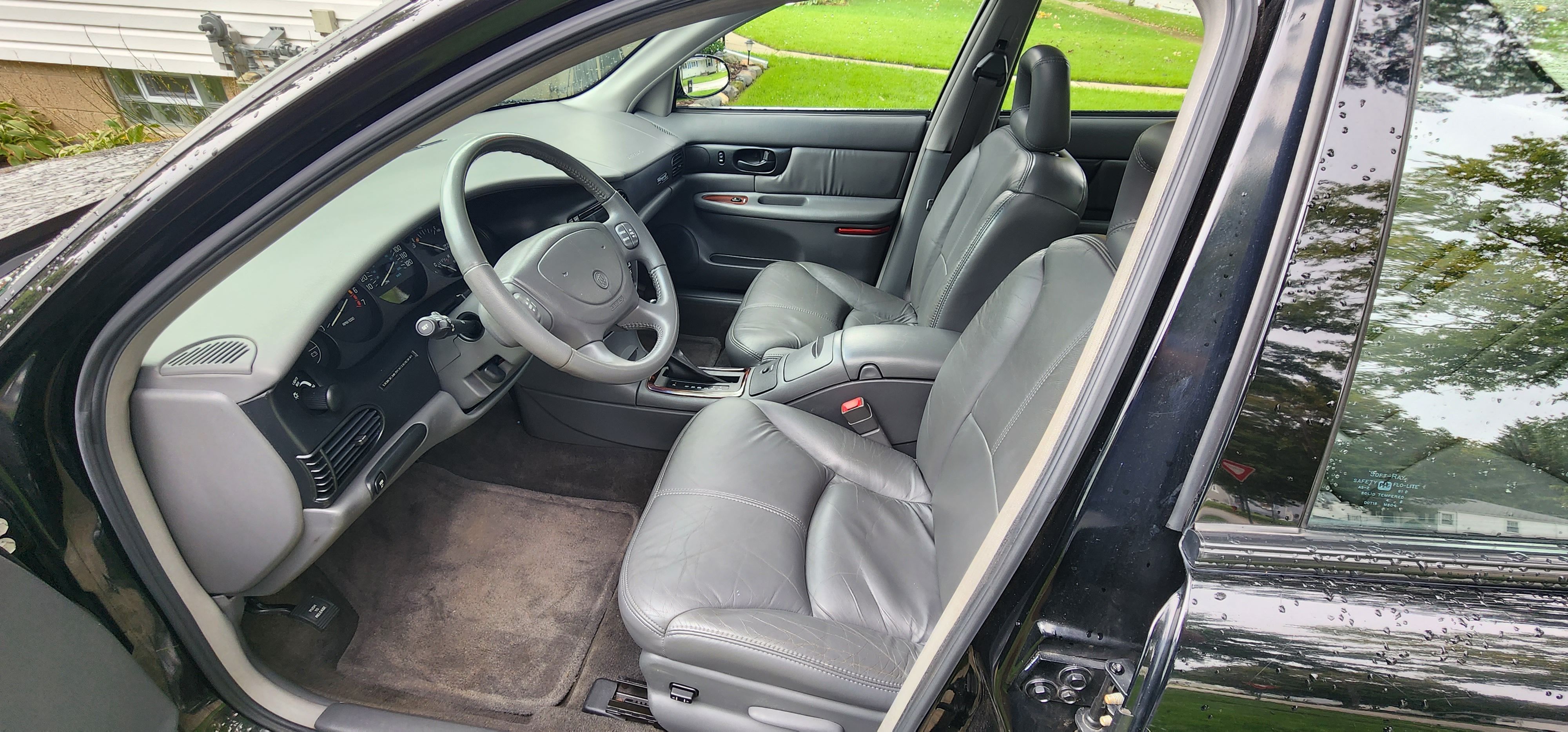

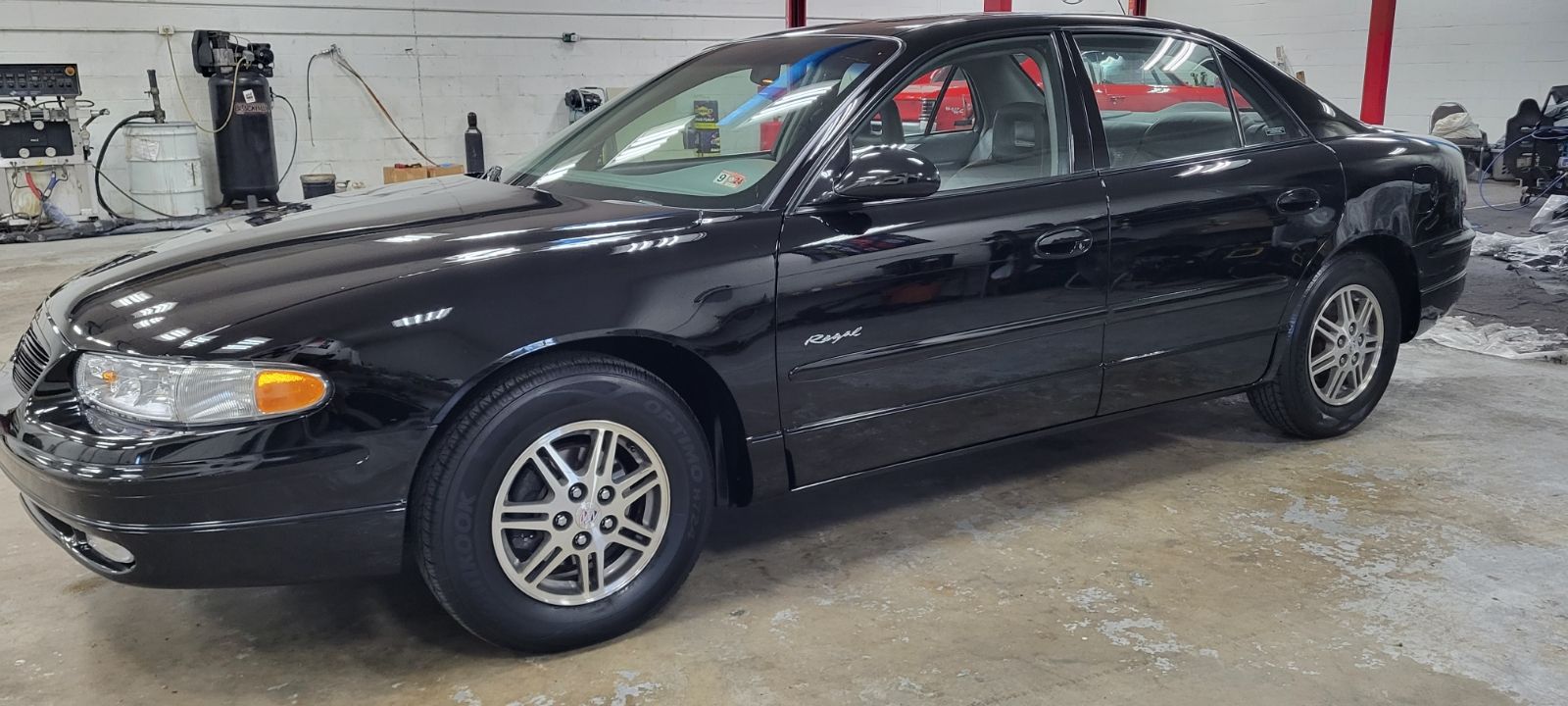

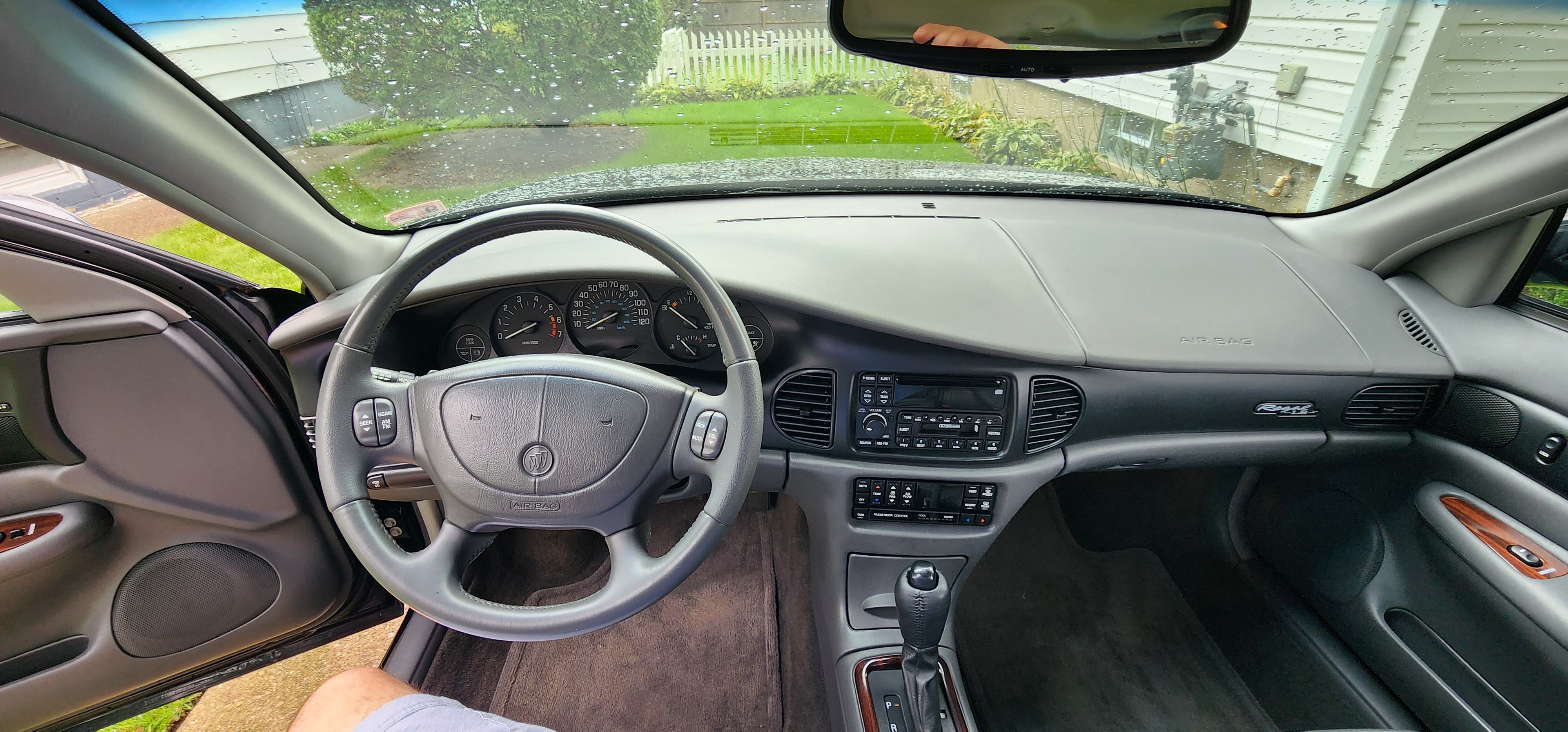

kielu84 Posted January 16 Report Posted January 16 Hello, everyone, I’m hoping someone can point me in the right direction. I recently purchased a low-mileage 2001 Buick Regal LS to use as my daily driver, and it’s been a fantastic car so far. Lately, though, I’ve run into an issue where the starter doesn’t engage when I turn the key. If I move the console-mounted shifter back and forth or shift it into neutral, the car will start. Based on this, I suspected the neutral safety switch (mounted on top of the transmission) might be the culprit, so I replaced it. Unfortunately, that didn’t resolve the problem. I don’t think the issue is related to the anti-theft system or the ignition key, but I could be wrong. Has anyone experienced something similar or have any suggestions? Thank you 94 olds vert 1 Quote

kielu84 Posted January 16 Author Report Posted January 16 It's called a neutral safety switch, according to Rock Auto, where I ordered the part. I was thinking the cable linkage connected to the safety switch might need adjustment. I don't believe the starter is the issue, as that wouldn’t explain why moving the shift lever makes it start when it initially doesn’t. It all boils down to when it wont start, if I just move the shift lever through the gears and into neutral, it starts every time. It hasn't done it in a couple of days now. Quote
