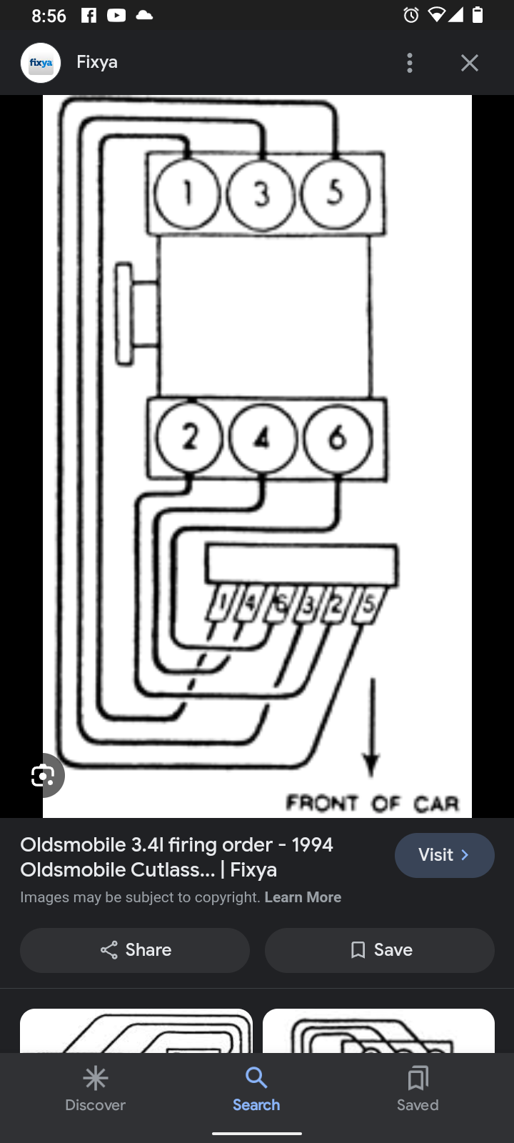

j_train5344 Posted March 25, 2024 Report Posted March 25, 2024 Alright guys, got the 93 cutlass vert as some of you may have seen. Got 107k miles on her and ran tip top...except I had white smoke from under the throttle body and had timing belt fragments all over behind the covers. I changed the timing belt per Memphis man's how-to video and it worked like a charm. Thanks for that! My initial startup following was lackluster thanks to a dead battery but it did run although briefly. Pulled the battery to charge and a 1 1/2 wks later (northern Indiana weather, ugh) changed the uim, lim, and valve cover gaskets. Also did plugs and wires. Thermostat too. Might as well right?? Reinstalled battery. Crank no start!! Fuel pump has prime. Fuel check valve gives a spray followed by burbles of fuel. Cam flats are down at tdc on the front bank. Pulled the valve cover to confirm. Didn't check the rear because I don't want to undue/redo the upper if I don't have to. Also, nothing moved when doing the timing belt. Plug wires are seated properly with locking clicks at all plugs/coils. Attached is the diagram used. She sputters intermittently like she wants to start. I need help!!! Quote
