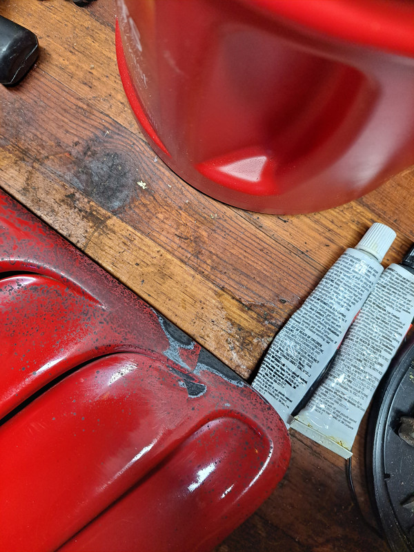

rich_e777 Posted January 2, 2024 Report Posted January 2, 2024 (edited) I found one of the hood vents on the rescued TGP was broken in a few places and decided to attempt a repair rather than scour up some. Using the Bondo flexible bumper repair kit found at any auto part stores or WalMart I was able to re attach the provisions for the bolts and where it had been cracked all the way through. Now I`m ready for paint but I went to prime it and the can went bad. I found a few small knicks in it after that I went ahead and filled so maybe a good thing. Before I get into repainting should I strip off the existing clear coat and paint on the good areas or just scuff it up with sandpaper? Or rather how would you guys that know what you`re doing fix a damaged hood vent? Edited January 2, 2024 by rich_e777 jiggity76 and Mach 5 2 Quote
rich_e777 Posted February 27, 2024 Author Report Posted February 27, 2024 Turned out as a high B+ job, there is still a small spot only someone anal would notice. Rattle can Dupli-color matched up pretty good over several coats of a new to me primer and filler. Here's a comparison pic after the paint dried but before the clear coat pwmin, Mach 5, GnatGoSplat and 1 other 4 Quote
rich_e777 Posted March 6, 2024 Author Report Posted March 6, 2024 Do not use the flexible bumper repair stuff, it doesnt hold at all. As soon as I screwed the vent back down it all seperated and I could peel the urethane off clean. So now I`m going to strip it and try again, might do the other just to be sure they match. I used Gorilla glue gel to re-attach the unobtanium and ran a mounting screw down the glued on provision and it all held very nice. Let it cure for 24 hours. 94 olds vert 1 Quote
55trucker Posted March 6, 2024 Report Posted March 6, 2024 33 minutes ago, rich_e777 said: Do not use the flexible bumper repair stuff, it doesnt hold at all. As soon as I screwed the vent back down it all seperated and I could peel the urethane off clean. So now I`m going to strip it and try again, might do the other just to be sure they match. I used Gorilla glue gel to re-attach the unobtanium and ran a mounting screw down the glued on provision and it all held very nice. Let it cure for 24 hours. My personal choice for cracked urethane plastic repairs or the like is Norton's Speedgrip Structural urethane adhesive, it's on the expensive side but it works well. rich_e777 1 Quote

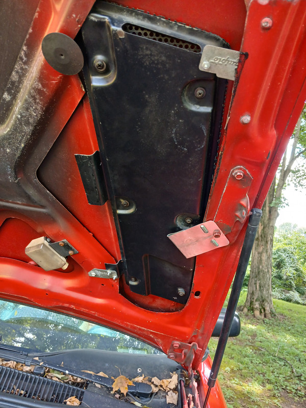

rich_e777 Posted October 20, 2024 Author Report Posted October 20, 2024 (edited) Spending some more time on this project and Ive noticed something. Are the 6 screws holding the pan/screen to the plastic vent the points of support? If so has anyone come up with a way to support the 3 parts to the vent to take the stress of those plastic screw tabs? Ive got an idea to run some hanger strap from one bolt of the hood support bracket to the opposite side (in theory) would press up against the pans yet hide above the insulation pad. Another option I thought of would be to drill out those tabs all the way through and use 6 long decorative bolts to hold it all in place. I`m working on getting some pics up, new phone, new number, lots of resetting passwords. F google. Edited October 20, 2024 by rich_e777 94 olds vert 1 Quote
94 olds vert Posted October 20, 2024 Report Posted October 20, 2024 1 hour ago, rich_e777 said: Spending some more time on this project and Ive noticed something. Are the 6 screws holding the pan/screen to the plastic vent the points of support? If so has anyone come up with a way to support the 3 parts to the vent to take the stress of those plastic screw tabs? Ive got an idea to run some hanger strap from one bolt of the hood support bracket to the opposite side (in theory) would press up against the pans yet hide above the insulation pad. Another option I thought of would be to drill out those tabs all the way through and use 6 long decorative bolts to hold it all in place. I`m working on getting some pics up, new phone, new number, lots of resetting passwords. F google. That's an interesting idea, but I'm not sure how it would look with it being bolted down from the top if I under stand you correctly. From what I recall, there are only 6 screws that secure the vent to the pan/screen that's mounted under the hood. When I had my long louvers repaired at a corvette body shop for my 91, they repaired several of those tabs for the screws with fiberglass and just drilled and tapped. Quote

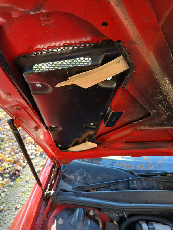

rich_e777 Posted October 20, 2024 Author Report Posted October 20, 2024 Do you recall if you could secure the pan to the hood with the screen without the plastic vent? Thats the general idea I`m shooting for, then the plastic can attach to something stable rather that be a contributing factor. It seems too brittle to be at either end of a clamping force and better off in between if that makes any sense. Quote
rich_e777 Posted November 17, 2024 Author Report Posted November 17, 2024 The strap idea could work if it were more rigid or if I could drill my own holes through it. Its too thin and I`m limited to hand tools when it comes to working metal for anything substantially thicker. I`m also thinking about a few pieces of rubber hose split on one side might work to wedge the pan in place like the shims in some of these pics. Here is what I`m working with if anyone has some ideas to bounce around. This is how the pan sat in the hood sort of wedged in with some old stiff weatherstripping material. I dont know if this is how these looked when new as the holes cut are really jagged like a body shop made them in a pinch. Temporary shims in place to get the right position. Led me to think some thick rubber hose split on one side might be used instead to really wedge in there to hold the pan securely to the hood to reduce stress on the plastic tabs on the vent itself. Quote

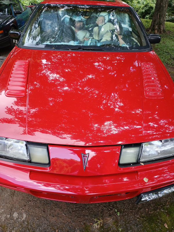

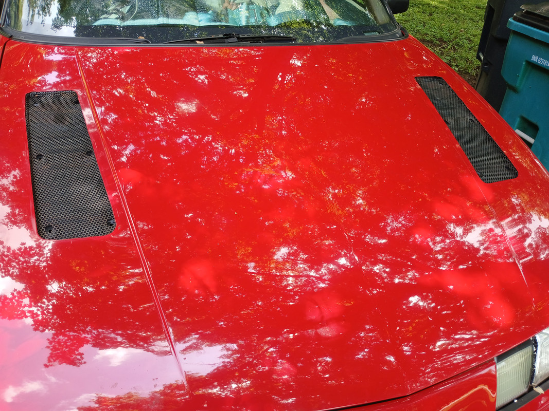

rich_e777 Posted July 22, 2025 Author Report Posted July 22, 2025 (edited) All that work and I ended up dropping and breaking that vent awhile back. Thanks to an extremely generous member here I have a replacement vent. I keep the pair inside packed in a box so I can`t break them without effort. Had an idea and went with it in securing the drip pans and screens. Using some things I had on hand I came up with some brackets that can be removed easily for cleaning or paint. I don't know if it helped or not, but I also used a small wire brush to clean out the posts and put a few drops of silicone lube in them before barely snugging up the mounting screws. Everything holds tight and secure when the hood is open and closed and looks good from the top, underneath maybe different but each side is mirrored to the other to the 1/16" with the exact same parts. It could look better with fabbed up metal stock instead, but the idea works and can be covered with some insulation in the future. It really doesnt look half bad with just the screens and pans, and Ive not even painted those yet. Seems like it could match the front grilles... Edited July 22, 2025 by rich_e777 primergray, 94 olds vert, pwmin and 1 other 4 Quote

jiggity76 Posted July 23, 2025 Report Posted July 23, 2025 23 hours ago, rich_e777 said: All that work and I ended up dropping and breaking that vent awhile back. Thanks to an extremely generous member here I have a replacement vent. I keep the pair inside packed in a box so I can`t break them without effort. Had an idea and went with it in securing the drip pans and screens. Using some things I had on hand I came up with some brackets that can be removed easily for cleaning or paint. I don't know if it helped or not, but I also used a small wire brush to clean out the posts and put a few drops of silicone lube in them before barely snugging up the mounting screws. Everything holds tight and secure when the hood is open and closed and looks good from the top, underneath maybe different but each side is mirrored to the other to the 1/16" with the exact same parts. It could look better with fabbed up metal stock instead, but the idea works and can be covered with some insulation in the future. It really doesnt look half bad with just the screens and pans, and Ive not even painted those yet. Seems like it could match the front grilles... By the way, the paint looks really excellent. rich_e777 1 Quote
rich_e777 Posted July 24, 2025 Author Report Posted July 24, 2025 I appreciate it, it's a dupli-color can special too. One day I would love to be able to 3d print these or mill them from an aluminum block. pwmin and jiggity76 2 Quote
