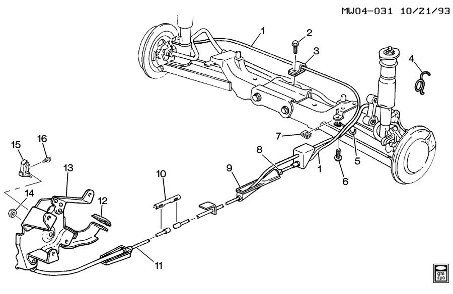

Regal Posted October 23, 2022 Report Posted October 23, 2022 I've been putting off doing a job where I need to remove the rear calipers for a while, since I'm not sure they're going to go back on. I have been considering replacing them with '94+ rear calipers though I've been told the parking brake setup won't be compatible. What I want to know is if there is any possible modification that can be made to make the parking brake work on '94+ rear calipers in a '93 and earlier car? Currently the parking brake is not even hooked up and needs new cables I guess but ideally I want it to work. Quote
pwmin Posted October 23, 2022 Report Posted October 23, 2022 I was able to make them work on my 91, but I don't remember exactly how I did it. I think it involved swapping the e brake pedal, some cables and some modifications to the brackets on the calipers. Regal 1 Quote

White93z34 Posted October 24, 2022 Report Posted October 24, 2022 I did the 94 swap on my cars 100% for the sake of reliability, nothing else. the rear cables are different, but the front one still works as does the pedal the rub is there is a bracket spot welded to the rear frame rail, drivers side that needs to be drilled out and swapped with one from a donor car. I wanna say I just used self tapping sheet metal screws to put the new bracket on my car, not ideal and one of these days I should go back and weld it on now that I have the ability but its been holding up fine since I did the swap in 2008 or 2009 Regal and 92Lumi 2 Quote

GTP091 Posted October 30, 2022 Report Posted October 30, 2022 (edited) I did this swap myself and am very happy with it. The 91-93 sliders are a horrid design. Even with the later aluminum slider they seize up. I got my donor parts off a 96 regal and rebuilt the callipers and powder coated them. I bought new rear cables for a 96 as well and used a female threaded coupler to tie the equalizer and right rear cable together. I can’t remember exactly but part #9 was different between the years. To make it work I cut the threaded rod coming out of part #9 in the photo and screwed the coupler onto it and then screwed the right rear cable rod into the other end of the coupler. The coupler is right at the #8 spot in the photo. Works great. You’ll need to replace the callipers, rotors, calliper brackets, get new rear park brake cables, left and right from a 94-96. very easy swap. Edited October 31, 2022 by GTP091 92Lumi 1 Quote
