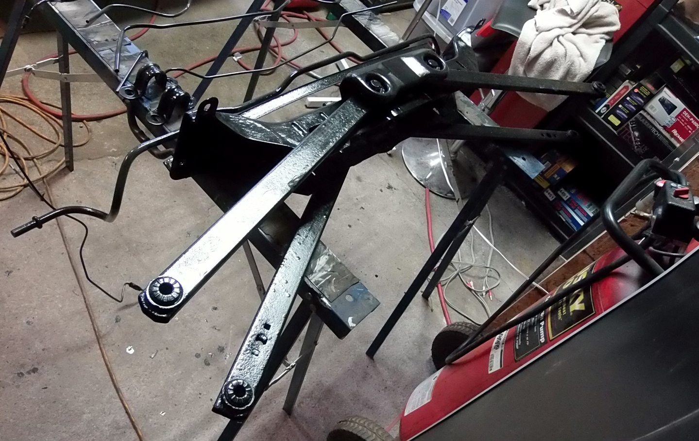

GTP091 Posted January 5, 2022 Author Report Posted January 5, 2022 I pulled the trigger on the Gen2 lateral arms yesterday. Still have not found a suitable subframe to restore. Even though my car is parked for the winter now I don’t want to use my existing subframe if I can help it so going to hold out for a JY pull, it’s been difficult though as the w’s are so rare these days. Theres a cutlass supreme at the local PnP so might go check it out. I have found a new old stock unit in the US but the landed price will be around $600 for me so can’t really justify spending 750 on this upgrade just to make things look a bit more pretty. When. It a l starts to come together I’ll post the progress so others can follow down the road. It’s not easy to piece these types of things together from a bunch of different 10 year old threads that have lots of questions and little follow through. thumbs up to Chris for having the most useful info. rich_e777 1 Quote

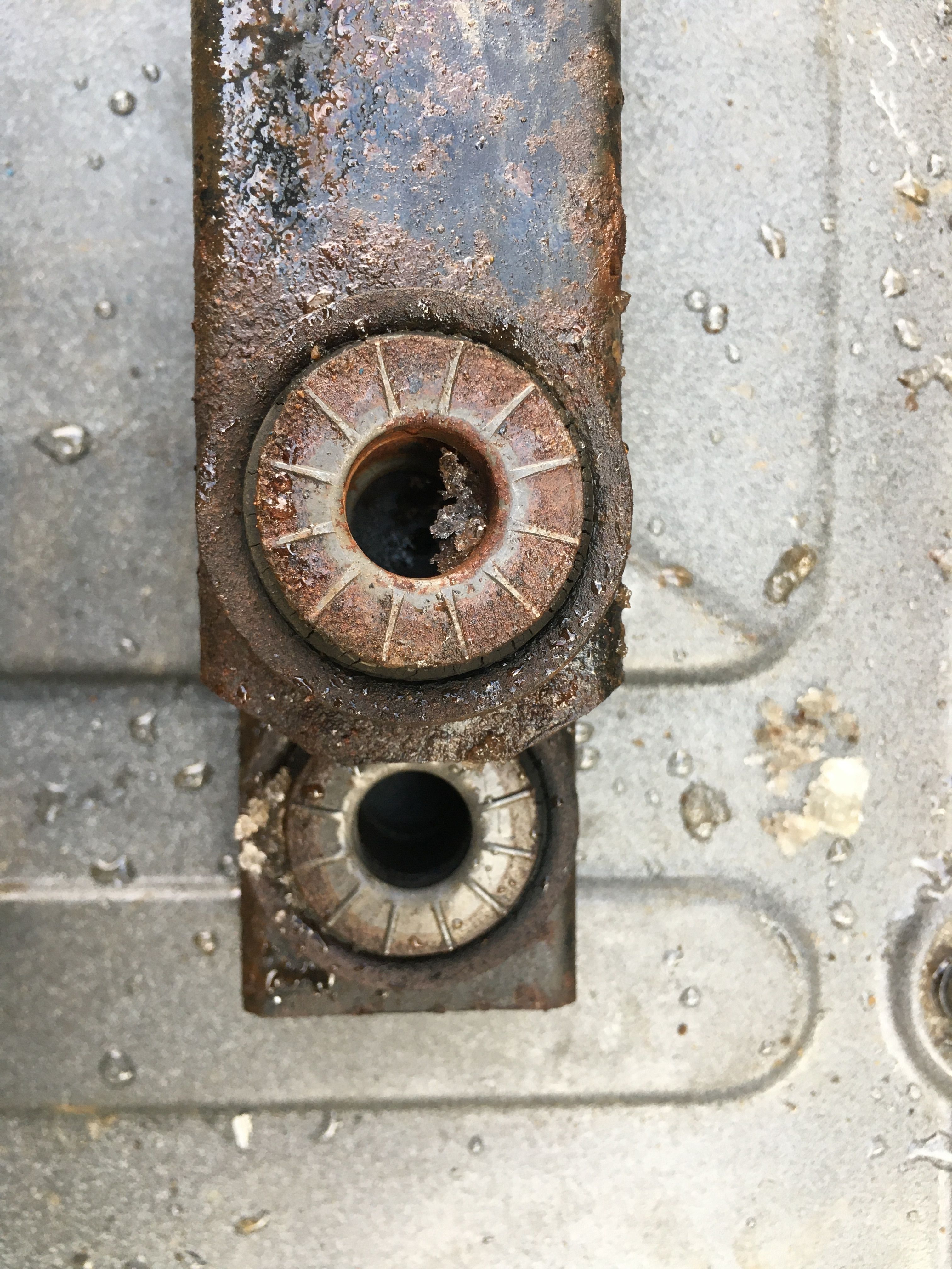

rich_e777 Posted January 6, 2022 Report Posted January 6, 2022 (edited) Oh man I`m sorry I missed this thread. I did a resto on mine, 95 CS Vert and went with some modded 2nd gen links. I used a long piece of steel pipe that went over a breaker bar to get the 4 mounting bolts loose, the longer the better and makes one hell of a noise. One thing I had to scrounge at the JY was some unique clips for the monoleaf. There are 2 bolts on either side that hold the monoleaf up that thread into insert clips that when rusted will break and just spin. That is how I ended up dropping the entire assembly so I could get to it. I couldnt find a PN number for these nor does the FSM really have any info other than a smudge on the exploded diagram. Edit: IIRC I had taken some pics but I think they may have been on a phone damaged long ago. Edited January 6, 2022 by rich_e777 Quote
