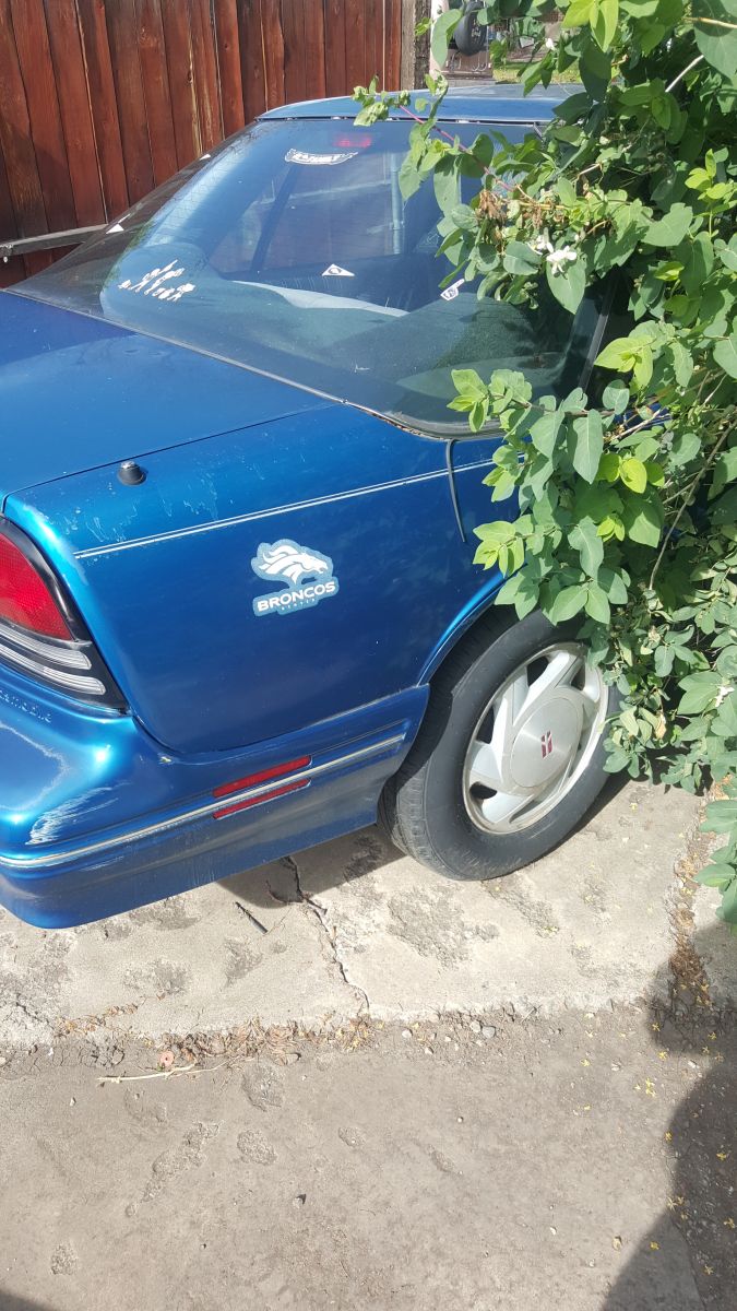

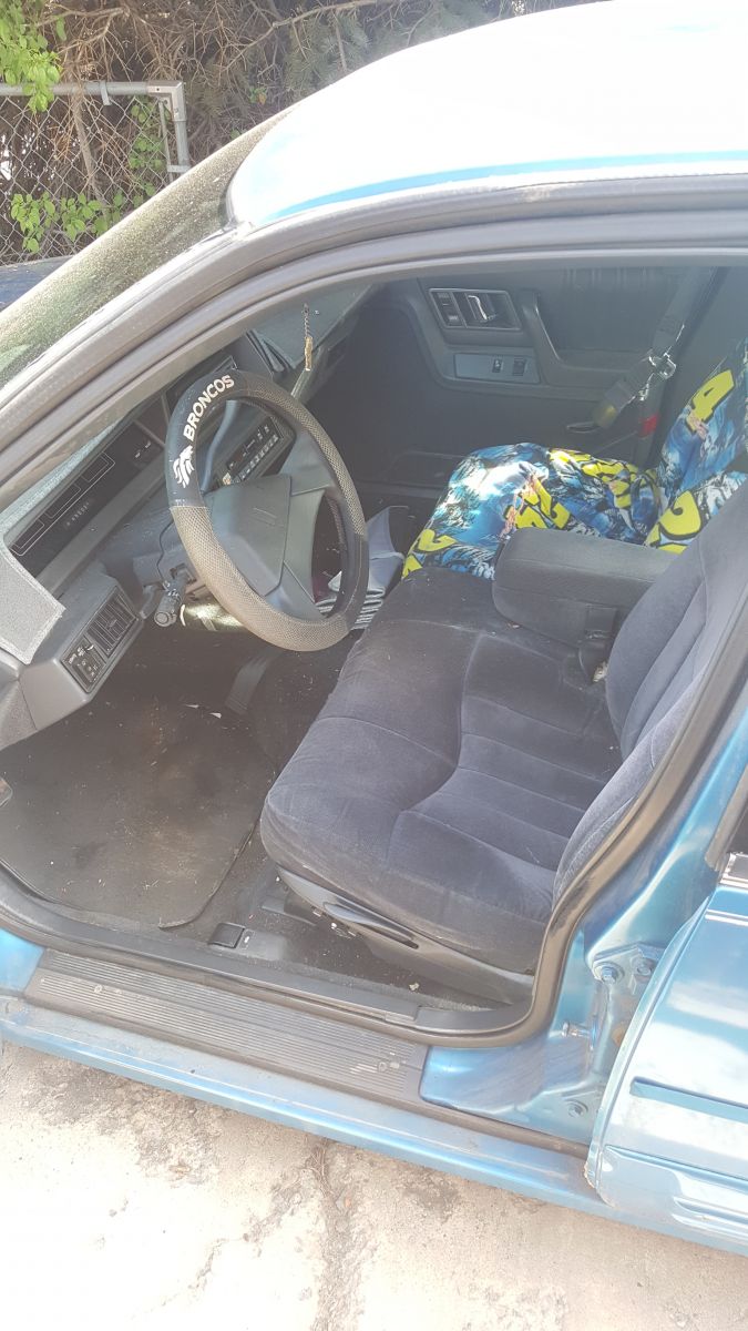

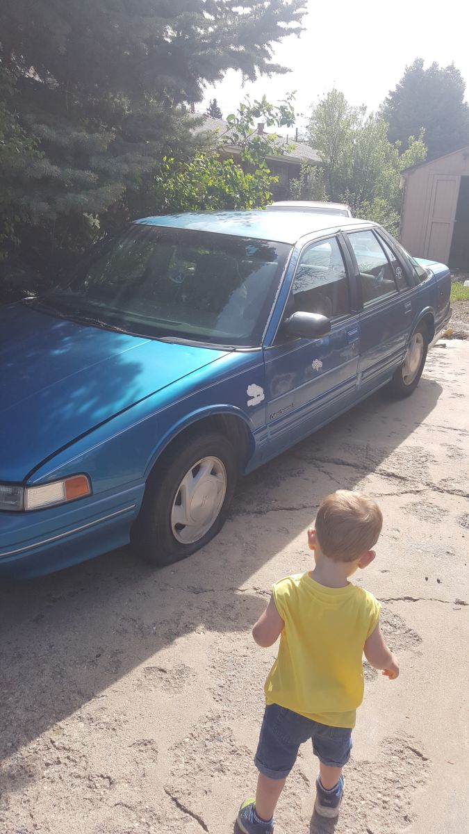

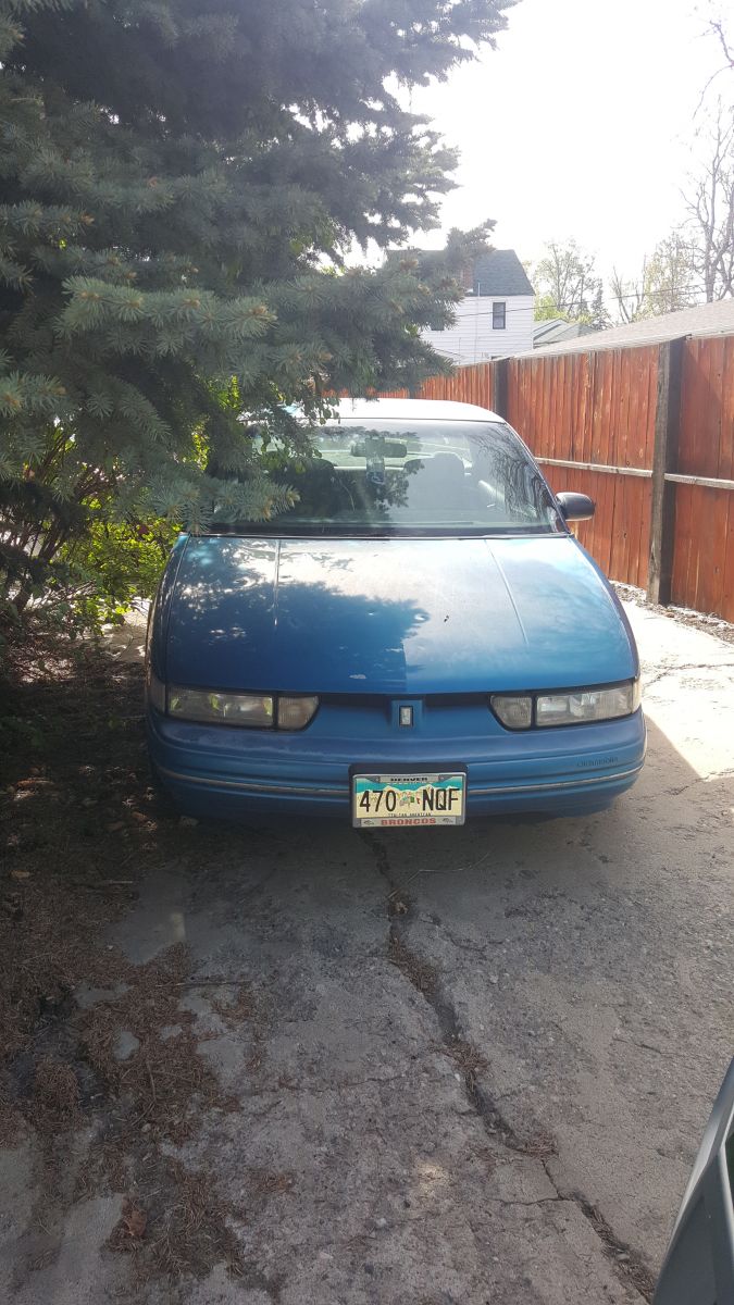

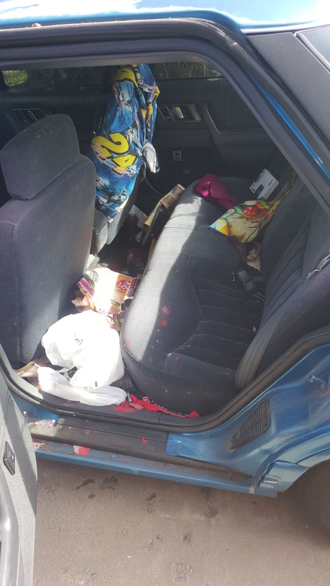

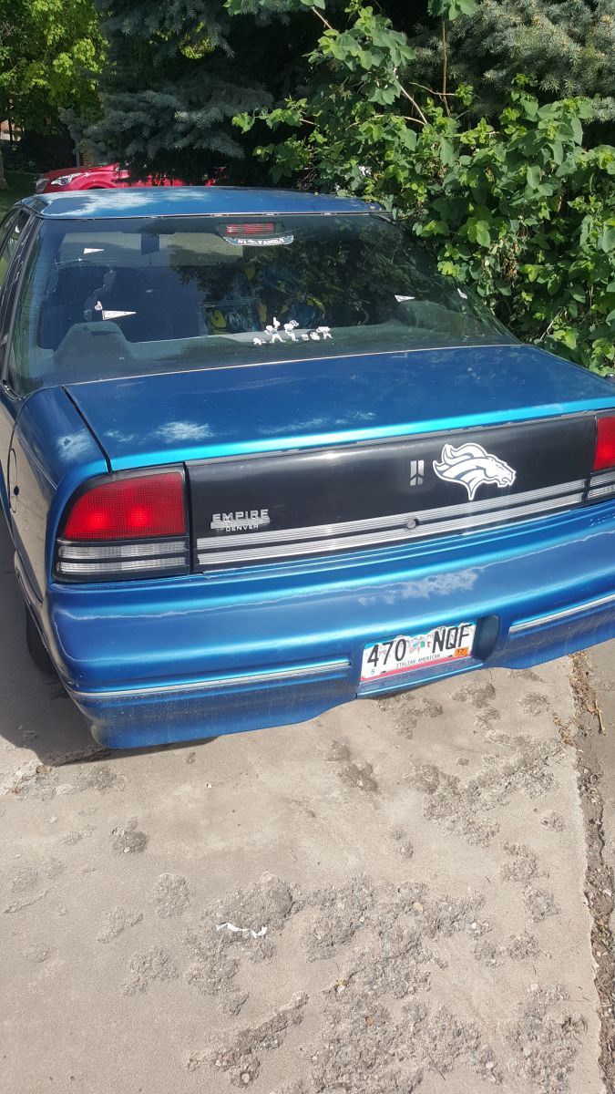

Pontiac6KSTEAWD Posted June 2, 2020 Report Posted June 2, 2020 So, as some of you may know... I bought a 1992 Olds Cutlass Supreme S from my Aunts Estate. I bought it cheap enough, I just want to make back what I put into it. I have no intentions of keeping the car, as my back cant take getting in and out of such a low car (5 blown discs). She has 103,911 actual miles on it presently. This is what it looked like when I picked it up from the driveway, where it hasnt moved in 4-5 years. (Thats my son in that next to last pic) I have since cleaned it up a lot, a full size trash can full of trash and other detritus. I replaced the battery new (35) Replaced the primary cooling fan motor new (30) I ripped out the single din kenwood 4x15w radio. It sounded like ass, and looked worse. I dropped in my radio from storage that I thought someone would have bought, but no one did LOL. So it now has a Pioneer Premier DEH-66DH 1.5 din 4x45w on stock speakers, and sounds so much better. My plan was to put in one of the Pontiac 5 band tape decks I have, but one read LOC on the screen, and I dont have the patience to get it unlocked (suggestions?). And the other worked just fine, but the antenna plug was screwed up, and would not receive any radio stations. (free) It had a 1/4 tank of 4-5 year old ethanol gas in it. I topped it off with straight no-ethanol gas. Engine idle smoothed out a lot, and she runs great. Took the front tires/rims off, and dropped them off at my local tire dealer to get some new tires (81) I sure do miss the sound a of 3.1 like I had in my old TGP and 6000. It still has a R12 AC system that is dead. So I need to get it converted over to R134a, will make a sale a lot easier. ($?) Plans at the moment are to get the tires put back on when they get in. Tire dealer didnt carry any tires of this size, and they are barely made any more. Already has new brake pads, brake calipers, front wheel bearings.I have not taken the back apart to see what it looks like. The parking brake is frozen. Not sure what I am going to be able to do there. So far I am not into it for as much as I was planning. I was planning on a dead car realisticly. Good for only junk. But after a lot of cranking, she fired. Dead and fried battery on jumper cables did not help. And then as soon as I would touch the brake pedal, or headlights, it would just shut off and die. Made it a pain since I had to have the car out by a certain time because of the Denver Curfew since DA rioters and protesters cant do it peacefully. Clear coat on the paint is almost non-existent and splotchy, with some 50 Denver Broncos stickers on it. Interior is near perfect. No tears in the seats, hardly any fading (surprisingly), power seat works great, digital dash works perfectly, ashtray has never been used, dashpad is near perfect (nearly because my cousin used thumbtacks to hold on a dash pad cover), Steering wheel is also near perfect (has had a broncos steering wheel cover on it for 25 years), power windows work perfect, spare tire and jack are present and never used. It had factory wheel locks, but those have all been removed, and replaced with standard wheel lugs. So its sitting in my garage, up on jack stands until the tires get in. I got to find out if any R12 is still in the system, and figure out what to do about that, and get it converted. Once thats done, I think she is going back on the market. With the miles and mechanical condition, I think I should be able to get 12-1500. The Cutlass is certainly taking more work than the Corsica I also bought. It just needs the Heater Core replaced, rear brakes adjusted (done), new battery (done), and a clean out (done) and vacuum. If it wasnt for my back, I would seriously consider keeping this one. The early 3100 Chevy Corsicas apparently were nearly indestructible, with many reports of them going to well over 300k with little to no work. It rides smooth as better, great power, and shifts well. Replacing that heater core is going to be a bitch thou. jiggity76, rich_e777 and digitaloutsider 3 Quote
