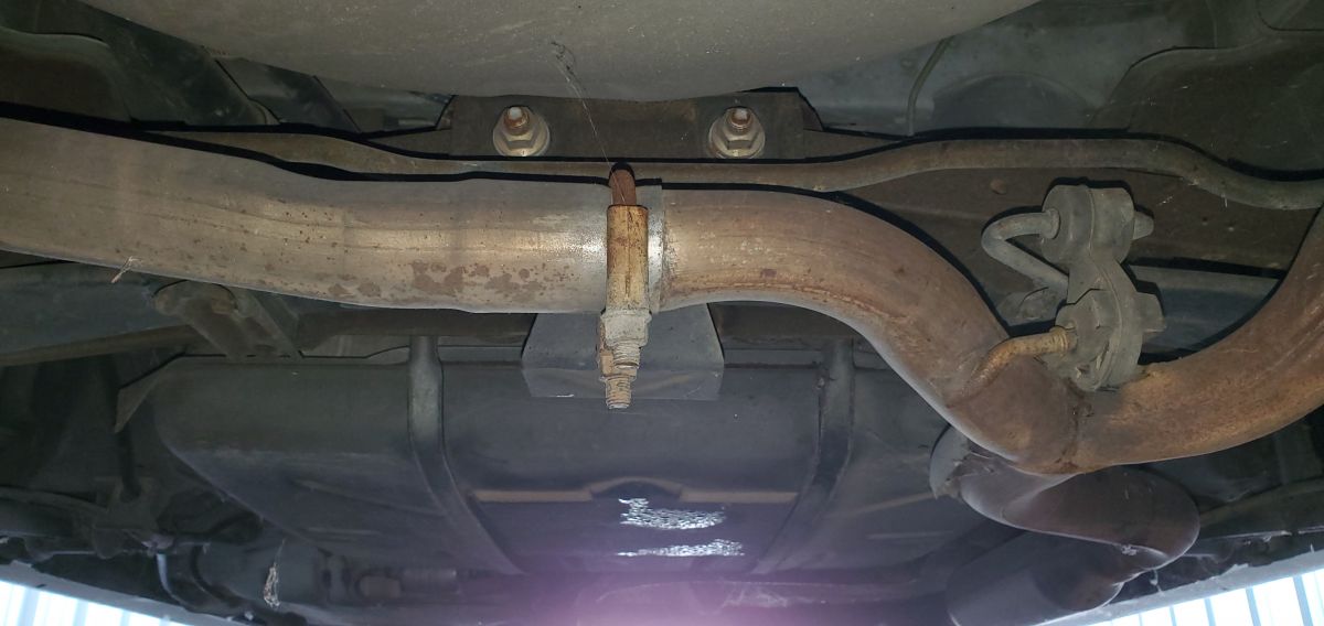

jiggity76 Posted May 31, 2020 Report Posted May 31, 2020 (edited) Absolutely! There is a metal jack plate at the very center of the rear axle, engine side of the exhaust pipe. The stands will go in front of the rear wheels at the pinch weld where the box section reinforces the trailing arm mounts. If you have rubber pads for your stands, that would be ideal. Here's the setup on my coupe. Edited May 31, 2020 by jiggity76 Quote
jiggity76 Posted May 31, 2020 Report Posted May 31, 2020 (edited) You can see the flat metal plate in this pic on the front side of the exhaust. That's your jack point, one of them anyways. I put my floor jack right on it. You can also use the afformentioned pinch weld points to jack the car up but I prefer this spot personally. Edited May 31, 2020 by jiggity76 Quote

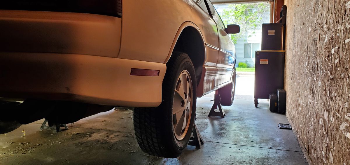

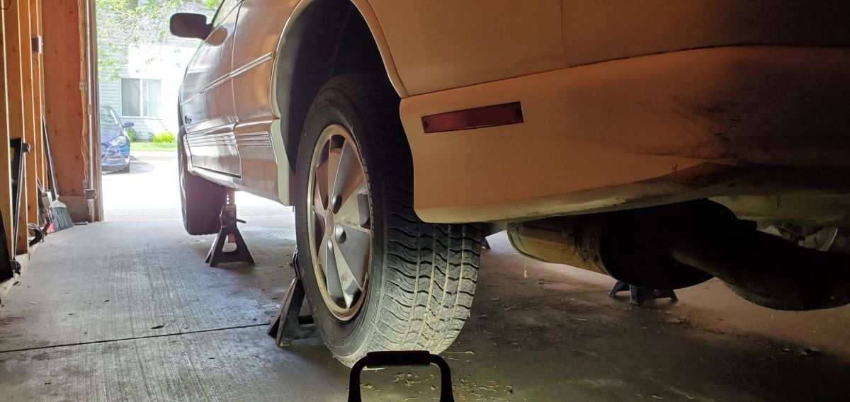

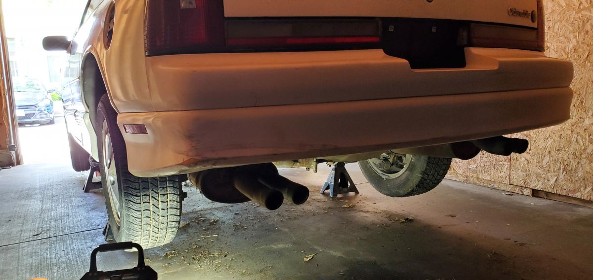

pbender Posted June 29, 2020 Author Report Posted June 29, 2020 (edited) Just to close this out.. all 4 corners are now on jack stands. I have the car just high enough the wheels barely touch the ground. This is enough I can get the tires off to work on the brakes, especially the rear ones, which was the goal for now. To do this, I had to move quite a few things around the car. I was able to give myself enough room to crawl my fat self between the car and the workbench behind it up to my shoulders, and from there I could see well enough to get the jack on the jacking point. Edited June 29, 2020 by pbender jiggity76 1 Quote
