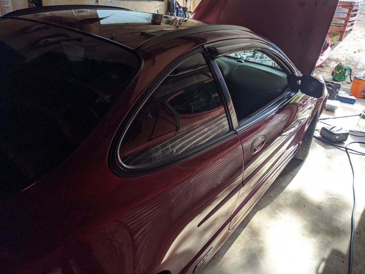

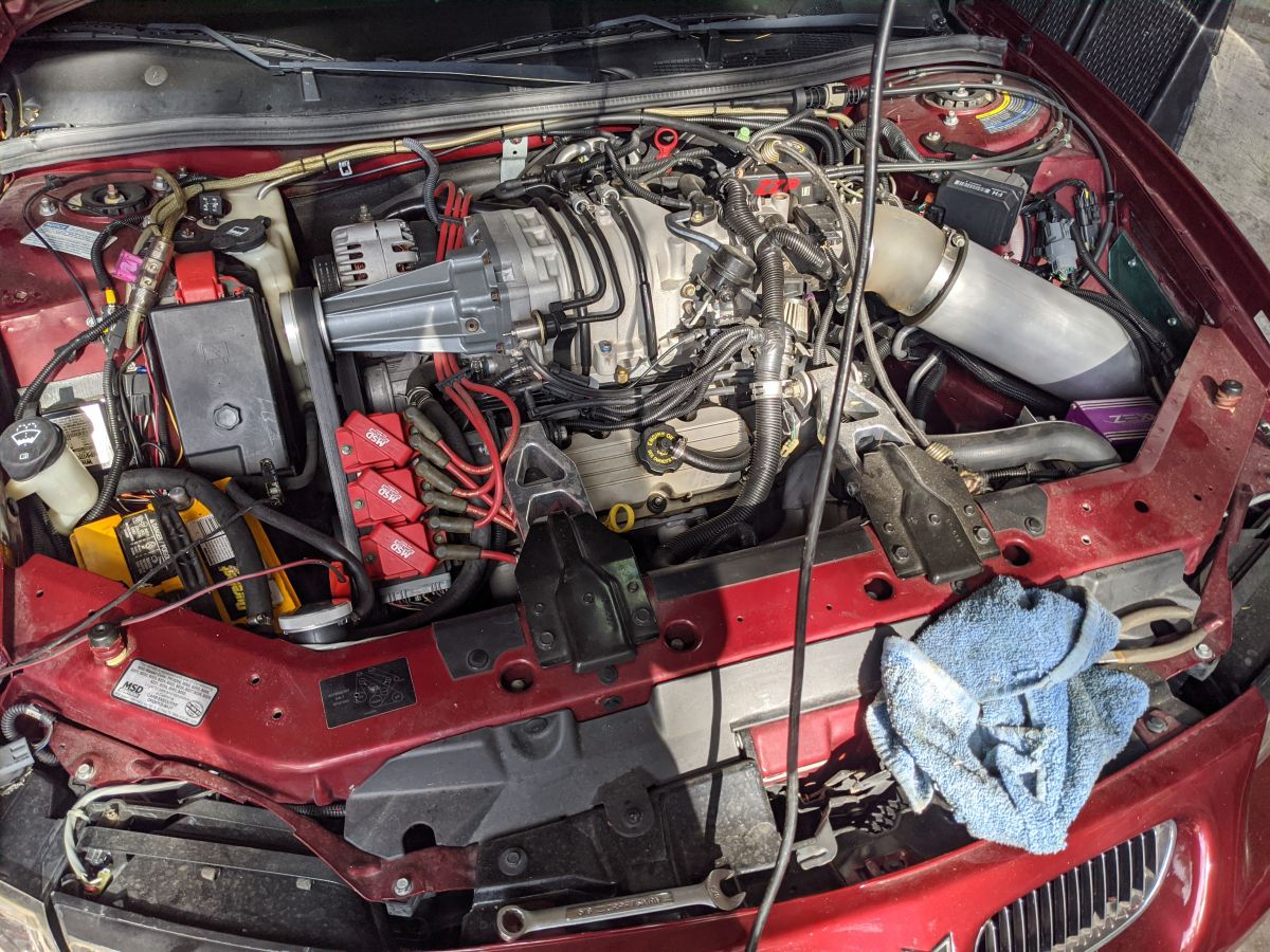

pwmin Posted July 18, 2020 Author Report Posted July 18, 2020 (edited) Well, we got it running again and got all the old fuel out! Edited July 18, 2020 by pwmin digitaloutsider and rich_e777 2 Quote
