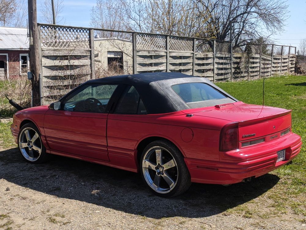

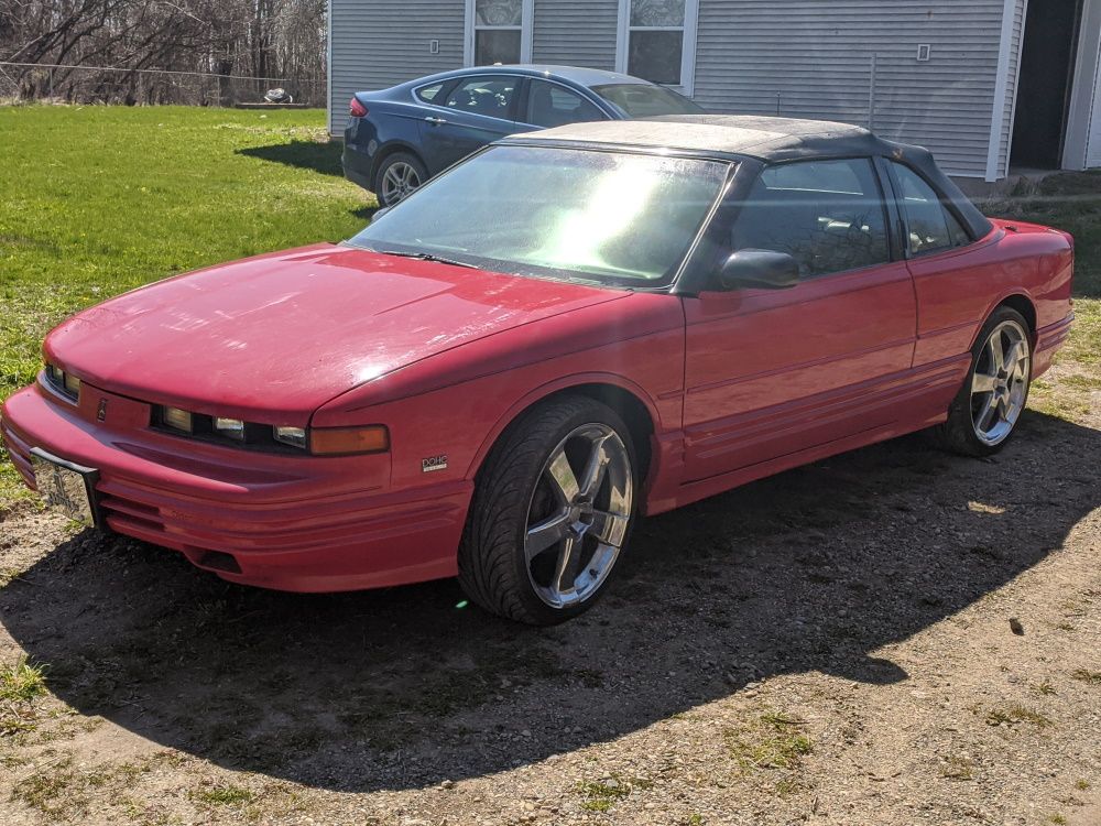

theghoul Posted April 27, 2020 Report Posted April 27, 2020 Hey guys! Its been ages and I'm happy to see that the site is still around. I remember doing meetups back at Kensington Park in Michigan, and having a great time with some of you. After 2 years of the car sitting in my barn, I pulled out my 95 vert for some sun. Stupidly I've been only starting and running it every six months. The mice invaded over the winter and it's been an ordeal cleaning it up after they moved out. This virus shutdown finally gave me some time to spend with it. I'm smelling the mouse pee in there. I think I got most of the nests (lil bastards). Any tips would be appreciated. I've been told to use baking soda, carpet cleaner and vinegar. I may try them all lol. Now I have a list to problems to deal with, but I'm going to fix each one. It ran for a while then stopped. Now I cant get it to run. Fuse and fuel is ok. Mouse pee (see above) Brake line rot. Who needs to stop anyways lol. Thank goodness for the parking brake. Tires are shot. They had less than 4000 miles on them too . Gonna yank em off and take them to the tire shop for replacement Climate control fan is making a lot of noise. Maybe there's a nest in there I need to get out. It did clean up nice though. Even with a cover on it, the barn swallows had a field day. digitaloutsider, oldmangrimes, negativeMatt and 1 other 4 Quote
oldmangrimes Posted April 27, 2020 Report Posted April 27, 2020 Check the air intake in the engine, that's where mice have made nests in my red '95 vert. Your car does clean up nice! I like the wheels. What's the black thing above the fuel filler door? And how is your clear coat doing? Mine's starting to peel. Quote
theghoul Posted April 27, 2020 Author Report Posted April 27, 2020 2 hours ago, oldmangrimes said: Check the air intake in the engine, that's where mice have made nests in my red '95 vert. Your car does clean up nice! I like the wheels. What's the black thing above the fuel filler door? And how is your clear coat doing? Mine's starting to peel. Cool. I'm checking that next. Those are the antennae (antennas?) for the GPS and Sat radio. Quote
