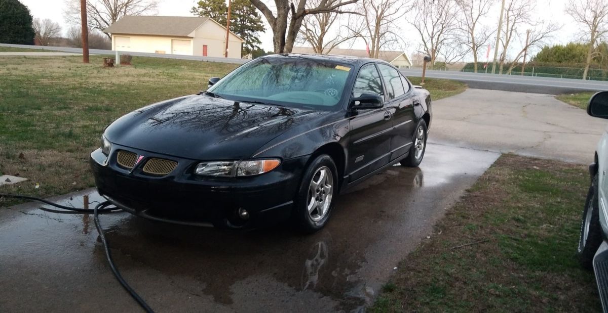

Jim_rockford_007 Posted January 20, 2020 Report Posted January 20, 2020 OK kiddies, like the title says, is it possible to use the entire front sub frame and suspension in to a 1.5 lumina? I measured the front upper strut mounting bolts and it looks like the pattern is the same. 92Lumi 1 Quote

Jim_rockford_007 Posted January 21, 2020 Author Report Posted January 21, 2020 Just looks like a beefier setup , other than the luminas have the dual piston calipers..Never mind about this question, Now that i have driven the gtp I was going to going to use parts off of and use the drivetrain for my swap into my lumina .. Im kinda falling for the old girl. Drive noce and i can tell the car was somewhet maintained most of its life. its kinda hard to scrap it . Quote

Jim_rockford_007 Posted January 25, 2020 Author Report Posted January 25, 2020 (edited) yep after running the rpo codes and realizing this car isnt anything other than a gadgets crammed into a base model grand prix, with FE1 suspention its very inferior to my F41 lumina . my lumina has dual piston front brakes and rear disc ,, and much stiffer springs and larger swaybars . Ill be putting the best parts of this car on to mine, the engine and trans..lol maybe the wheels, I have to get a shin spacer, the inside of the rims just barely rub on the outside of my front calipers. Edited January 25, 2020 by Jim_rockford_007 Quote
