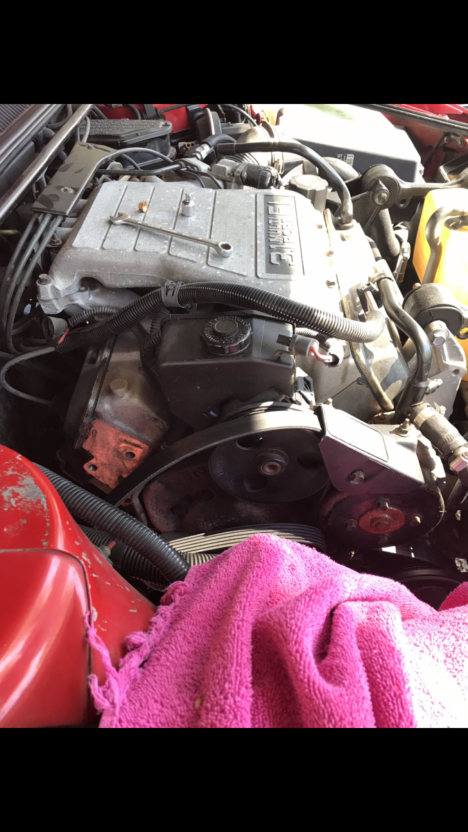

K&R Posted April 20, 2019 Report Posted April 20, 2019 I don’t know if anyone else has done this but thought I would share just in case. One way to change the plugs and wires on the 3.1 motor is to take just the alternator off and you have full access to the rear plugs. No rotating the engine as explained in the factory Manuel and no ratchet straps, which I’ve seen people do. jiggity76 1 Quote

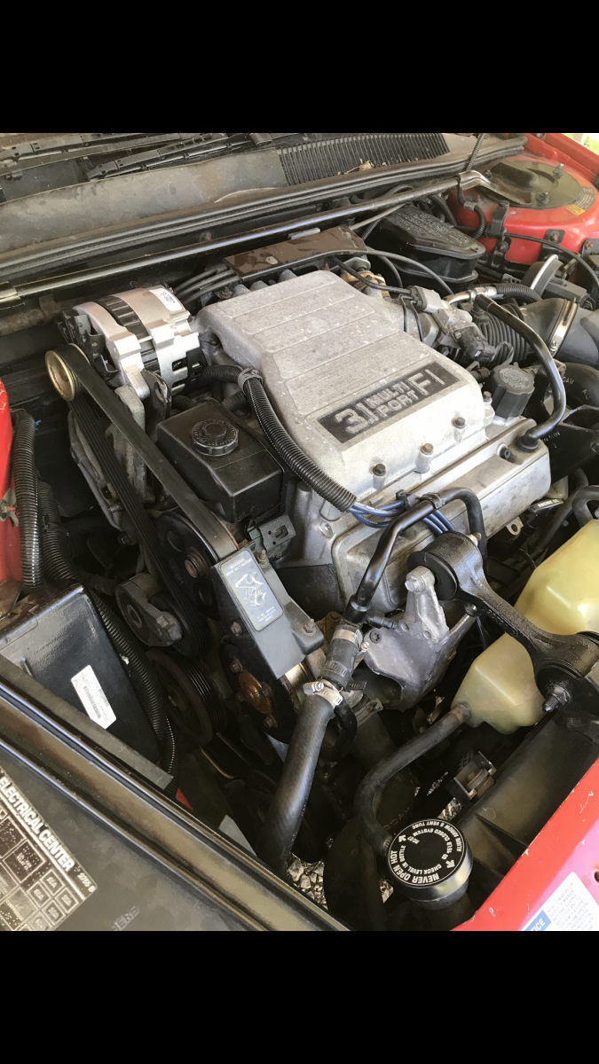

jiggity76 Posted April 21, 2019 Report Posted April 21, 2019 6 hours ago, K&R said: I don’t know if anyone else has done this but thought I would share just in case. One way to change the plugs and wires on the 3.1 motor is to take just the alternator off and you have full access to the rear plugs. No rotating the engine as explained in the factory Manuel and no ratchet straps, which I’ve seen people do. I believe the radiator cap is the original one. Not very common. I also believe they used the same cap on the LQ1's. At least for the 91 model years. Quote
digitaloutsider Posted April 21, 2019 Report Posted April 21, 2019 Yeah, they used it until at least '93. Most have failed over the years and have been tossed in the trash. The later W car radiator caps (PN 10409635) fit the old stuff, and while they're uglier, they tend to hold up better. jiggity76 1 Quote
jiggity76 Posted April 21, 2019 Report Posted April 21, 2019 (edited) 9 minutes ago, digitaloutsider said: Yeah, they used it until at least '93. Most have failed over the years and have been tossed in the trash. The later W car radiator caps (PN 10409635) fit the old stuff, and while they're uglier, they tend to hold up better. 10-4. I lucked out and took this one from the 89 International 3.1 parts car and put it on the 91 car. I found this NOS one and bought it for the 93 STE. I don't know if they are rare pieces but I always look for them in the yards. Looks like the STE has an aftermarket one. Yuck. Edited April 21, 2019 by jiggity76 digitaloutsider 1 Quote
K&R Posted April 21, 2019 Author Report Posted April 21, 2019 44 minutes ago, jiggity76 said: I believe the radiator cap is the original one. Not very common. I also believe they used the same cap on the LQ1's. At least for the 91 model years. Thats interesting. It was on there when I bought it. Lol Did they go bad often? jiggity76 1 Quote
jiggity76 Posted April 21, 2019 Report Posted April 21, 2019 Just now, K&R said: Thats interesting. It was on there when I bought it. Lol Did they go bad often? Not sure. Since your car is a low mileage one, maybe that's why it still retains it. My 89 International parts car is relatively a low mileage car too. I stole it for the 91 car. K&R 1 Quote

K&R Posted April 21, 2019 Author Report Posted April 21, 2019 6 hours ago, mfewtrail said: Slaving the engine forward is still quicker than that if you're easily able to do it. Removing the alt is a solid option as well though and doesn't take a whole lot more time when removed with the bracket attached. They still make tools to help you pull the engine forward by the way. Thexton offers one. I would assume you should be able to locate some of the ones other brands used to offer years ago as well, several places made them. The dogbone has a hole for holding the engine forward if you reinsert the bolt by the way, I assume your manual should cover that. The book does explain it that way step by step but being relatively new to the W club and project car hobby I figured l would mess that up ,no doubt. The alternator way, the farthest plug is a little tricky but not terrible to get to. Quote
