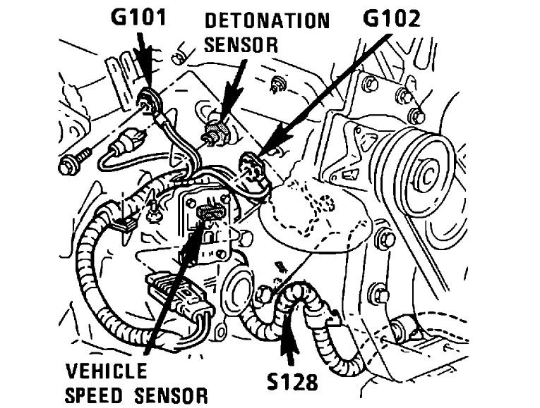

89-W-Body-Regal Posted January 14, 2019 Report Posted January 14, 2019 (edited) Can someone help me find the knock sensor location? I need a photo of where it’s at. From this photo I don’t know if it’s on the passenger side or drivers side. Everyone told me it’s in the back of the engine near the exhaust manifold in the engine and it’s an 89 Buick Regal Edited January 14, 2019 by 89-W-Body-Regal Quote
digitaloutsider Posted January 15, 2019 Report Posted January 15, 2019 They are correct. That's where it is. I imagine it's a huge bitch to get to with the auto trans in the way. Quote

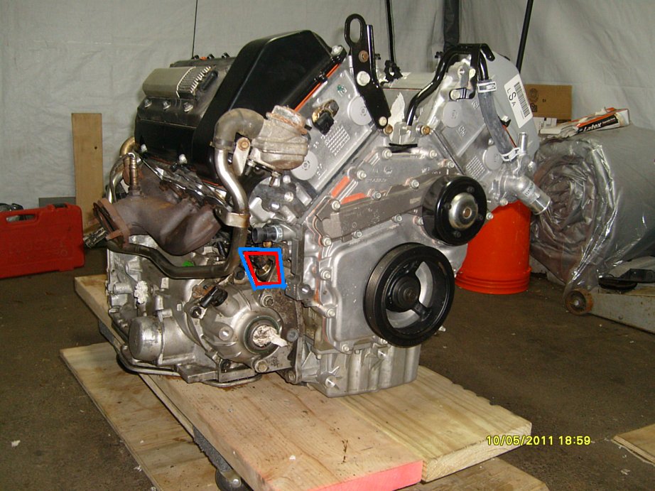

Cutlass350 Posted January 16, 2019 Report Posted January 16, 2019 (edited) Fwiw, it's going to suck getting to the knock sensor. Remove the tire, remove the shield, and swear a lot! Imho, the last part is the most important. Also, you will need a special socket. Can it be removed without a special socket? Yes. You can also drain an Olympic-sized swimming pool using just a teaspoon. I've attached a picture of where it is on my LX5 engine. It's in a similar place on your engine. GM likes to try to keep sensors in the relative similar locations. Also, the picture below shows what the sensor looks like: Good Luck! Edited January 16, 2019 by Cutlass350 Quote
cheatah faheatah Posted January 16, 2019 Report Posted January 16, 2019 That's .... just ....EVIL ... 89-W-Body-Regal 1 Quote
Dark Ride Posted January 16, 2019 Report Posted January 16, 2019 So like...is there a reason it couldn't be on the front of the block? 89-W-Body-Regal 1 Quote
89-W-Body-Regal Posted January 17, 2019 Author Report Posted January 17, 2019 (edited) Holy shit no way I am going to be able to reach that without a lift. Don’t have one of my own. I guess I’ll have to take it somewhere. And I thought these engines were easy to work on. Smh fucking GM. Edited January 17, 2019 by 89-W-Body-Regal Quote
89-W-Body-Regal Posted January 17, 2019 Author Report Posted January 17, 2019 (edited) 19 hours ago, Cutlass350 said: Fwiw, it's going to suck getting to the knock sensor. Remove the tire, remove the shield, and swear a lot! Imho, the last part is the most important. Also, you will need a special socket. Can it be removed without a special socket? Yes. You can also drain an Olympic-sized swimming pool using just a teaspoon. I've attached a picture of where it is on my LX5 engine. It's in a similar place on your engine. GM likes to try to keep sensors in the relative similar locations. Also, the picture below shows what the sensor looks like: Good Luck! What’s that sensor above it? That’s what I touch when I put my hand back there. Edited January 17, 2019 by 89-W-Body-Regal Quote
ManicMechanic Posted January 17, 2019 Report Posted January 17, 2019 38 minutes ago, 89-W-Body-Regal said: What’s that sensor above it? That’s what I touch when I put my hand back there. Oil pressure switch. 89-W-Body-Regal 1 Quote
