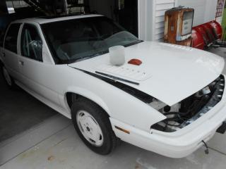

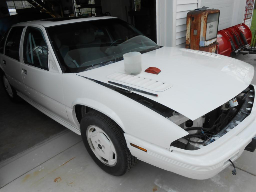

1 of 996 Posted July 12, 2018 Report Posted July 12, 2018 Anybody can modify a car. It takes perseverance to bring one back. Selenoyl, rich_e777 and jiggity76 3 Quote

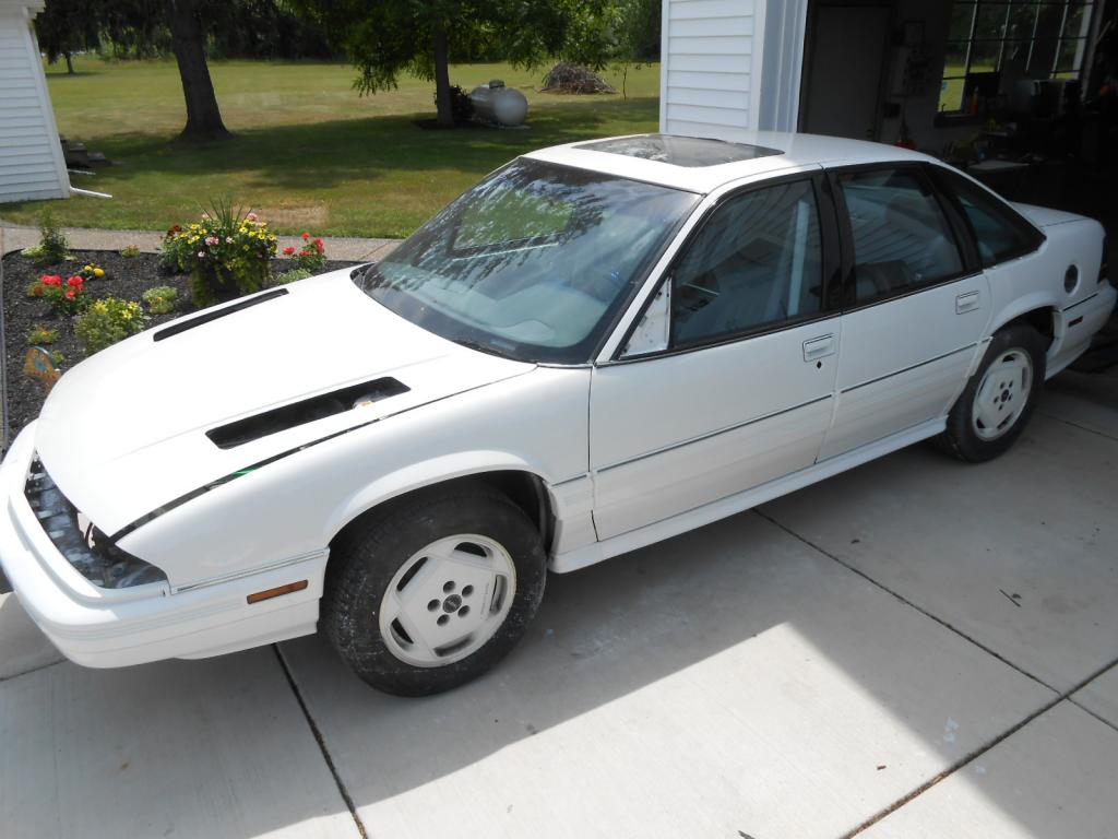

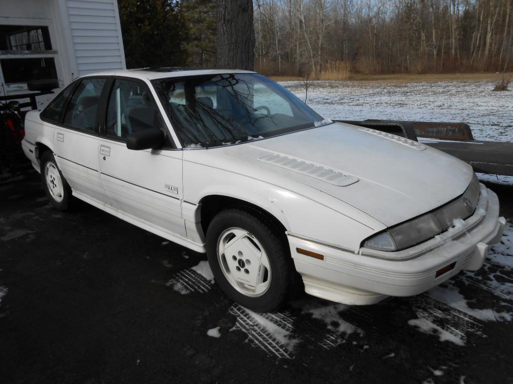

jiggity76 Posted July 12, 2018 Author Report Posted July 12, 2018 Anybody can modify a car. It takes perseverance to bring one back. Really superb! It's coming together so beautifully! How hard is it to remove the window and beltline trim? Did you see my STE? Selenoyl 1 Quote

1 of 996 Posted July 12, 2018 Report Posted July 12, 2018 Really superb! It's coming together so beautifully! How hard is it to remove the window and beltline trim? Did you see my STE? More time consuming than difficult. The biggest bitch is the rear door handles. GM must have started with those and built the car around it. jiggity76 and Selenoyl 2 Quote

jiggity76 Posted July 12, 2018 Author Report Posted July 12, 2018 More time consuming than difficult. The biggest bitch is the rear door handles. GM must have started with those and built the car around it. How did you remove them, is there a tool to use, bolted on or do they slip over the inner and outer panels with clips or something? I'm guessing they lock onto a channel? I'm curious because I need to do this to my STE someday and want to do it properly. Some of my beltline trim rubber is split and hanging off the car (the one below the rear quarter window glass). Quote
1 of 996 Posted July 12, 2018 Report Posted July 12, 2018 How did you remove them, is there a tool to use, bolted on or do they slip over the inner and outer panels with clips or something? I'm guessing they lock onto a channel? I'm curious because I need to do this to my STE someday and want to do it properly. Some of my beltline trim rubber is split and hanging off the car (the one below the rear quarter window glass). Mirrors first. Then the belt moulding gets pried off. That just grips onto the pinch weld with clips. After that, the glass run channel needs to be pulled out of the upper trim moulding to expose all the phillips screws. Remove all the screws around the upper trim moulding and pry it off. It will be stuck a bit due to a foam-rubber insulator. After all the perimeter trim is removed the wide black applique gets popped off. Rear doors are similar. Quote
jiggity76 Posted July 12, 2018 Author Report Posted July 12, 2018 Mirrors first. Then the belt moulding gets pried off. That just grips onto the pinch weld with clips. After that, the glass run channel needs to be pulled out of the upper trim moulding to expose all the phillips screws. Remove all the screws around the upper trim moulding and pry it off. It will be stuck a bit due to a foam-rubber insulator. After all the perimeter trim is removed the wide black applique gets popped off. Rear doors are similar. Thank you so much, I was really sweatin it about how to replace these pieces. I figured there are clips and screws somewhere but I don't want to damage anything that's reusable. The door cladding is held on with screws and clips too right? What about the chrome trim pieces that run along the front fenders and rear quarters? Looks like there is a screw mount hole for the front fenders at least, maybe the same for the rear quarter pieces. It's funny, these cars were probably put together on the assembly line really fast. Quote
