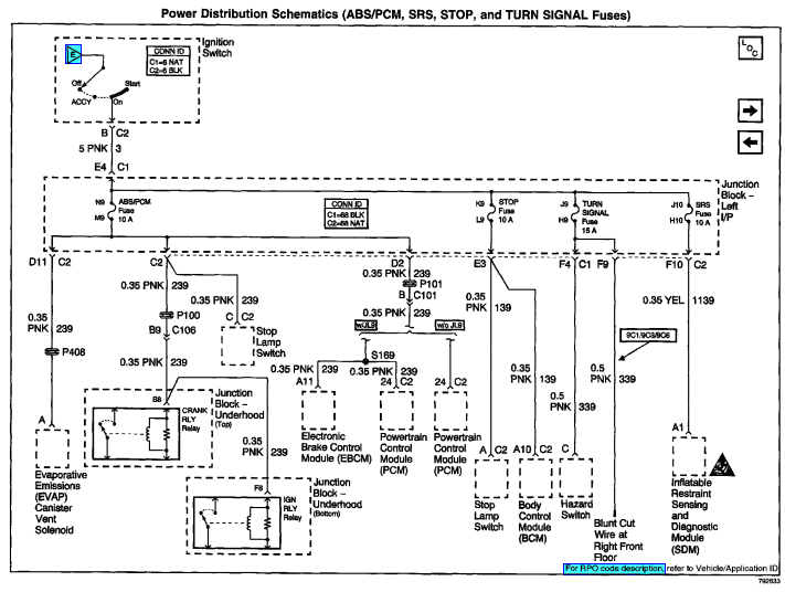

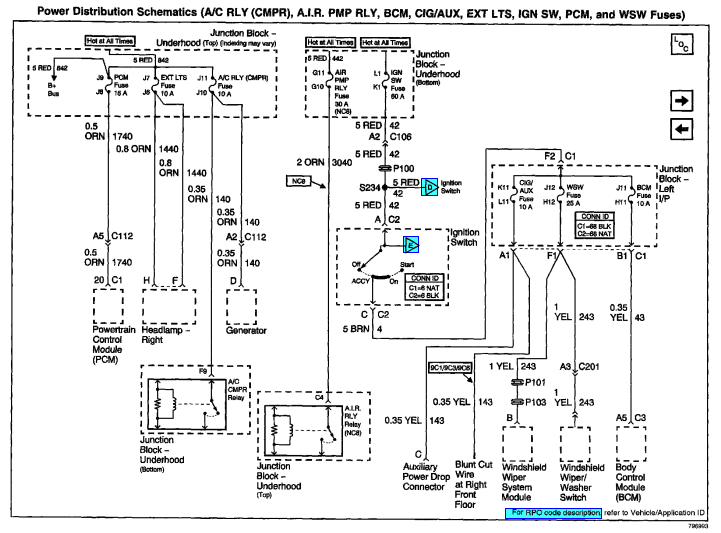

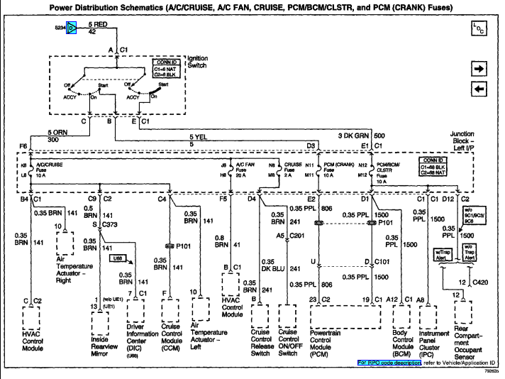

GreaseDog Posted May 28, 2018 Author Report Posted May 28, 2018 Want me to post prints tonight?That would be awesome. It appears they were trying to hotwire it, we got it with no keys, so rehooking the ignition cylinder is a no go. The people who trashed the car were borrowing it from the owner, and lost the keys. Sent from my SM-G950U using Tapatalk Quote
Imp558 Posted May 28, 2018 Report Posted May 28, 2018 That's a bummer, there's no connector end views. Quote
Psych0matt Posted May 28, 2018 Report Posted May 28, 2018 That's a bummer, there's no connector end views. you have to turn the paper sideways to look at the end, silly GreaseDog, ManicMechanic and Imp558 3 Quote
GreaseDog Posted May 28, 2018 Author Report Posted May 28, 2018 Just ignition?Looks like that's all they hacked. Is passlock going to cause me issues? Sent from my SM-G950U using Tapatalk Quote
Imp558 Posted May 28, 2018 Report Posted May 28, 2018 Only if you want it to run, starting won't be a problem if you bypass the start relay but it will pull FI pulses after a few seconds without passkey. In theory you could plug your other car's ignition switch into it and do a 30 minute re-learn if you don't have a key. Quote
