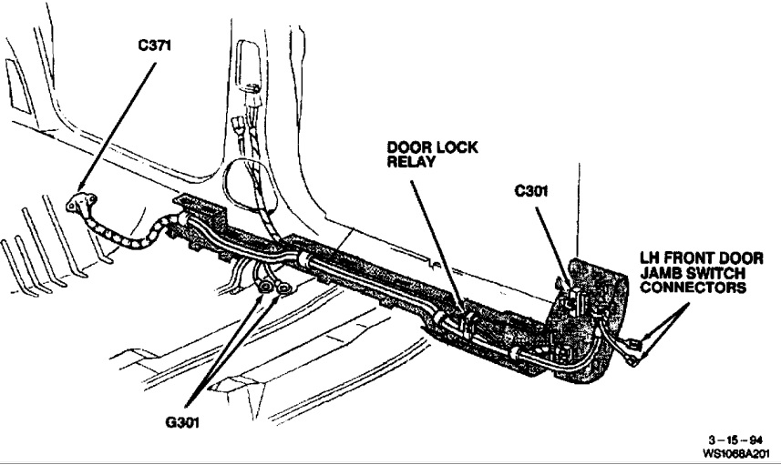

95GS Posted April 30, 2018 Report Posted April 30, 2018 Where will I find the relay for the power door locks, and how would I test it? Can these be purchased new? (My1995 4-door Regal) Quote
vipmiller803 Posted April 30, 2018 Report Posted April 30, 2018 If it's like my 2 door, the relay lives in the driver rocker area. You get to it by removing the bottom door surround trim from the floor and lifting the carpet. If I remember correctly, the relay is a dpdt and runs the actuators in both directions. I find it best to open up non-sealed relays like these to get a good look at the contacts. Continuity tests on something so mechanical can be unreliable. Quote
95GS Posted May 1, 2018 Author Report Posted May 1, 2018 Thank you both! Seems like a questionable place for an unsealed electrical component. Of course, GM may not have planned for a 20+ year life-span... VIP, what does dpdt mean? Are these relays available today? (Or if a contact problem, possibly repaired?) Quote
Imp558 Posted May 1, 2018 Report Posted May 1, 2018 It's an odd part to have fail. Likely wouldn't have a problem with one from a wrecking yard. DPTD is double polo double throw, essentially two sets of contacts with a normally open and a normally closed per set. It may be available today but a used one in good shape wouldn't be a bad bet. Quote

vipmiller803 Posted May 1, 2018 Report Posted May 1, 2018 Thank you both! Seems like a questionable place for an unsealed electrical component. Of course, GM may not have planned for a 20+ year life-span... VIP, what does dpdt mean? Are these relays available today? (Or if a contact problem, possibly repaired?) Like mentioned above, junkyards would be good sources. Mine got some salt water on it and I was able to open it up and fix the contacts as well as resolder some joints. Best bet would be to go with a used one though. They are not a common item to fail without provocation. 95GS 1 Quote
