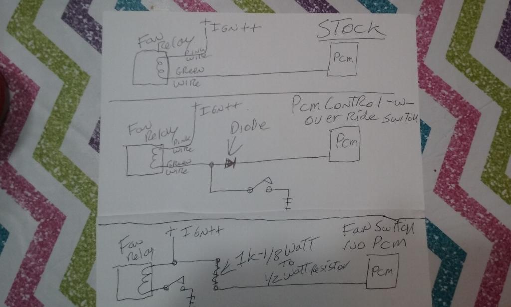

Imp558 Posted April 23, 2018 Report Posted April 23, 2018 I can post a simple drawing to enable the fan tonight without throwing codes. As for resetting the PCM, your cars are early passkey if any at all. Leaving the PCM unplugged for 10 minutes will clear any codes. Quote
