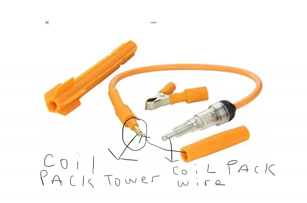

89-W-Body-Regal Posted April 22, 2018 Author Report Posted April 22, 2018 Bare with people I am a starting out mechanic saving money doing things the right way here. If I buy this spark tester and connect to coil pack would this work? Here’s a pic I labeled to explain it better if it can work. Quote
redgrandprix Posted April 23, 2018 Report Posted April 23, 2018 Bare with people I am a starting out mechanic saving money doing things the right way here. If I buy this spark tester and connect to coil pack would this work? Here’s a pic I labeled to explain it better if it can work.Just get one of these, unplug from the spark plug and clamp to a good ground like an intake bolt, adjust like half an inch or so. If the spark can make it that far it should be an alright spark under load. Sent from my SM-N900T using Tapatalk Quote
