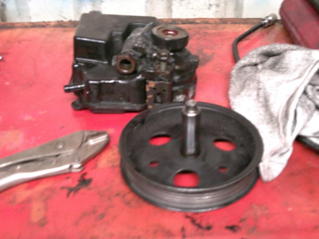

Imp558 Posted April 22, 2018 Report Posted April 22, 2018 Replaced this one today, it was the most broken PS pump I've ever seen. The shaft was broken and the pulley with half of a shaft fell out in my hand. It was easier to remove from the car in two pieces so that was cool. Had to rock the engine to get the replacement back in. Galaxie500XL and W30olds 2 Quote

55trucker Posted April 23, 2018 Report Posted April 23, 2018 Replaced this one today, it was the most broken PS pump I've ever seen. The shaft was broken and the pulley with half of a shaft fell out in my hand. It was easier to remove from the car in two pieces so that was cool. Had to rock the engine to get the replacement back in. AA.JPG That's not very happy looking...... Quote

Galaxie500XL Posted April 24, 2018 Report Posted April 24, 2018 Never seen one that bad...though I did actually have that pulley on the power steering pump on the Cutlass actually fracture..that center portion of the pulley is actually plastic on the LQ1, and I’d assume most everything else GM made around that time. Made a horrible noise. Quote
